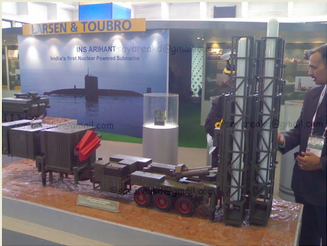

vasu raya wrote:
karan_mc wrote:Spotted Nirbhay Launcher , When is the Second test ?
This monster won't fit in the C-17 cargo hold, and they should do something about those huge boxes, even the foot print of a basic UAV like Nishant has 12 vehicles per wiki.
Yes, those equipment boxes show no sign of volume optimization. Also, I doubt the equipment is optimized for power consumption. In the event of a war, if the systems must remain online and ready to launch, I wonder how much time it would take to use up all the fuel for powering the generator that runs all that.
I hope this is only the first version of the Nirbhay launcher, with more work to be done on it. In contrast, the Tomahawk Ground Launched Cruise Missile (GLCM) launcher is perhaps just as long but appears to be both shorter in length and far more volume optimized. The launcher also carries 4 missiles instead of 3.

Re: Indian Missiles and Munitions Discussion
Depends on what is within those boxes. There appears to be a door on one of the indian missile TEL "boxes", if that is an operator cabin, then that implies that it has its own controls setup and can sustain a level of autonomous ops.

Interesting observations Pratikdas, Karan M et al., so eventually the trusses would be replaced by canisters. Even Shaurya was shown with a truss launch however the launcher at a exhibition showed a canister.
From this picture posted by Karan M,
When the launch tubes are moved to vertical position, the boxes seem to act as a counter weight (not a dead weight) in the absence of the tractor, why would they want the tractor to leave? is it because of Nirbhay's range its relatively safe unlike the Brahmos TEL
The IAF's Akash launcher was a similar tractor trailer with no boxes since the Akash doesn't need a counter weight.

^ Just curious where is it mentioned that tractor will leave during the time of the launch ?
Also I am not aware of Shourya launcher with a truss only structure , even during it;s first test firing it was cold launched from a silo surrounded by a truss cage.
https://www.google.co.in/search?q=shour ... B300%3B400
vasu raya wrote:Interesting observations Pratikdas, Karan M et al., so eventually the trusses would be replaced by canisters. Even Shaurya was shown with a truss launch however the launcher at a exhibition showed a canister.
I would presume a canister, because otherwise there is no way to protect the missile from the elements. On the other hand, Akash is carried openly and even goes through a heavy rain test whilst exposed on the TEL, but its an exception (IMHO) to the rule.
They dont want the tractor to leave ... that display piece by the L&T/TATA folks (whosoever's display that was) just shows the part they built which is to be integrated on the tractor.

In the above picture there is no tractor, it doesn't mean it will leave at the time of launch, it is not required to be around. This was around the time of Tatra issue maybe, domestic option was a tractor trailer, the connector from the tractor to the trailer is the fifth wheel which I believe takes downwards loads and not upwards which would happen with the tubes going vertical
my bad on the Shaurya, they should have had a truck launch video.

vasu raya wrote:In the above picture there is no tractor, it doesn't mean it will leave at the time of launch, it is not required to be around. This was around the time of Tatra issue maybe, domestic option was a tractor trailer, the connector from the tractor to the trailer is the fifth wheel which I believe takes downwards loads and not upwards which would happen with the tubes going vertical
There is no tractor because the people who own that display don't handle that part of the build. They are displaying what they do.
Nobody is going to unhitch the missile system from the truck when the entire point of the truck is that it adds the crucial survivability factor, ie mobility.

Akash mk2 might be canistered and then with Pinaka wouldn't the exposed trusses show up on ISTAR craft a bit too easily? not to mention you may want export looks for it
mobility is great, the current gripe is about fitting the tractor-trailer in a C-17
We dont know the MK2 has canisters yet, do we?
Trusses or not, unless you cover the whole missile TEL with a RF cammo cloth, it will show up bigtime on radar.
Now even if you unhitch and fit into a C17, getting it out will be a pain.

Karan M wrote:Hmm... even Pinaka is an open design, so I guess DRDO is prepared for their systems to be weather proof.
http://1.bp.blogspot.com/_o_no4M2xEPY/S ... 707163.JPG
This launcher was designed by some private company. L&T or Godrej IIRC
