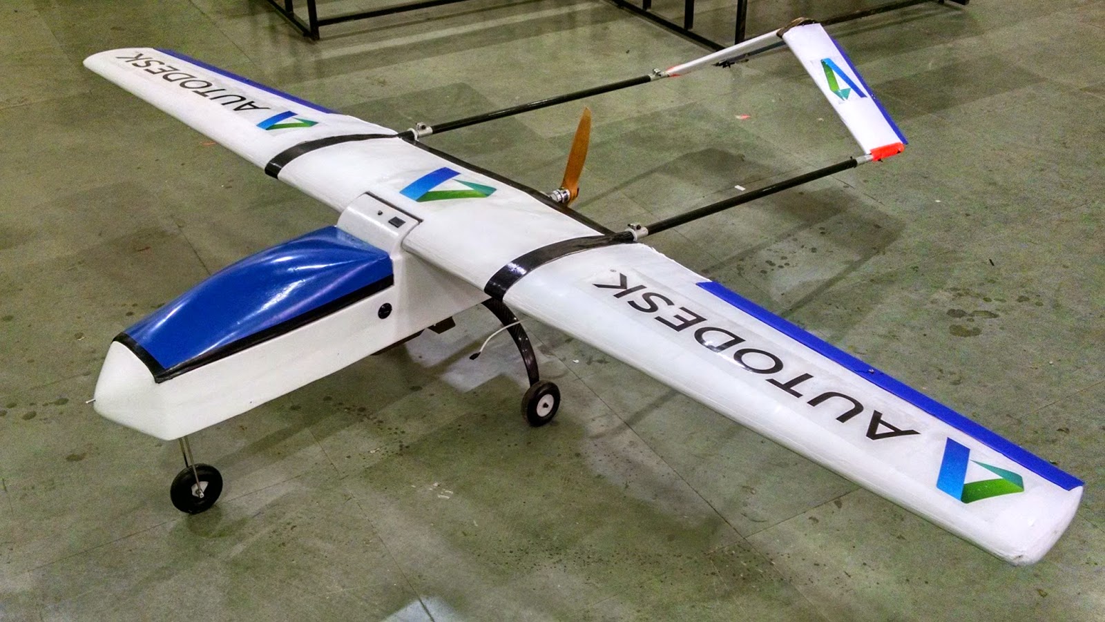

UAV Panchi Warms Up for Maiden Flight
Good to know DRDO has given IA the option of using Nishant with wheels which will reduce damage from landing by parachute and enable higher payload of fuel and weapons. However this part is puzzling:
The mission team had to deal with many challenges while rolling out Panchi and still have some critical points to clear before the first flight.
“The handling of a remotely-controlled aircraft during its takeoff and landing procedures are extremely critical exercises. We have to ensure proper alignment of the aircraft to runway in addition to designing a control system with tighter control loops for quick corrections by the onboard system. Precise control of aircraft motion is required to assist the external pilot during various stages of the flight,” explained the scientist.
UAVs like Nishant are basically large RC aircraft and these are successfully built and flown by teenagers daily in India. Any decent school and engg college will have an aeromodelling club that can do the job. Can't understand what the huge challenge is with take off and landing. Even the pakis did this 6 years ago with a Nishant look-alike called Uqab.
^^^ I agree that Nishant and Panchi have gone through too long a development cycle. But I don't know how many college students and enthusiasts you know who design field-deployable UAVs which weigh 400 kgs?
Let me assure you that building the airframe is the least of the problems (though I don't like the nose gear on Panchi). The hold up must be on the payload and the ATOL system. It was supposed to have colour video and integration of synthetic aperture radar (SAR).

Indranil, no doubt making a UAV is difficult (though not impossible) for college students in India. But I'm talking about the radio control issues during takeoff, flight and landing quoted above which have nothing to do with the innards of a military UAV. If an Indian kid can guide a 5' span model on and off the ground, then DRDO should be able to do it w/o problems for a UAV is what I'm confused about.
Ramu
Posts: 149
Joined: 18 Feb 2011 17:05
Post by Ramu »
This thing got a 160 km range, uses a wankel engine. How can you say its an RC plane?
We all know how long it takes to build an airworthy engine however small, don't we?
You must build one and then talk.
Victor wrote:Indranil, no doubt making a UAV is difficult (though not impossible) for college students in India. But I'm talking about the radio control issues during takeoff, flight and landing quoted above which have nothing to do with the innards of a military UAV. If an Indian kid can guide a 5' span model on and off the ground, then DRDO should be able to do it w/o problems for a UAV is what I'm confused about.
The UAVs that the students are flying don't need takeoff or landing aid. They are light and take off fairly quickly. The problem appears when the scale and weight of the aircraft grows. For example, Nishant used to be launched at above 144 kmph. Even though that number will come down for Panchi (with flaps and possibly a lower AUW), it will still be considerable. The take off and landing runs are quite long, and a delay between action and response in a plane for an external pilot (all cues are visual and from a distance) is extremely unnerving. Also, with these large things moving so fast and full of fuel, you can't even make mistakes (Panchi is being made to FAR 23 requirements).
That's why the scientist said that they need tighter (smaller interval) control loops for the internal aids to help the external pilot. With Panchi this aided takeoff is enough. Moving up to Rustom, they need completely automatic take off and landing for full AUW.
Ramu wrote:This thing got a 160 km range, uses a wankel engine. How can you say its an RC plane?
It is a big deal, but not as big as we have made it to be.

^^^ always happy to admit ignorance upfront, even wilful. No one is an expert in everything, and little point in posting a question if one isnt.
But that is besides the point. The google UAVs (yes, they appear to be scalable and mission capable) are limited to a certain weight. It becomes a materials and engine technology question very fast as payload rises into 10s kgs and more. Or so it appears. So does the tarmak contraption.
However, laying the blame at the messanger does not beget you any prizes. This line of questioning started with how can you imporove the research/development/education.
Unfortunately the indefensible state of the UAV production (you can substitute your favorite aviation sub-speciality) means all you recieve from the so-called experts here are bolded phrases calling the motivation of the question itself into question.
I do not know. But that was never in doubt, was it? Broad generalizations of "very few countries" and "tight control loops" and so on do nothing but intimidate the ignoirant poster. I can certainly see this stonewalling being worthwhile if someone's job was on the line. That is not the case, as far as I can tell. So why the insecurity?
The problem was automatic take-off and landing, was it not? If Rustom-I can serve as a platform to test Rustom-Ii which is several times larger, what fundamental problem prevents testing of indoividual tools like automatic take-off and landing with simpler system?That never even entered the thought process, did it?
This "territorial prpotection" of internet excpert status begets no one any knowledge, how am I smarter by reading your brilliance?
I am not sure whether you were questioning or ridiculing. Nobody holds up an amateur enthusiasts' work in the face of many man-years of work and then say, 'but, I am just trying to learn'!
Shreeman wrote: I can certainly see this stonewalling being worthwhile if someone's job was on the line. That is not the case, as far as I can tell. So why the insecurity?
By the same token, why do you feel stonewalled if your comments are scrutinized. Certainly, your job is not at risk?
What else are they doing with Rustom-1? (Click). Because a much smaller UAV does not need assisted take off and landing! With Panchee, they are developing assisted take-off-and-landing. With Rustom-1, they are developing full automatic takeoff and landing. If this is not step-by-step progress, then I don't know what is!
You could question how much time, each step is taking for a program of national importance, and I will stand with you on that. But if you trivialize these steps to model building and say enthusiasts could have done better, then I will have no problems ridiculing such comments. And please don't complain if your mere comments are questioned. Because you are questioning other people's work!
