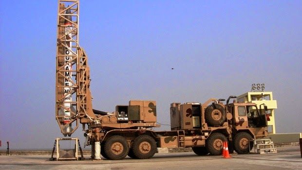

For Nirbhay i do wish we had gone for canisterized launch platform would have made it easier to adapt this for ship and sub launch.
Re: Indian Missiles News and Discussions - May 2017
They will be canisterized. This is just a test set up. Just like the Prahaar/Pragati.

Any sources for that? All of Prahaar mock ups displayed it in a launcher so far but I haven’t seen any Nirbhay mockups showing it in a canisterized launcher and Universal launcher CGI images strangely didn’t have Nirbhay as well.

John wrote:Any sources for that? All of Prahaar mock ups displayed it in a launcher so far but I haven’t seen any Nirbhay mockups showing it in a canisterized launcher and Universal launcher CGI images strangely didn’t have Nirbhay as well.
No source. My memory may be failing me but I think Tata 12X12 was pitched for Nirbhay carrier.
Although the mock ups and recent tests have shown AAD/Prahaar in canisters, for the first few years of testing, it was always a grid to hold the guide rails, just like Nirbhay.

Finally seeing some Indian TELARs.. B-)

Agni-V launch

Adorable little wheels on that tractor. Wonder what is the purpose of this vehicle, since this does not look like a cross-country play or even long-distance roll?
Pull the TEL out of a tunnel and fire?

^ This is not for cross country mobility like the ones on the Russian Steppe but for cross road mobility in various "depot"s and this will not be the actual open trailer but obviously covered and camouflaged

This test was likely a tight corner turn test
