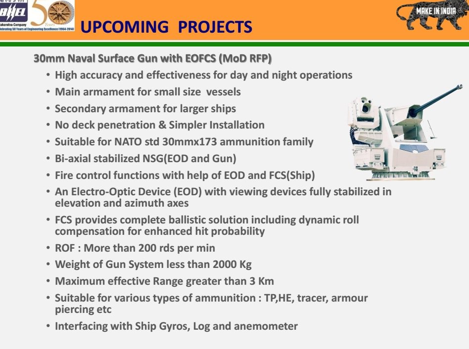

Re: Indian Navy News & Discussion - 15 Dec 2016
Post by Aditya G »
Enjoy folks;
