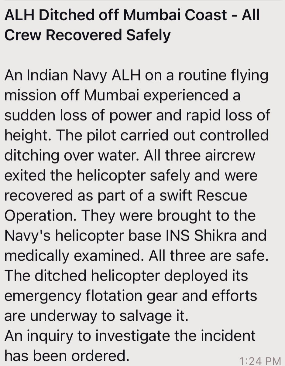

looks like they had a sudden loss of power and luckily were able to set her down with little or no structural damage.

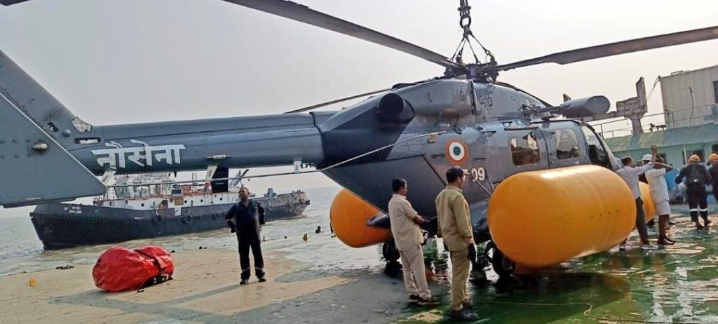

Did it go inside the water and pulled out or the heli stayed out of water after deploying the floats? As if it landed on water? In that case I should be flyable again?

The flotation mechanism would make the heli bob up fairly quickly despite getting dunked due to the force of the initial decent into water. How much dunking depends on descent rate. Looks like in this case, there was just enough power and the pilot's commendable skills and sang froid enabled a fairly controlled upright gentle touch down in water with very little dunking, upper half of the heli seems to have stayed dry. But some wiring, electronics, sensors etc would have been damaged for sure.
Some rescuers seem to be sitting on the rotor blades ?! The rotor blades are unfolded even when the heli is back on land after being recovered. Surely folding blades will make such operations easier.
In case the heli had tipped over before/while making contact with water, the flotation devices would bob it up upside down, making the crew's egress difficult. Don't know if there are any features that can counter this. May be Hari saar can comment. If blades break and fly around, they can damage the floaters, fuselage, windows and eventually the occupants. Lucky none of that happened.
Positive takeaway from the incident - real life proof that the flotation system works as it should in an upright ditching. Good job by designers, testers, mfg and maintenance teams.
If the engine didn't get dunked, the heli would be thoroughly cleaned, inspected, serviced, certified and reinstated into active duty.

Also part of engine cowl is missing in the first photo. May be something blew. Very lucky if that was the case.

Looks like the helo only partially submerged but hard to say where exactly the water has entered just by the photos available. She will be dismantled to the required extent and gone over with a fine toothed comb.
HAL will probably send a contractor's working party to assist the IN in doing the detailed strip examination along with the Navy's own inspectors.
The engines and the transmission chain seem ok. Even the tail rotor may not have impacted the water. These are the most expensive components. If the tail rotor impacted, then both the main and tail gear boxes, the tail drive shaft and other drive components in the transmission chain will simply have to be replaced. No inspector will allow them to be reused again. They will end up in the training school.
There will be some underfloor LRUs, airframe components, undercarriage parts and a whole bunch of electrical wiring harness that needs to be inspected and most than likely that they will all need to be replaced, as a matter of abundant caution, because of the salt water ingress and to ensure continued reliability going forward.
A twin engined helo losing power like they said that it did is not normal. The IA has also lost such helos so the BOI will have its work cut out to see if there are any common issues
Much of the interior and the affected exterior will be inspected, and treated and some parts will either be refinished/replaced/repainted.
This helo will fly again.

Cyrano wrote:Also part of engine cowl is missing in the first photo. May be something blew. Very lucky if that was the case.
Cyrano ji,
look again carefully.
The "engine cowl" is open and it is also designed to be a servicing platform when open.
The crew seem to have opened it for better hand hold grab points when they clambered up (those three guys sitting on the main rotor head)

Yes, you are right. But seems odd. It's hinged at the bottom, so to do that surrounded by water, one has to clamber up first?!

Cyrano wrote:Yes, you are right. But seems odd. It's hinged at the bottom, so to do that surrounded by water, one has to clamber up first?!
Cyrano ji,
It also serves as a servicing platform that can easily support two or three guys. It needs to be hinged at the bottom, no...
There are usually hand and foot holds to climb up.
Ladders are not always available in the field.
here the handles that are used to climb up to work on the engines or the components on the main rotor head are clearly visible around the helo's airframe number CG 858. Follow them to see the other handles right to the top.
also visible are the platform hinges, to left of the winch
its hinged at the bottom by design so that the technicians can sit on it while repair/maintenance . the mk 1 dhruvs did not have this and was added later after the navy complained.
