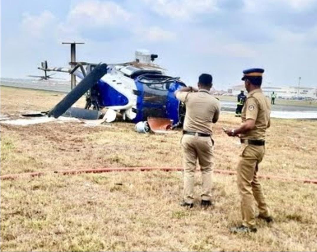

ALH Dhruv Mark 3 helicopter crashes at Kochi
26 Mar 2023, 04:04 PM IST
An Indian Coast Guard helicopter, the ALH Dhruv Mark 3, crashed after making a forced landing during a test flight in Kochi on Friday. The cause of the crash is unknown at this time. The ICG is investigating the incident and the runway remains closed for further operations.
The chopper was at around 25 feet in height when it had to make a forced landing.
All crew are safe.

I thought the fleet was grounded after the Navy crash?
Re: Military Flight Safety
https://mobile.twitter.com/defencealert ... 4271896576
Video of the cg chopper crash . It was a testing flight from the grounded fleet
https://twitter.com/realkaypius/status/ ... 2Jp8ItAAAA
Early days, but looks like a loss of control in cyclic circuit. I can go so far as to say that in both IN-709 & CG-855, the crew saved the day.
A few 100 ft higher & this would've ended in tragedy
Seeing the video. It doesn't appear to be anything wrong with the machine.
It appears to be a case of the aircraft entering vortex ring state.
The low altitude of the aircraft compounding the matter.
Such situations are recoverable if the aircraft is at sufficient altitude.

Facts are HAl had inspected the control rods which were suspected of causing the previous crashes and certified the helicopter to Coast Guard.
The helicopter developed loss of rotor control during its first flight.
