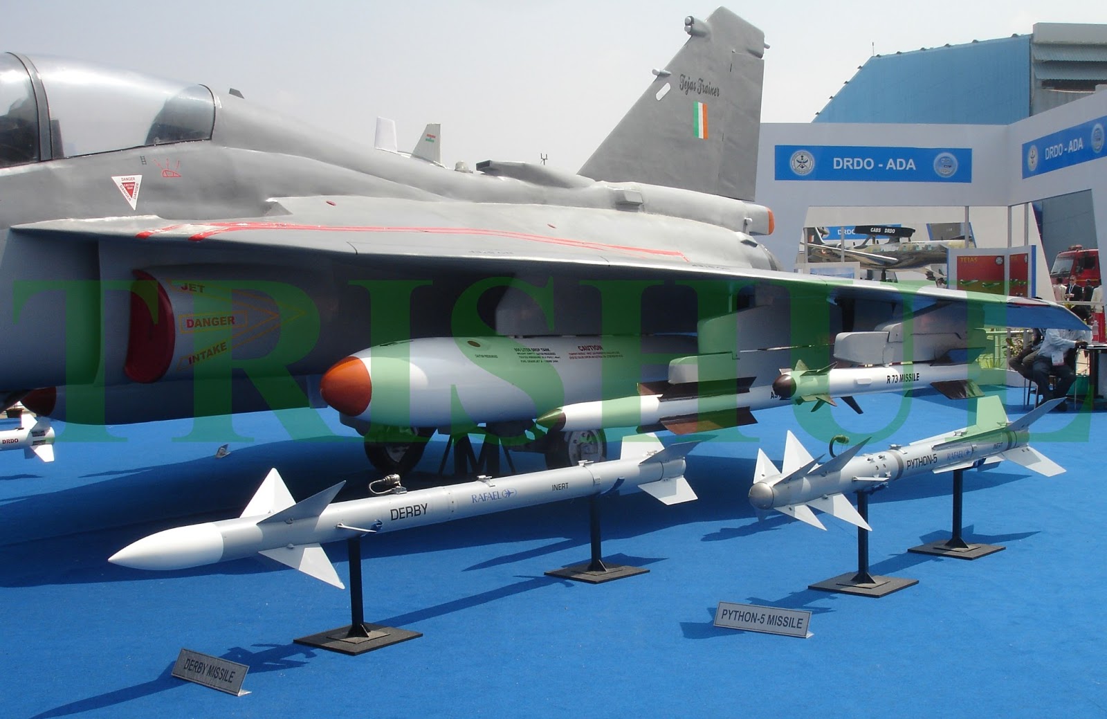

Re: LCA News and Discussions, 22-Oct-2013
Karan M wrote:ADA IIRC hasnt even talked about which BVR missile fit for FOC...onlee media has pointed out its likely to be Derby...
Derby Missiles Selected to Arm India’s Tejas Fighters
February 14, 2011 at 07:55
Israel’s Derby missile is the weapon of choice for India’s Tejas fighter. A contract will be signed by March with Rafael Advanced Defence Systems Ltd to supply the air-to-air weapon for the indigenous Indian jets. P.S. Subramanya, director of India’s Aeronautical Development Agency, which is developing the light combat aircraft. According to Subramanya, a key criterion for the full clearance is the integration of a Beyond-Visual-Range (BVR) missile. The Rafael Python V missile, closely related to the Derby, was also an option for the Tejas, Subramanya stated. Delivery of the missiles is expected in the second half of 2012, toward the final phase of testing, expected to conclude by December 2012.
These were at an ADA stall ...

So looks like the Derby and Astra will be the main BVR AAM for LCA aand not R-77 due to Isreali help with MMR.
Woud be nice see LCA with Python V plus Astra combo a couple of years from now.

I thought that IOC was obtained with an R-73 Russkie missile.Derby.The CAG had earlier said that the Derby failed to meet parameters in IN service.Any news of its improved performance? Or has it been acquired bcos of the Israeli radar? LCA production figures highly optimistic.Wait and watch.However with the Rafale deal in trouble the LCA success becomes even more critical with MIG 21 phasing out.More Flankers anyone?

Philip wrote:I thought that IOC was obtained with an R-73 Russkie missile.Derby.The CAG had earlier said that the Derby failed to meet parameters in IN service.Any news of its improved performance? Or has it been acquired bcos of the Israeli radar? LCA production figures highly optimistic.Wait and watch.However with the Rafale deal in trouble the LCA success becomes even more critical with MIG 21 phasing out.More Flankers anyone?
Obviously because of the part-Israeli radar! The Russkies will charge us two arms and a leg for integrating the R-77 (that is if they don't refuse outright!).
Which other BVR weapon is available for integration? Maybe the Chinese ones?
