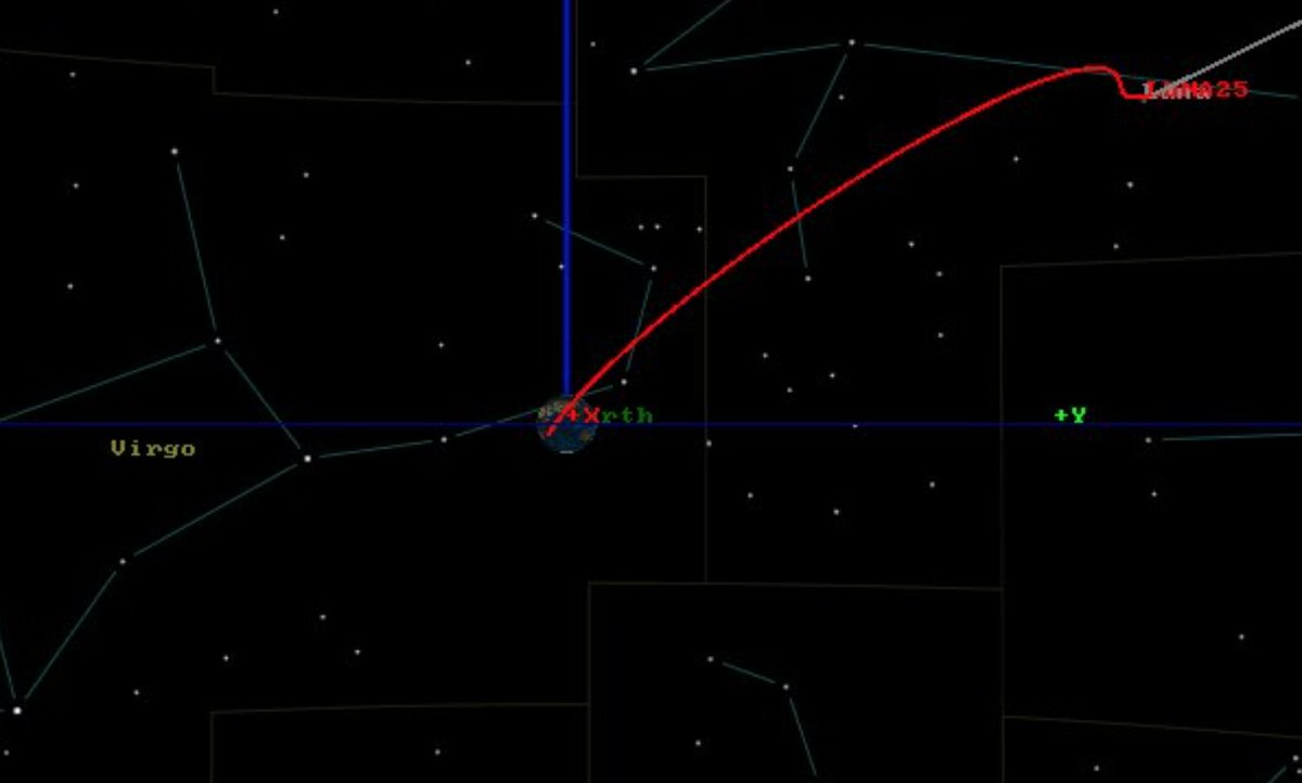

^^^ To be clear, Luna-25 is not nuclear-powered in the conventional sense, it does have radioactive isotope to give (Radioisotope power systems (RPS))it power even when there is no sunlight..

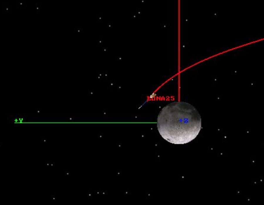

For fun, here is estimate of Luna-25 trajectory - as usual projected on two different planes. (Aug 15, 8PM UTC) - (Not official but most likely correct):
TLI has been done.
--- Meanwhile, CY3, orbits looks stable according go Doppler ..No drama!

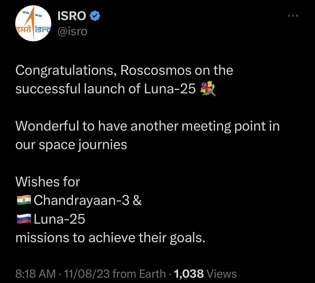

Re: Chandrayaan 3: Launch and Discussions
From ISRO:

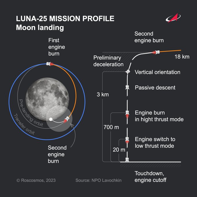

Posting the 'official' Mission profile of Luna-25:
Post by SSSalvi »
Luna 25 descent starts from 18 kms altitude against 30 Kms of CH3
and Congrats from CH3
https://twitter.com/isro/status/1689845 ... D32948.200

Looking at the mission profile, typical Ruskie approach. It is indeed a TEST_PLACE for their luna 25 craft which is actually Chandrayaan-1 vintage with some additional fuel to land.
Ruskie's first goal, "hey we reached first". Science, oh that is secondary. Let's do the engineering first.
Mission profile: just drop the Luna 25, it will slow down and it will slow down further. And then land, somewhere in the vicinity of where we intend to land. The Russian scientist says, but the crater is over there to study. Well, from the engineering perspective, that is the problem of the intertial navigation team. They were not precise enough.
Anyway, operation successful, even if the patient is dead. You see, we do not know if Luna 25 is carrying the radio isotope batteries. It is assumed that it does since it is renamed as Luna25 and sounds like Luna24 line. It might have the Radio-Isotope battery, but I have not found a definitive answer. I think it does not have Radio isotope batteries since their "TEST_PLACE" is in full sunlight all the time!
Meanwhile ISRO scientists, lets do some science while solving the engineering problems. Let's identify craters of interest. Let's put a rover over there. Heck we do not have radio-isotope batteries, lets calculate the orbits and get an orientation with maximum sunlight. Let's put the solar panel on Pragyaan in such a way that it shields the electronics from direct sunlight while generating energy. Let's orient the Vikram lander in such a way that it gets the maximum power.

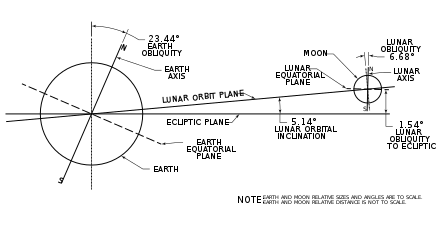

To add and Just to be clear:
Moon's axis is NOT tilted 23.5 degrees like earth so unlike earth it does NOT have places with significant 'maximum sunlight' like north (or south pole) on Earth. Moon's axial tilt is *only* about 1.5 degrees with respect to the ecliptic so it does not have pronounced 'summer' or 'winter' type variations as we have on Earth. The 'arctic circle' is above 88.5 degrees.
CH3 (or Luna25) landing site is still about 600 Km from the pole.. The Sun will be low on the horizon but day/night time will be about 14/14 days.
Interestingly (as I pointed out also in CY2 thread - but most people do not know/realize ), there are some areas (near the poles) deep in the canyons, where sunlight never reaches and they remain permanently dark.
There are are about 300 such known permanently shadowed regions (PSRs) ... they are always dark so difficult to observe. NASA’s ShadowCam (which orbits the moon aboard the Korea Pathfinder Danuri) first time took 'pictures' last year.. one area about 2000 metres wide inside Shackleton crater, near the lunar south pole was AFAIK was the first area observed in details.
OTOH - Peary crater near the north pole, there are peaks of eternal light (perhaps the only known region in our solar system (**see note below**) where the sun never sets. Not an idea place to land.
Added later: Okay did some research/calculations and find that there are a few such other places ...
Mercury: axial tilt (about 0.034 degrees), some crater floors near its poles are in perpetual shadow and experience extremely cold temperatures, while certain sunlit regions near the poles also receive near-constant sunlight.
Ceres (Dwarf Planet): Ceres an asteroid t between Mars and Jupiter, has areas near its poles that experience near-continuous sunlight.
Pluto: While not a planet, Pluto's axial tilt is quite significant (approximately 122.5 degrees). This means that certain regions near its equator can experience nearly constant daylight during parts of its year, despite being far from the Sun.
Triton (Moon of Neptune), Titan (Moon of Saturn) and Io (Moon of Jupiter) may be such other candidates..
Posts: 2580
SSSalvi wrote: 11 Aug 2023 20:57
Like CH3 landing site , "TEST_PLACE" , is also illuminated for 1 Lunar day of 14 Earth days. ( Only when Moon is above ( Northern half of ) ecliptic. )
For perennial sunlight we have to move to higher Latitudes like others with robust outer shield.
Of course rest of the wishful thinking is something to ponder on.
Given the proximity of the two sites, I hope this is not some Chinese-inspired plan to show up there first and somehow jam CY3 communications during the crucial landing phase. Not sure if it is feasible to even load any such equipment into a small lander/rover, but I can't help "thinking the unthinkable".
Posts: 3317
Amber G. wrote: 11 Aug 2023 21:40
The moon's orbit eliptic and the earth's orbit eliptic are tilted 5.16° (see https://en.wikipedia.org/wiki/Axial_tilt ). Rahu and Ketu are points of interception of the earth's eliptic to the moon's eliptic.
Posts: 12001
bala wrote: 12 Aug 2023 00:02
Just some basic geometry and basic astronomy:
Ecliptic - is the plane where earth (and Moon - and almost all the planets - except comets etc) goes around Sun. (Earth's ecliptic is not different than Moon's 'ecliptic' -- *all* planets move more or less in the same plane).
Earth's Axis (Line joining North Pole- south Pole) line is tilted around 23.5 degrees) and Moon axis (Line Joining Moon's North Pole and South Pole is 1.5 degrees with respect to ecliptic.
So like on earth, we have summers/winters, and as go go at higher latitudes length of day could be longer than night (or vise-versa), including places above arctic circle where sun, depending on the time of the year, never sets (or rises) --- On Moon this kind of situation is not pronounced. For most of the moon, day and night are roughly equal (each around 14.7 earth-days).
Rahu and Ketu are nodal points - point where orbit of Moon (around earth) touches the ecliptic. This orbit plane (Orbit of moon around earth) is tilted around 5.1 degrees wrt to the ecliptic (BTW Rahu and Ketu are not fixed, they make a complete cycle in around 18,6 years.
This also means - the Moon's *maximum* possible declination (position above or below equatorial plane) can vary from 18.5 to about 28.5 degrees (with in time span of 18,6 years).. at present this inclination is about 28 degrees.
(This means, at present (this whole year) one can see Moon at zenith at its highest point in the sky at some time of the month from any latitude below 28 degrees - say from Florida or Jaipur India. For Sun, you have to be lower than 23.5 degree lattitude, About 9 years from now, the situation will change and you have to go below 18 degrees to see moon at zenith)
Since all these are vectors the inclination/angles calculation is not simple but requires spherical trigonometry -- Or needs three dimensional mode to understand.
Hope this helps.

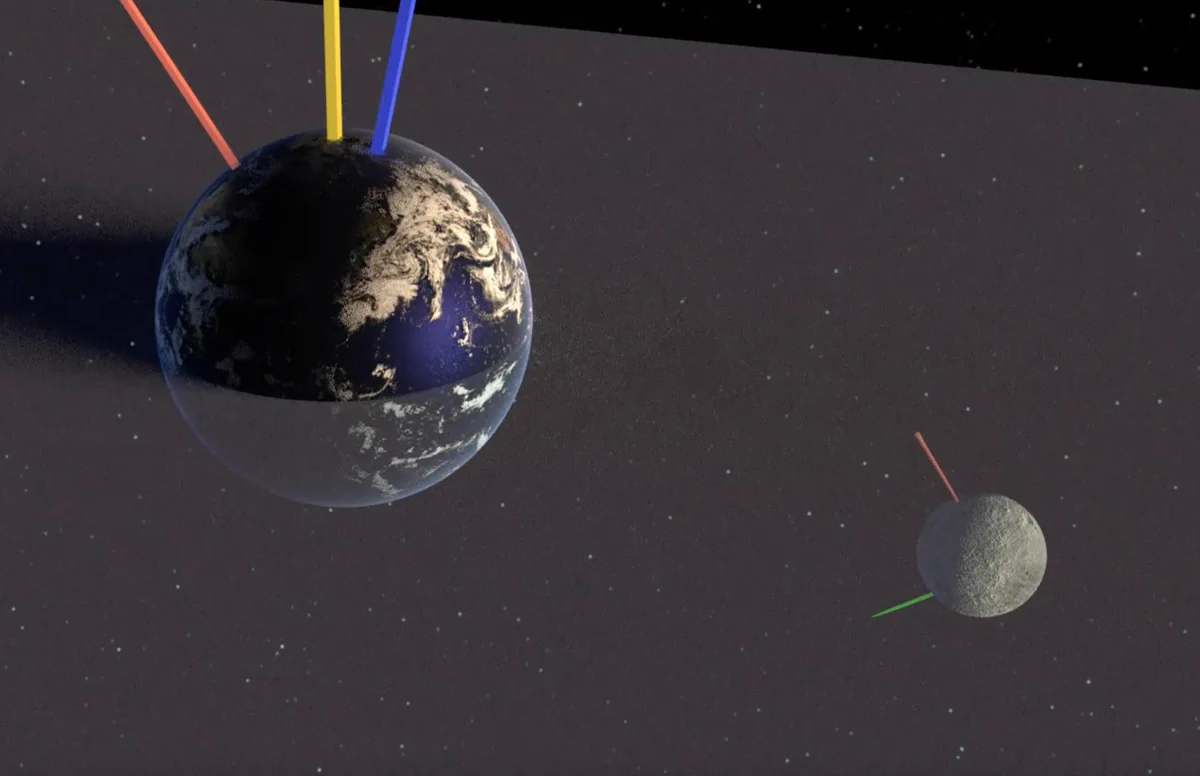

^^^ Decided to put an animation to show it clearly -- Since many have questions about this..( Hard to 'draw' 3-dimensional models on 2_D dhaga :) )
The animation below shows the geometry (not to scale) of the orbit and rotation of the Moon. The grey plane is the ecliptic plane. The yellow axis is the normal to this plane. The inclined orbit takes the Moon above and below the ecliptic plane. (The points where it crosses the ecliptic plane is where Rahu and Ketu are :) - Nodes - When moon is close to these points eclipsed can take place
The blue axis is in the direction normal to the plane of the Moon's orbit. The red axis is the direction of the rotation axis of the Moon: over the course of one Lunar orbit, it points in the same direction in space. The red, yellow and blue axes remain on the same plane, and this defines a Cassini state.
Geometry of the lunar orbit/rotation vector. The plane of the Moon's orbit is inclined by 5.14 deg with respect to the normal to the ecliptic plane - the plane about which Earth rotates around the Sun. But just like the Earth’s rotation axis is inclined by 23.5 deg in space, the Moon’s rotation axis is also inclined, by about 1.54 deg in space.
<click for animation> Image
Hope this is helps.
