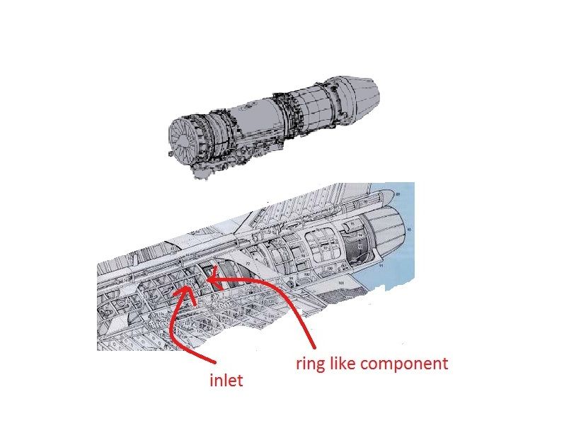

Victor wrote:Indranil, that image did not post but if you are referring to a cutaway, I know what you are saying. It still doesn't make sense to increase even the fuselage dia. First, the engine extends only about 1/3 the length of the fuselage from the back and the current fuselage "tube" is wide enough to fit the fattest part of the F414 (35") so the inlet should not cause any changes.
No Victor ji, the inlet has to be supported by ring like structural components. The 'fattest' part as you call need not. It will be a long discussion.

indranil wrote:the inlet has to be supported by ring like structural components. The 'fattest' part as you call need not. It will be a long discussion.
The F414 was purposely designed to replace the F404 in it's original footprint as was done with the Hornet -> Super Hornet. Here is the F414 with the LCA's F404 engine housing:
It looks to me like nothing needs to be changed to accomodate the F414 other than maybe the "ring-like" component having its internal diameter changed a little. The diameter of the fuselage doesn't look like it needs to be enlarged and certainly the wing structure has nothing to do with any of this.

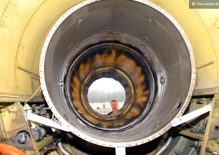

Here is the engine "tube" as I called it in the F-16. The LCA will have to have something similar, even if not as modular, to facilitate easy service, overhaul, repair and upgrade. Engines will be inserted and extracted like popsicles.
This is why I get suspicious when I hear stuff that doesn't make sense. Nothing offered so far by you (very graciously and patiently, I agree) and others has changed my understanding that the new engine will need more fuel, hence the longer fuselage to store that fuel and (even slightly) bigger wing area to provide extra lift for all that extra weight. It is not that complicated.

Victorji,
I am afraid, your reasoning is not correct. Those rings have more work than just keeping the engine inlet centered. And you can imagine they are manufactured to exacting standards to keep the weight low while providing sufficient structural strenth. You can't just shave off the internal diameter of the ring by 3 inches, without having other repercussions.
Also will the Mk2 be positively wider at the fuselage. Kartik's talk at AI'13 says it will. I trust him more than any journo out there. But will it ultimately end up as the TP told him, only time will tell.
By, the way 414 is more fuel efficient than 404. So for most operations when the engine will not be at full power, the 414 will be using less fuel than the 404 at that power. There are very few moments in the entire flight when the pilot would go for full AB, like maintaining very high STR, or high alltitude take off or landing. For those very short times the 414 would be sipping more fuel, but only just. Overall the 414, is supposed to be more efficient than the 404 during the total duration of the flight. So, the extra fuel is not for feeding the 414. The extra fuel is to increase range or to free up pylons according to the mission.
So don't worry so much.

Victor wrote:It looks to me like nothing needs to be changed to accomodate the F414 other than maybe the "ring-like" component having its internal diameter changed a little. The diameter of the fuselage doesn't look like it needs to be enlarged and certainly the wing structure has nothing to do with any of this.
The "ring-like component" is what transfers engine thrust to the airframe. If you enlarged it's internal diameter, you would have built yourself the world's first self-ejecting jet engine, one that comes out of the front of the airplane at that!
Ideally, you want the engine and airframe to fly at the same velocities. Weakening structural components willy-nilly makes that a tad difficult to achieve. I've been told that even a tiny difference is bad for pilot morale.

Victor wrote:The entire fuselage is "hanging" below the wing and a minor increase in fuselage dia should not affect the wing at all
Here is a photo of the Tejas. Does it look like the entire fuselage is hanging below the wing?

Mihir wrote: The "ring-like component" is what transfers engine thrust to the airframe. If you enlarged it's internal diameter, you would have built yourself the world's first self-ejecting jet engine,
:rotfl: :rotfl:
Very cute but way off course. The engine is not mounted to the airframe via this "ring-like component" or even a series of rings as you appear to suggest. They don't transfer the engine thrust to the airframe and are not part of the load path. The engine is connected to the airframe by struts at a surprisingly few points and is designed to be swapped out in a matter of minutes by field mechanics. These struts connect the airframe to the engine's "static" structure (independent of fuel system, fans, compressors) that actually transfers the inertial and gyroscopic forces to the airframe. Most modern jet engines are like this, including the Kaveri.
The F414 uses newer materials including graphite composites to save weight but basically maintains the same proven structure and mounting arrangement as the F404 since it is pretty much the same size by design, being a low-risk upgrade of the 404. The F-18 also transitioned from 404 to 414 but ended up as essentially a new aircraft being 25% bigger and carrying 33% more fuel for exactly the same reasons that AM Rajkumar was suggesting. The LCA2's F414(INS6) is more powerful than the stock 414 in current Super Hornets.

Victor wrote:Most modern jet engines are like this, including the Kaveri.
Of course, saar! Very true, saar! I bow to thy superior knowledge. Yes, let's increase the internal diameter of "ring-like structures" all over. In fact, let's do away with them all together. Save on weight and put in some extra fuel. And with the F414 being of the same diameter as the F404, it should be very easy onlee. As it is, the "entire fuselage is hanging below the wing", which makes the job all the more easy.
Victor wrote:The F-18 also transitioned from 404 to 414 but ended up as essentially a new aircraft being 25% bigger and carrying 33% more fuel for exactly the same reasons that AM Rajkumar was suggesting. The LCA2's F414(INS6) is more powerful than the stock 414 in current Super Hornets.
Dude, for the love of ooparwallah, please stop repeating that rubbish. Yes, the Super Bug is larger than the plain ol' Bug. But that is because it had to meet increased payload and range requirements. Remember, it was initially intended to be a replacement not for the F/A-18C/D, but the A-6 Intruder. McDonnell Douglas designed a larger airframe with greater wing area to enable it to carry a greater payload. That in turn necessitated an increase in engine thrust, which is why the F414 was chosen. The other objective was greater range. The fuel carrying capacity was increased so that the platform had greater range, and not just because the new engine consumed more fuel, as you suggest. They would have had to increase it even if they had persisted with the old F404 engines.
Now ask yourself this: If the F414 is essentially the same size as the F404, how is it that it delivers more thrust while being more fuel efficient and even consuming less fuel in certain flight regimes? Could it be (gasp!) that the airflow requirements of the newer engine have gone up? Is that why the Super Hornet has a wider fuselage and a larger intake than the Plain Ol' Hornet ? Could that (along with the greater diameter of the new engine) also be the reason the Tejas Mk.2 is meant to have a wider intake, and therefore, a wider fuselage, which pushes the wings out?
