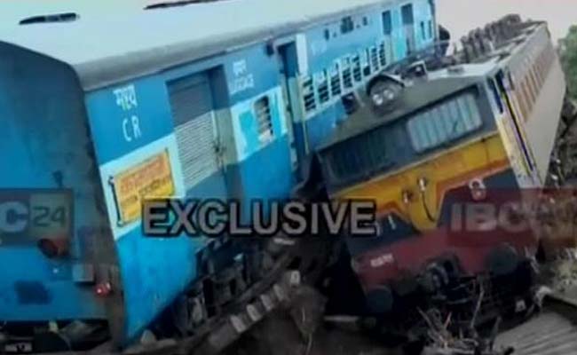

Two trains derail at same spot in MP, 5 bogies fall in river: Reports
http://timesofindia.indiatimes.com/indi ... 352045.cms?
New reports peg the number at 8. kamayani ke 5 coach and janta ke 2 coach plus the engineKamayani Express, on way from Mumbai to Varanasi, derailed near Kudawa railway station, 30kms from Harda in Madhya Pradesh, on Tuesday late night, according to reports.
Another passenger train, Janata Express from Patna to Mumbai also derailed at the same spot, Hoshangabad divisional commissioner said.
Five bogies of passenger train Kamayani Express are feared to have fallen into Machak river, Harda district collector Rajnish Srivastav told ANI. It has been reported that two passengers were electrocuted while trying to come out from Janata Express.
Water level of the river was dangerously high due to heavy rainfall. Kamayani Express derailed while crossing the bridge and its five bogies fell into the river.
Special team with around 25 doctors, police officials and rescue personnel has been dispatched to the spot via a special train. This special train has five bogies. Due to waterlogging, it was not possible for the team to reach the accident spot by road, according to reports.
Rushing emergency medical & other relief personnel to spot. darkness,water creating hurdles but ordered all possible help.

Seems that water had been released from a nearby dam + heavy rain in the area. There was water on tracks and the bridge was submerged. Tracks caved in.
Re: Indian Railways Thread
This is not the first time that water being released has caused a disaster. After a number of such episodes, should not the railway and local authorities identify and isolate such spots for special monitoring and jointly coordinate quick action during heavy rains??

Is it not the duty of a Gangman/Trackman to check for safety of tracks? If it is not humanely possible can we have technology to fill the gap?we are paying with innocent lives are lost and public property destroyed.chetak wrote:^^^^^^^
Obviously technology needed is not as complicated as tracking a spacecraft in Mars orbit. If we can accomplish that what is so difficult to check for track status with sensors and send it remotely to a central location?
from my experiences in assam floods, the track itself and the concrete sleepers under it may be pretty much normal looking, so any device that passes some current and checks for breaks etc will still work, or any casual visual inspection might still work.
but the soil and socks in the berm below the tracks will be worn and loosened such that the next train passing by will crash
similarly rapid erosion of the mud and rocks at the base of bridge pillars reduce its load carrying capacity...like a building with too shallow foundations.
in severe floods all the soil below the tracks will be gone and the tracks will be hanging in thin air.

Sad to hear more preventable deaths.
Even if the gangman wanted to stop train he has no way of doing so other than heroic light waving at last moment. Despite numerous accidents IR still has not implemented in-cab signalling.
These flood releases are very rapid events, usually a matter of seconds maybe a minute tops to peak flow. Certainly bridges can be very easily designed, tied down, to resist scouring and stay intact during high flow events. It is not very complicated. Cheap and easy to do. Embankments can also be reinforced quite easily. In fact I have see excellent design measures taken on rail bridges on the kaveri and krishna. The krishna bridges held up under a once in 500 year flood a couple of years back that topped out at 2.5 million cusecs, which rivaled the amazon for a few days. a flow that topped the piers in many places. Trains ran just fine.
Probably a poorly constructed old bridge in a fogotten corner. Local folks did not understand the weaknesses of the design. There are thousands such structures on IR usually in places that lack skilled engineers.
