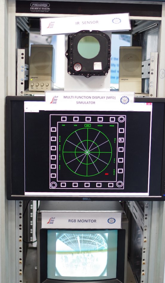

DCMAWs sensor and MFD display - its clearly an imaging sensor. Note the RGB display below shows people approaching the sensor etc. Depending on the where the DCMAWS display has been set up, sensors likely oversaturated w/light etc, but still, gives an idea of the sensor itself.

Oh wow..the first time I've seen the MAWS display that will most likely be seen in the Su-30 cockpit.Karan M wrote:DCMAWs sensor and MFD display - its clearly an imaging sensor. Note the RGB display below shows people approaching the sensor etc. Depending on the where the DCMAWS display has been set up, sensors likely oversaturated w/light etc, but still, gives an idea of the sensor itself.
