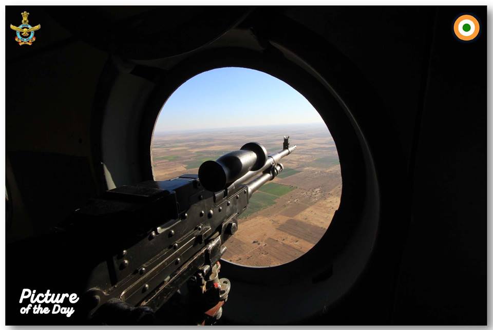

Most IAF Mi-17 have this cabin mounted MMG
https://pbs.twimg.com/media/Dhohth3V4AA5gBW.jpg
