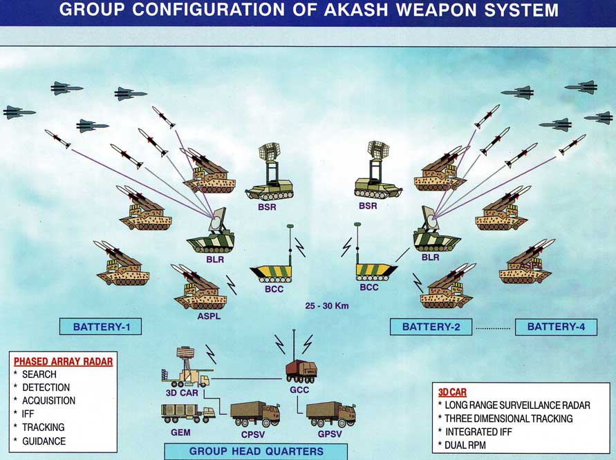

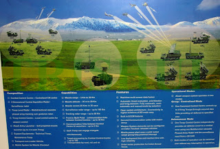

The TOE for an Akash Air Force Squadron is fairly straight forward as shown.
Squadron Headquarters
Technical Flight
A Flight
B Flight
Where differences crop up are with the Akash SAM tracked variant and its wheeled cousin.
Here we have a Battery level configuration where each battery has 4 Self Propelled Launchers along with an Battery level Surveillance and Locating Radars being carried. With 4 Batteries to a Missile Group, a single SAM Group in the IA would be able to deploy 16 Akash Self Propelled Launchers (Tracked). I do not think they carry over the Troop concept prevalent over the rest of the AAD.
Akash Missile Battery Tracked
The IA Akash wheeled variant is however more powerful, presumably for loss of mobility or otherwise. Here a Missile Battery has 2 Troops each with its own Troop level radars and 4 Akash Army Launchers.
Thus a Akash Missile Regiment with the standard 3 Missile Batteries could deploy as many as 24 Akash Launchers. These could be a part of the Air Defence Brigades in the IA although IA Air Defence Brigades were with Flak and Composite Missile Regiments last i heard.
Akash Missile Battery Wheeled
rohitvats
Posts: 7831
Joined: 08 Sep 2005 18:24
Location: Jatland
Re: Indian Missiles and Munitions Discussion
Post by rohitvats »
^^^Is this just me or does the wheeled Akash launcher have 2 x missile arms? Which would mean that 16 x 3 launchers would have same number of ready to fire missiles as 24 x 2 launchers. And could this be because the tracked Akash Group is likely to provide AD cover to a more compact AOR while the wheeled Akash Group is going to be more spread out?

Can an Akash Launcher be placed 35km in front of Rajendra and a missile be guided to a Target say 50Km away from the Rajendra?
yes that is the very way it operates in, the launchers will be passive and have no emissions until the targets are quite near it. launchers will be placed in ambush positions along expected lines of ingress and egress.
one of them may protect the location of the radars ofcourse.
a single akash system can protect an area size of a medium city.

Aditya_V wrote:Can an Akash Launcher be placed 35km in front of Rajendra and a missile be guided to a Target say 50Km away from the Rajendra?
Not that far!
It's more like launchers within 0.5km radius of Rajendra from what I remember. In a group mode from GCC, an Akash battery (BCC, Rajendra, launchers) could be situated at around 30km radius. Note: It used be on an official website (akashsam.com) but the site seems to have been shut down.
Group mode (4 x batteries) is where you'll get the best coverage. In a box formation, Akash group would cover 62kmx62km airspace and in linear formation it covers 98km x 44km. In a trapezoidal configuration, it covers the most area of around 5000 square km. All of these info was at the official site and luckily someone seems to have copied it on to Wiki.
So if we were to estimate Akash battery airspace coverage, it would be 31km x 31km. I guess formation wouldn't matter much as the launchers are restricted to around 0.5km from radar. Any increase in this distance would proportionally increase coverage.
vaibhav.n wrote:The TOE for an Akash Air Force Squadron is fairly straight forward as shown.
Technical Flight
A Flight
B Flight
It looks like the IA Akash wheeled variant is operationally setup like the Air Force variant. Both of these wheeled deployments seem to be in a group mode with 3D-CAR and two batteries to defend static/semi-static areas/formations. No BSR for battery.
Air Force Akash deployment
Army Akash Wheeled deployment
Army Akash Tracked deployment:
This seems to be able to operate both in an independent battery mode with its own BSR and BLR radars as well as in a group mode with 3D-CAR and 4 batteries. More designed for protecting mobile formations.
http://3.bp.blogspot.com/_44d3OT-xI3U/S ... hart-2.JPG
