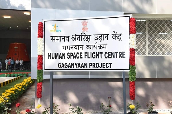

Recent inauguration of HSFC at ISRO HQ
Note - size of capsule from mock-up
