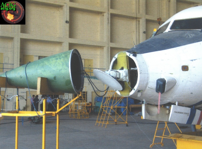

This is what I could find out about the desi LCA radome.
Lightning Protection for LCA
The nose cone radome houses the radar antenna. The antenna inside the dielectricLightning strike test on LCA model radome is a major electric field stress raiser at the front of the aircraft and will always be a potential lightning attachment point. Unless suitable protection scheme is in place, the lightning strike will puncture the radome wall and attach to the radar antenna,with the risk of severe damage to the radar antenna equipment as well as the radome. The protection scheme for the radome to protect it against the direct effects of lightning has been evolved through design studies and detailed experimentation. An optimum scheme has been worked out considering both radar performance and lightning protection .
The radome with the evolved scheme has successfully withstood high voltage and high current tests carried out as a part of qualification testing.
The high voltage tests proved the adequacy of protection scheme in preventing attachment to the radar antenna structure inside by puncturing the radome.
The high current tests carried out have verified the adequacy and efficiency of the scheme while ensuring the structural integrity of the radome.

Harry's pics provides the slightest ledge that can, perhaps, be used. Some of the points below might be silly but just go along with me.
1. What are those 2 black pipe like things?
2. What role might they play?
Maybe these 2 points are enough for now and hopefully start a discussion :)

Post by JayS »
>> Air probe connections??
>> Lightening Protection system connection??

Those black cables are most likely diverter strips for static discharge. Radomes can build up a lot of static charge.
Re: LCA Tejas: News and Discussions
The latch point contact should be enough to discharge to the main fuselage. no? why the cables?
