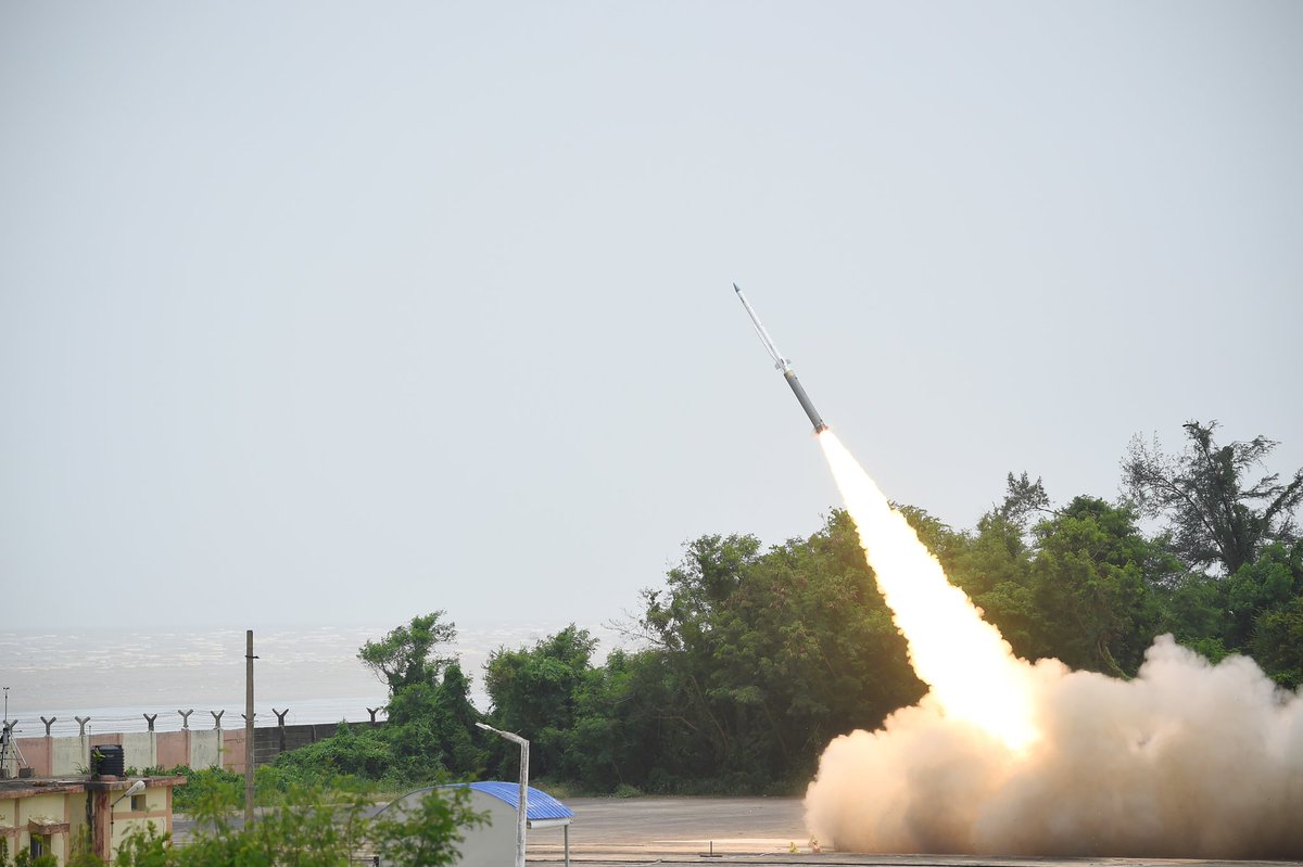

https://twitter.com/writetake/status/10 ... 9923187713
Here's the pic of yesterday's test firing of SFDR released by MoD.

Does this tech demonstrator have single or dual intakes? From the schematic and photos, I could only determine a single air intake.

Novices compare range and weight, the seasoned compare flight profiles. Please don't be a novice!
The jury on the advantages of rocket vs ramjet propulsion is still out. Ramjet gives much higher efficiency, so the missile has much more residual energy for the endgame. Rockets give higher acceleration and not prone to airflow distortions in the intakes. It is generally believed the Meteor is currently the worlds best AAM. Now SFDR has displayed all its characteristics.

Re: Indian Missiles News and Discussions - May 2017
Post by jaysimha »
Solid Fuel Ducted Ramjet Propulsion Technology
Project Solid Fuel Ducted Ramjet (SFDR) was started in May 2013 with the objective of developing
state-of-the-art SFDR propulsion technology, which can operate at varying altitudes and speeds. The
development and demonstration of SFDR propulsion system is a joint venture of DRDO and Russia.
https://www.drdo.gov.in/drdo/English/DR ... -ebook.pdf

srin wrote:How is a ramjet powered missile better than a dual pulse rocket powered one ? Compare Akash and LR-SAM, where DRDO developed the propulsion in both cases. LRSAM is almost one-third the weight (275kg vs 720kg), but has three times the range (80km vs 25km) for the same warhead (all wiki specs onlee). I'd have thought that Akash would be lighter since it doesn't have to carry the oxidiser ...
Adding SFDR to the mix, how would it really compare against (as someone mentioned above) a multi-pulse rocket motor ? Would its weight class be LRSAM'ish or Akash'ish ?
Many reasons but main reason is Akash takes direct flight path to its target where as MR/LR-SAM flies highly optimized flight path. Akash Ramjet engine is also based on older design compare that with Brahmos liquid fueled Ramjet engine which has far higher burn time and speed.
