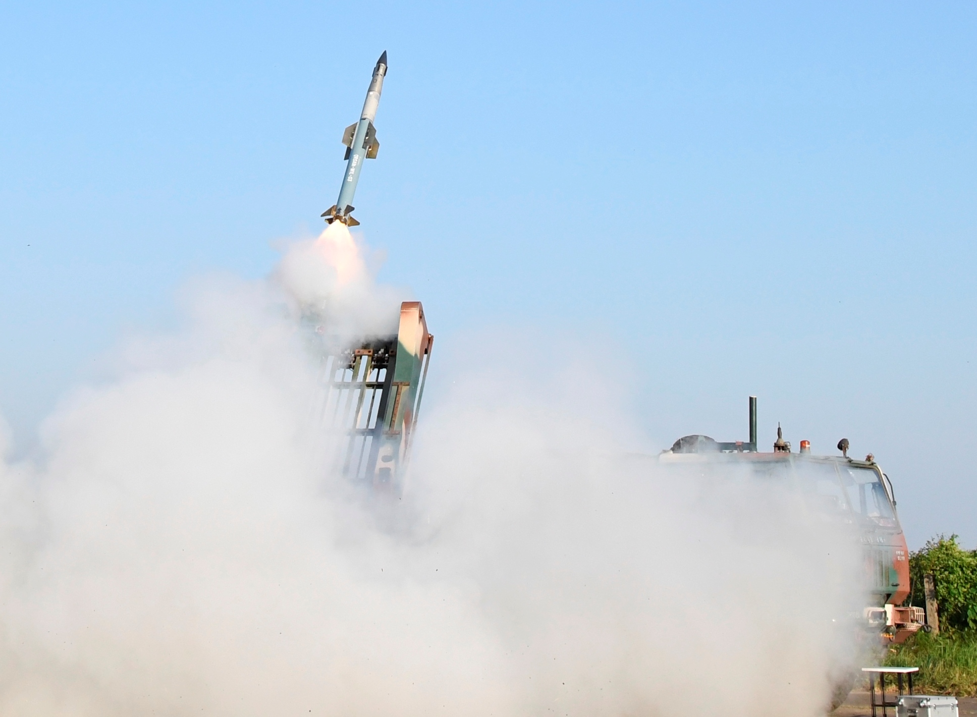

Hi Karan M: Is it true that the QRSAM is just another avatar of Astra? i.e. Astra seeker/guidance electronics in a larger frame?
Medium altitude seems to imply QRSAM has ability to hit targets above 10km (medium altitude is typically 15km) early some reports put a max ceiling of 6km must be to dismiss that without fully revealing its capability.Pilotless target aircraft at the medium range & medium altitude
There are common technology modules but the system in it itself is fairly different aerodynamically. It's not a direct derivative IMHO but purpose designed for the role.Roop wrote:Hi Karan M: Is it true that the QRSAM is just another avatar of Astra? i.e. Astra seeker/guidance electronics in a larger frame?
I hope you are right.John wrote:Medium altitude seems to imply QRSAM has ability to hit targets above 10km (medium altitude is typically 15km) early some reports put a max ceiling of 6km must be to dismiss that without fully revealing its capability.Pilotless target aircraft at the medium range & medium altitude
This would mean a fairly significant overlap with the Akash specs then.Karan M wrote:I hope you are right.John wrote: Medium altitude seems to imply QRSAM has ability to hit targets above 10km (medium altitude is typically 15km) early some reports put a max ceiling of 6km must be to dismiss that without fully revealing its capability.
Well missile wise, yes. But the Akash is a chase you down sort of missile. A ramjet will always have some performance advantages over a conventional motor even if dual pulse. The QRSAM is zip, coast, zip again.
The QRSAM IMHO offers more potential from the survivability point of view as its easier to setup and redeploy and also with a larger number of missiles per launcher, can handle surge attacks better.

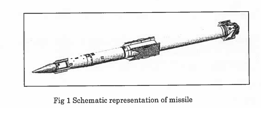

How is the Pinaka stabilized in flight?
Does it spin like BM-21?
Any idea about the rate?
Thanks.
Thanks.
Spin Stabilized, please see page 17. The rate hasn't been publicly mentioned unless it is in some research paper.ramana wrote:KaranM

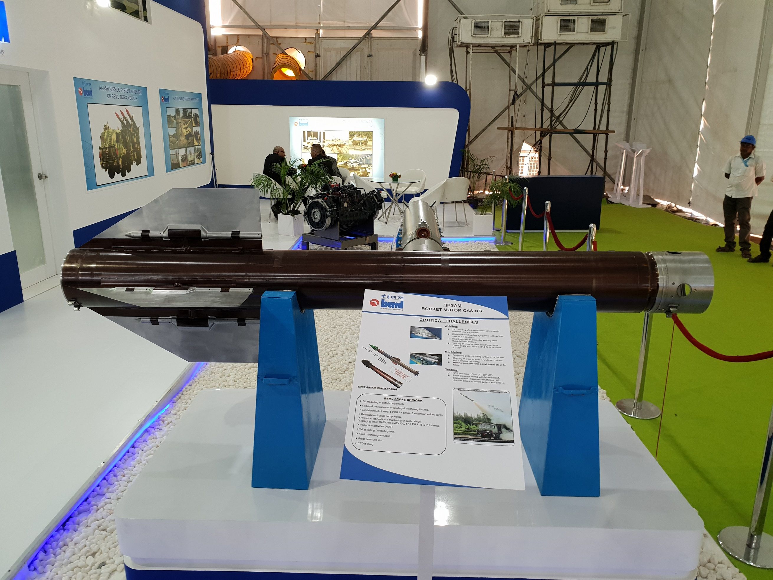

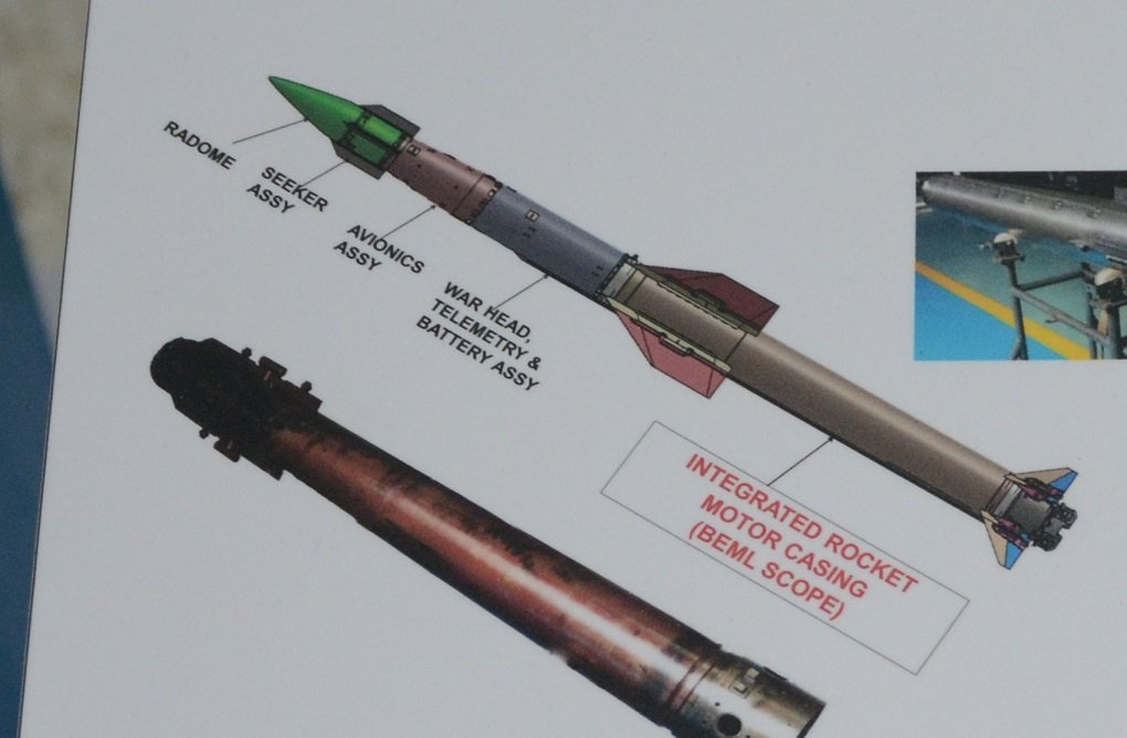

https://twitter.com/strategic_front/sta ... 42240?s=20 ---> BEML will make the motor casing of the QRSAM. This is a welcome development as having multiple manufacturers is essential for the success of Indian MIC. For now missile design work remains exclusively under DRDO even as an increasing share of manufacturing work gets outsourced.

On page 17 see that red blob in the acceleration graph, that resonance.
Most likely in spin or roll axis. And driven by vortices shed from the curved fins.
If it was lateral axis they would mention being off course.
From Mark I Eye Ball its around 15 HZ roll frequency.
