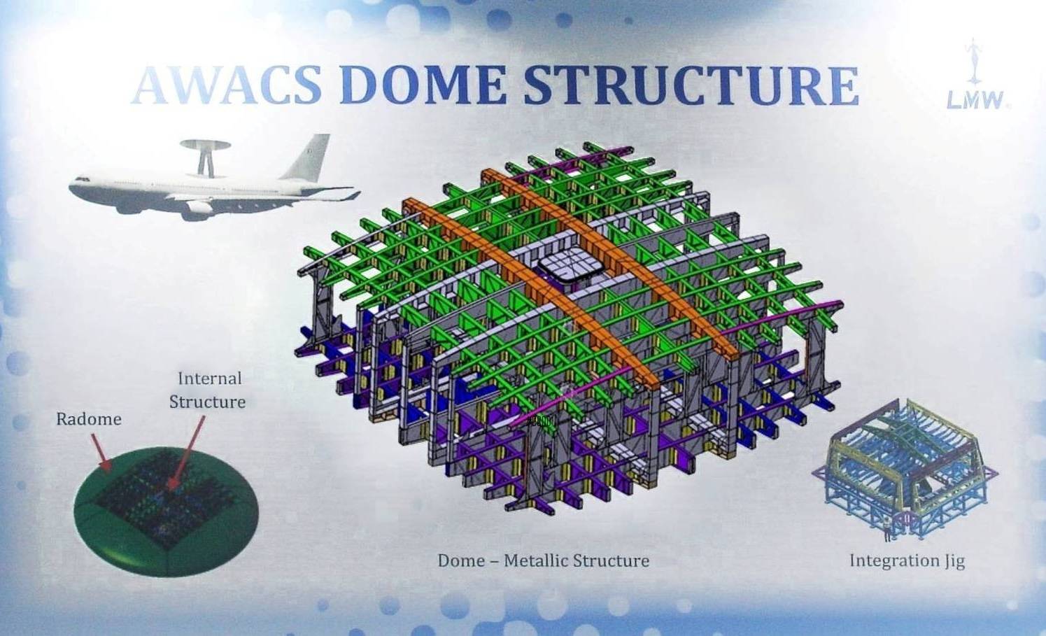

https://twitter.com/DefenceDecode/statu ... ndHEQ8SfZA ---> DRDO's 360 degree AWACS dome structure, manufactured by Coimbatore based Lakshmi Machine Works (LMW).

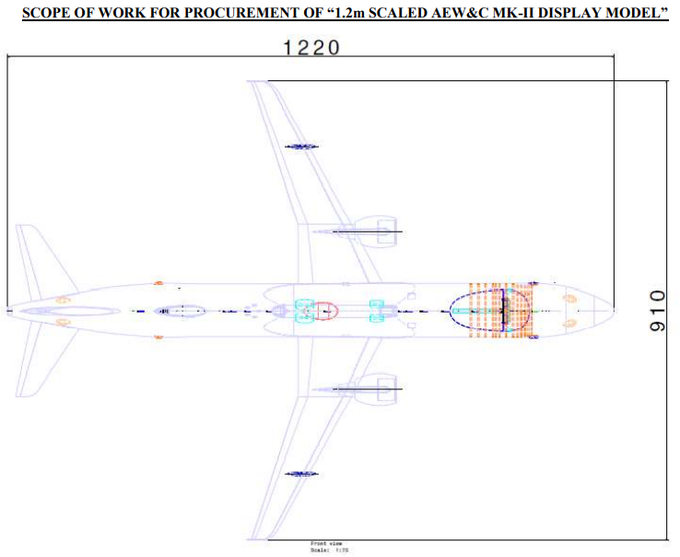

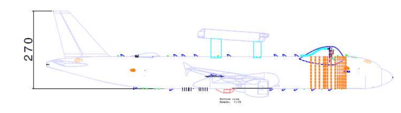

Posts: 10442
Re: Airborne Early Warning & Control: News & Discussion
The sub picture helps, but are there any dimensions? Roughly guessing, each panel looks slightly smaller than 2m height and 6m width. They may be able to pull 50 dB gain from each panel at C band, which would be amazing as it is a multiplication factor 100,000.
Posts: 7916
Wow! This is a nice lesson on building up industrial and manufacturing capacity.
For those who do not know, LMW makes a major chunk of the textile machinery in India........and Pakistan (I kid you not, the vaunted textile Industry of Pakistan imports Indian textile machinery through dubai look at this:
https://www.youtube.com/watch?v=4nSPedX4sUo )
Good to see them use their know-how for defense production.
https://www.lmwatc.com/
They seemed to be making ~36 crore revenue a year now from defense manufacture. Just 1% of their total business but a good start.
