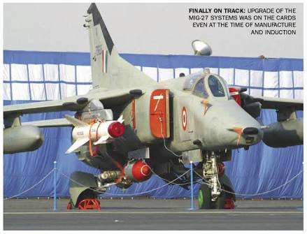

Now the Mig 27 upgrade etc show ~15m CEP. Shown with Russian FAB-500kg.
IAF has realized not good enough. Hence the PGM programs.

MiG-27s have Griffin too BTW. They were IIRC the first ones to get it along with the Jags. All the while since 1999, IAF has been busy buying LGBs from Israel for the most part.
