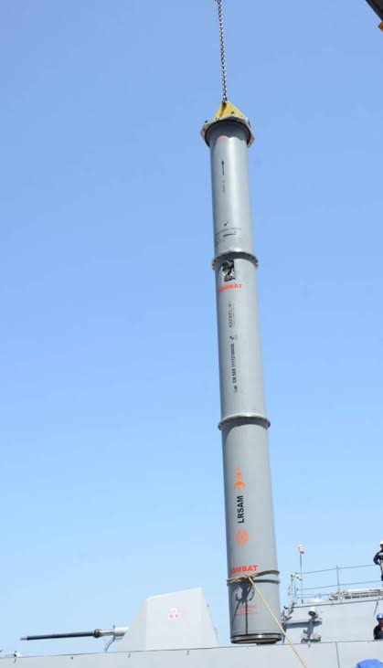

https://twitter.com/ThingsNavy/status/1 ... 51363?s=20 ---> The Barak 8 /LR-SAMlong range surface-to-air missile.

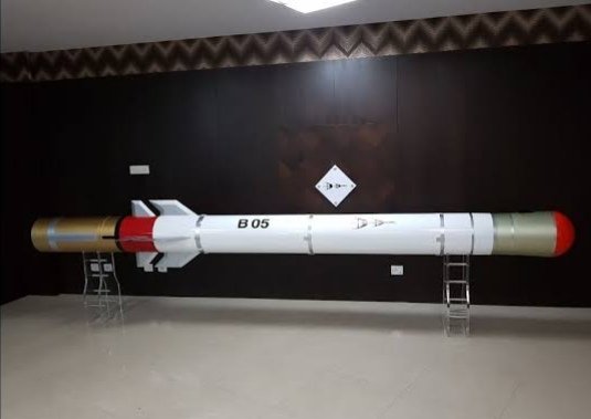

As per this tweet, this is a K-15 SLBM.
https://twitter.com/ThingsNavy/status/1 ... 65184?s=20 ---> K-15 or B-05... submarine-launched ballistic missile.
jamwal
Posts: 5727
Joined: 19 Feb 2008 21:28
Location: Somewhere Else
Post by jamwal »
It's land based version, Shaurya.
