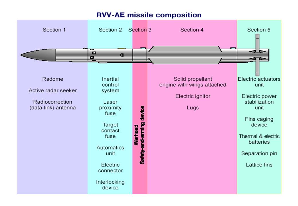

Is the RVV-SD the ramjet version? Wiki doesn't seem to say so. The claimed range for the SD is 110 km.
Re: Indian Military Aviation
nachiket wrote:Is the RVV-SD the ramjet version? Wiki doesn't seem to say so. The claimed range for the SD is 110 km.
No its just the modernised R-77 version with solid fuel no ramjet
http://eng.ktrv.ru/production_eng/323/503/567/
The first seeker shown in the picture is that for R-77

Austin wrote:Singha , I am talking of RVV-SD and not the older R-77E here
And similary the R-73E has been superceeded by RVV-MD
http://eng.ktrv.ru/production_eng/323/5 ... 601f3a8fea
The performance of AIM-120D/C7 and RVV-SD are almost identical , both have their pluses and minuses but by and large they are same and both are better then MICA and probably cheaper.
Mica was the french way of getting both the job done by single missile , its fine for WVR but for BVR they are not quite on par with US or Russian newer variant.
Whats the point of showing that? Are the MiG-29UPGs getting the RVV-SD and MD ? If so, where is the deal for purchasing these weapons? the MICA is recognised as being a potent weapon with a high Pk..the R-77 in IAF service has had its own set of issues as pointed out by CAG.
From what I've read, the R-77 had issues with motor burn time and consequently lost energy by the time it got to around 45-50 kms and had low end-game energy to engage maneuvering targets. The lack of a lofted trajectory is also a well known drawback of the older R-77.
Plus, the higher range numbers of the AIM-120 and R-77 are almost always in a best case scenario. You'd need to launch them at a high altitude with a high speed launch against a non-maneuvering target approaching head on in order to be able to get them at such long ranges. That was the entire point of the Meteor- its no-escape zone is higher and the end-game manevuerability and energy is much more than in the case of AIM-120 or R-77.
You spoke of how almost all fighters have RWRs or MAWS, so they would be able to detect an AIM-120 or R-77 launch if they could detect the MICA, so how is that a disadvantage for the MICA? In fact, at higher ranges, the targeted fighter (especially so at lower altitudes) has a much higher chance of escaping since the R-77 at the end of its flight will have little energy left to maneuver hard against a fighter that reverses its course. Anyone will agree that surprise is most important factor for a successful long range launch. And the MICA with its passive IIR seeker has the best chance of surprising a target whose RWR hasn't gone off and the MAWS may not have detected a long range launch.
Fair points. Just to add - the RVV-AE does have lofted trajector. Our issues were with the initial batches. As always, the initial export customers were the guinea pigs. Those issues are stated to have been resolved. We are not getting the newer missiles with the MiG-29 Upg but the original R73E and RVV-AE. The Mica, as you say - the IIR version is the real danger. it can knock down any plane in the world today or intended as well. Only PAKFA has DIRC measures nobody else does

Kartik wrote: From what I've read, the R-77 had issues with motor burn time and consequently lost energy by the time it got to around 45-50 kms and had low end-game energy to engage maneuvering targets. The lack of a lofted trajectory is also a well known drawback of the older R-77.
One thing to note is that Russian tweaks and improvements to the R77 (or any of their AAMs for that matter), are not very well covered in open source. The idea that the R77 does not have lofted trajectory is still making rounds, however, I recall quite distinctly that Pit (remember him?) had posted a source stating that it does in fact have the same in a discussion with JCage.
Russki AAMs are not well covered - we have the same info about R77 since the early 90s - I for one doubt that things have just remained the same over such a long period. I think a lot of trouble shooting had already happened by the time the IAF got theirs. And it remains IAF's most potent BVR weapon.
As far as long range launches are concerned - a video showed MKI drivers launching the R27 at "insane" ranges - go figure. I think tactics play an important role here and kinematic advantages cannot be easily dismissed.

Kartik , MICA design goal was to have a common missile for both WVR and BVR engagement , so it simply ended up compromising some of its long range engagement capability , MICA was superior to early model AMRAAM but ended up being inferior in long legs to late model AIM and R-77 , discounting the newest D model or SD model.
If longer reach was never really an issue most of world BVR developer would not have strived for achieving that in latter variant.
The loafted trajectory issue was with only with very early model of R-77 that was later rectified , the missile just needed to be programmed to do that , as you can check the R-77E has a range of 80 km , previously the earlier R-77 had 50 km range.
MICA/R-77 comparision
link1 link2
Kartik of all the 3 missile were fired at similar altitude , speed and condition say at 50 km from target , AIM-120 and R-77 would still end up having significant energy reserve to deal with maneuvering target compared to MICA if the target is aware he is under attack and tries to manouver to defeat the missile due to the latter better kinematic range.
