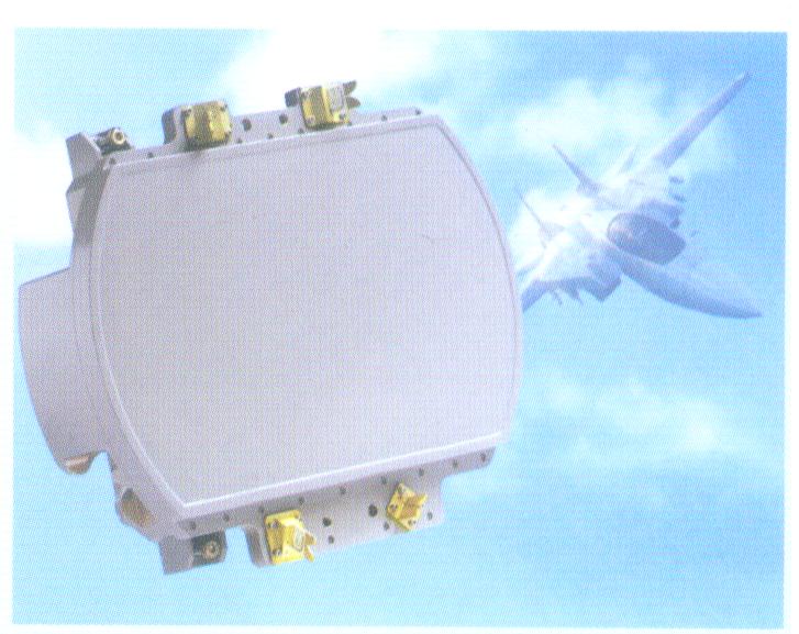

https://twitter.com/ReviewVayu/status/1 ... 69504?s=20 ---> JUST IN! HAL signs contract with IAI ELTA for AESA Radar: The Avionics Division, Hyderabad has entered into a contract with IAI ELTA, Israel for manufacture/supply of AESA Radar (total of 54) for Jaguar DARIN III upgrade aircraft under the Transfer of Technology. (poor quality pix)
https://twitter.com/ReviewVayu/status/1 ... 30337?s=20 ----> As part of TOT, HAL will manufacture Gallium Arsenide-based Trans Receiver (T/R) Elements of Radar Antenna. Also, Transfer of Design Tech like antenna with different configurations, development of Radar Processor application software/Low Voltage Current Source are also ensured.

fanne wrote:can anyone more knowledgeable help, what is the tot here?
Manufacture of GaN-based (gallium) chips for AESA.
Posts: 9207

Re: Indian Air Force News & Discussion - 15 Dec 2016
2052 is GaAs based TRM.
We don't GaN from Israel, as we already have them.
There is a nice little TRM from BEL, with GaN transmitter & GaAs receiver. a way to reduce cost.
Regarding the ToT, i really don't know what HAL is "producing" in 2052, that too only 50 odd kit.
nam wrote:
We are setting up a foundry? or we are assembling the chips from Israel? What is it? What specifically tot is tehre

the understanding as that we will order 50 -2052 for jags and at least 83 for LCA. So the total number is at least 133 (I would say, something like 150, all said and done). What Tot can be given for this kind of order?
fanne wrote:
We already have a foundry(set up in 95!), where we make GaAs & GaN. I don't know what HAL is going to make.
Posts: 4591
Then why is sjha saying that we need to set up a foundry asap. Is he saying that because the tech is old (1995 vs more current as of now?)

We already make the GAA TR modules for Uttam. Its the backend software that we are still working on. ToT for the 2052 contract will just give us Israeli tech for the GAA TR modules. We can compare with our design and refine.

nam wrote:
We have X-Band GaN TRMs is it ... news to me!!
We have S-Band GaN TRMs at a lab level ... not yet productionised maybe, but we will reach there - but X-Band GaN TRMs??

Prasad wrote:We have GaN xband trmms. That's confirmed.
Oh, at what Gain, max O/P Power and PAe figures?
Being GaN Power density would be very good anyway, so not asking.

The last I remember is we have 10W X band GaN from DRDO. There were also displays by BEL & I think Astra, which were more than 10W(or 20W).
At this moment, it would be quite useful in the ECM domain to have 20W GaN, rather than a radar.
X-band GaN based radars on fighter sized radars offer marginal improvement in performance and not the doubling or tripling of performance they offer in some other applications. The reason for this is that even the current generation GaA based AESA radars are thermally limited in many applications that push the boundaries of SwAP. Not until efforts like DARPA's ICE-COOL materialize into mature systems would you begin to see GaN come in for those applications. Once they do, you'll see a wholesale shift to those for these applications. That is probably 5 or so years away. Until then you'll only see smaller (for this application) shifts from GaAs to GaN for non performance based reasons such as a vendor just changing completely and no longer working with GaA's and trying to align with other systems for commonality sake.
Saying X Watt chip is available in some lab or Y Watt chip in another is meaningless (to the person trying to design a sensor against a specific performance requirement specified by the end-user). Even universities around the world can claim to offer such solutions though they won't go anywhere. When you engineer a system you do so within a certain SWaP consideration and against a performance requirement. If your performance requirements drastically change you may end up in a situation where the technology you desire does not permit you to get to those levels without a fundamental change in the way you design your systems. For thermally challenged applications (AESA's beyond a certain size on fighters are getting there) this means new and novel ways to remove the heat. IF you can't remove the additional heat you take away one of the biggest advantages of switching from GaAs to GaN i.e. you get limited utility from the switch but you pay the full cost in that you may get some basic incremental performance boost but nothing close to what the *new* requirements are likely to be. So it is best to stop thinking about which PA is available in some lab somewhere and think of where the requirements are likely to head.
Does a particular end user want more reliability?..a cheaper sensor so he can buy lot more in bulk?, wants a multi-functional array? (EW/EA features require higher access to power and thermals), or wants a significant increase in sensor performance for traditional roles?. The way the problem/requirements are framed determines the path you choose and what solution is ultimately put together...and not necc. what may be available in a lab or in the S&T community. Answer to some of these questions may indeed lead one to design simpler GaA's based sensors and lower cost via mass production..yet for some of them switching to GaN won't cut it and it requires a fundamental design shift in how airborne radars are designed in order to extract that level of performance. So for those extreme requirements..you aren't limited by the availability (or lack of) of GaN PA's at scale. You are basically limited by the time and effort it is going to take to completely change the way your sensor is designed, built, and integrated into an aircraft. Only then will you get the 50-100% increase in performance that could be possibly via this new technology as is being demonstrated on Ground and naval sensors which don't suffer from this problem to the same extent.
