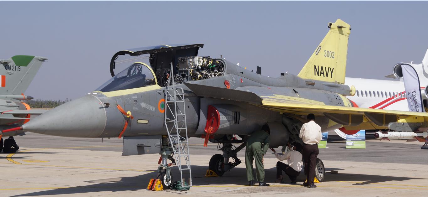

Re: Naval Tejas Mk1/Mk2: News & Discussion - 23 February 2019
Hadn't seen this image of the LCA Navy Mk2 from Aero India 2019 previously.

Kartik, you have linked an image from deaf and dumb forum and it no longer exists.
Posts: 5901
Yes and couldn't find the original from Trishul blog either. Have posted it from another hosting site. Open in a new browser to see it in full size. CFD images give a good idea of what it will really look like. Such a pity that there is very little info on this extremely interesting LCA variant.
Indranil, JayS, please do us all a favour and try to get as wonderful an article as you both wrote for the Tejas and the MWF Mk2 for DDR, for the LCA Navy Mk2.
Such a beauty!

Navy Tejas from AI 2015.
