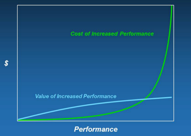

They used a non-mission-capable F-22 for a demo and that blew the blogosphere up (as if the need to keep demo team's aircraft full mission capable is a wise use of $$). But the F-22's RAM applique and treatments are extensive, partly because they spend a fairly significant amount of their training time while supersonic and the Mach 1.8 supercruise capability, while great from a tactical capability, does come at a cost of O&S as those treatments need to be applied frequently and maintained over time and reapplied, sometime at different frequency that varies from fighter to fighter and even location to location (different for aircraft deployed at Tyndall vs those at Alaska for example). This is not atypical for stealth aircraft. Each B-2 is maintained slightly differently from another. At the end of the day, RCS management is an acquired competency which comes with experience of field operating fleets of LO aircraft. The tactical advantage obtained can always be traded away if the cost appears to be not worth it but I have yet to meet someone who does not want the lowest possible RCS and claims that it provides no tactical advantage. This is true for other stuff well hence we do not see subsonic fighters with little to no electronic or mission systems ( those will be the easier from an O&S perspective). Even 4th gen non VLO community has adopted things like Have Glass to squeeze out whatever they can in terms of RCS reduction.
The F-35 traded much of that supersonic (supercruise) envelope so that it stayed within affordability limits and it also was able to leverage Fiber Mat, which, incidentally, was initially developed for follow on F-22 derived aircraft had that production continued to a B, C , D block like the F-15.
Besides RAM, higher design tolerances, lower threshold to declare NMC, and IWB related O&S work, VLO aircraft will always consume more maintaince than non VLO aircraft. What has to be struck is a balance between the various performance parameters and an acceptable procurement and sustainment cost. This has to happen at the time of framing requirements. You can’t demand the lowest signature, the most flexible weapons bay, best in class performance (sustained G's, Mach, and Endurance) an extensive sensor suite and then also demand parity or superiority in affordability compared to legacy fleets. It just doesn’t work that way and this is worth repeating sometime as cost, performance, survivability and lethality should all be part of a trade space when framing effective requirements for a potential weapons system.
As a man much wiser than myself wrote -
Military and the manufacturers need to work together to develop requirements that make sense. In other words, the acquisition philosophy has become “What can we afford?”, or what capabilities can we get for the money we have. As a result, it is necessary to perform performance, schedule, number, and cost trades against a specified “Cost as an Independent Variable.” Developing requirements against a target cost requires deciding which feature to cut if the baseline aircraft design costs more than the cost target or which feature to add if the baseline aircraft design costs less than the cost target. For example, a given survivability requirement against SAM threats can be met at low speed with a stealthy, maneuverable aircraft, or at higher speed with a less stealthy and less maneuverable aircraft. In performing trades on these parameters, if costs must be cut by a particular amount, the question becomes, should the speed, maneuverability, or stealth be reduced? Conversely, if costs can be increased by a particular amount, the question is should speed, maneuverability, or stealth be increased?

Beautiful post,VLO aircraft need to open the door and there will be a role for 4+4.5 gen aircraft to provide sortie rates while stealth drone, smarter missiles all play a part. BDA will probably be fast high flying VLO drones along with satellites freeing up airframes
Re: Advanced Medium Combat Aircraft: News & Discussion - 30 August 2019
Excellent post. Trade off factors are integral to any aerospace design efforts. Typically key parameters have defined trade-off factors so any impact on one parameter, positive or negative can be easily translated to rest of the parameters so one can find balance in various parameters depending on specified requirements. The second plot shows the Trade of factors for example.
brar_w wrote:They used a non-mission-capable F-22 for a demo and that blew the blogosphere up (as if the need to keep demo team's aircraft full mission capable is a wise use of $$). But the F-22's RAM applique and treatments are extensive, partly because they spend a fairly significant amount of their training time while supersonic and the Mach 1.8 supercruise capability, while great from a tactical capability, does come at a cost of O&S as those treatments need to be applied frequently and maintained over time and reapplied, sometime at different frequency that varies from fighter to fighter and even location to location (different for aircraft deployed at Tyndall vs those at Alaska for example). This is not atypical for stealth aircraft. Each B-2 is maintained slightly differently from another. At the end of the day, RCS management is an acquired competency which comes with experience of field operating fleets of LO aircraft. The tactical advantage obtained can always be traded away if the cost appears to be not worth it but I have yet to meet someone who does not want the lowest possible RCS and claims that it provides no tactical advantage. This is true for other stuff well hence we do not see subsonic fighters with little to no electronic or mission systems ( those will be the easier from an O&S perspective). Even 4th gen non VLO community has adopted things like Have Glass to squeeze out whatever they can in terms of RCS reduction.
