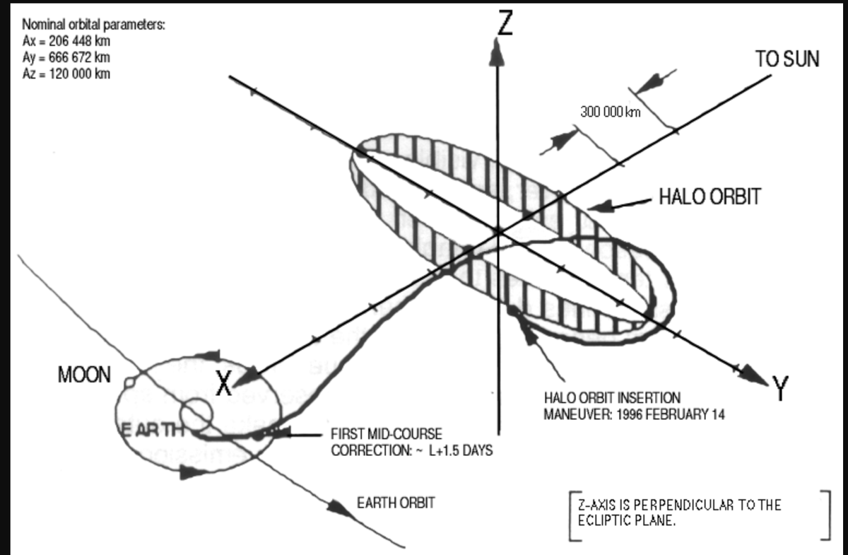

Nice, as usual. Let me add: (Without complex math - but for those who are familiar with ordinary orbits).
Lagrange points like L1 exists for sun-earth type systems, where larger body (sun) is at least about 25 times more massive than smaller body ( Earth). This mass ratio is true for Earth-Moon system too.
For simplicity let us assume circular orbits.. around sun. (Actual orbit of earth is ellipse, which makes math a little complex )
Let us just consider sun (as it is massive). Earth which is about 150,000,000 Km away goest around it in 1 year. so do other planets.
At L1 - If we neglect the effect of the earth - a sat will go faster around sun, completing the orbit in less than an year (like Venus etc).
The effect as seen from earth .. Sat will go 'ahead' of sun in a short time..and keep increasing this angular distance)
But Earth is there. It is smaller than sun but L1 is closer to it so it does have influence... it slows L1 -- sorts of drags it with it..
This slowing down is just right enough to keep the sat at the same position (with respect to sun - as seen from earth)..always on the line joining earth/sun.
We call L1, unstable equilibrium. A slight perturbation - 'drag' from earth will not cancel out the difference in centrifugal forces -- and in some time sat will be nothing but another object in an (elliptical) orbit around sun. Nothing stationary now..
These perturbations are there - due to Jupiter, Venus etc which have their own influences.
A sat in the vicinity of L1 goes through complex orbit -- which , if you look from earth resembles a "halo" or a ring. These are complex orbits (in three dimensions).. some are periodic (Halo) and some are not (Lissajous orbits) but they are bounded.
Some periodic "station keeping" is needed to keep these orbits in check -- The fuel requirement is quite low ( My back of envelop calculations -- delta_V about 0.5 m/s ).. but key point here is 'right thrust' at exactly the right time.. So if you have an excellent navigational system, and control system, you can stay for decades with small amount of fuel.
Most popular articles do not do justice to describe these orbits properly. For example the size of the orbits is of the order of distance of moon from earth...
Here is a figure, I like to use - to represent the orbit in better perspective -- (Taken from SOHO's orbits)
