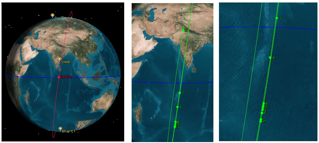

Current position of satellites launched yesterday by PSLV.
First figure shows the location where SCATSAT was inserted in the Red coloured orbit. Then it released other 7 satellites after two burns of 4th stage.
After about a day we can see all those satellites spread out in two orbits.
Officially the satellites have yet to be alloted with their respective names. Currebtly these have been identified alphabetically as objects A to K. Wait! .. How many are A to K? ( There is no I to avoid confusion with 1 ) .. TEN.
But we know that in all 8 satellites were launched then how come there are 10?
The extra two are .. 1. Dual Launch Adapter ( DLA ) which was ejected after first re-burn of 4th stage .. and 2. the 4th stage itself .
Although the satellites are yet to be officially identified their positions imply to identifying at least a few :
Object H is clearly a lonely SCATSAT-1.
Objects J and A are clearly different from the other lot. One is a DLA which was independently ejected and the other one is 4th stage.

Good BBC article, but made a major omission, by not mentioning the two different orbits the satellites were placed into- after all, that's what makes this launch different than the other multi-satellite missions
