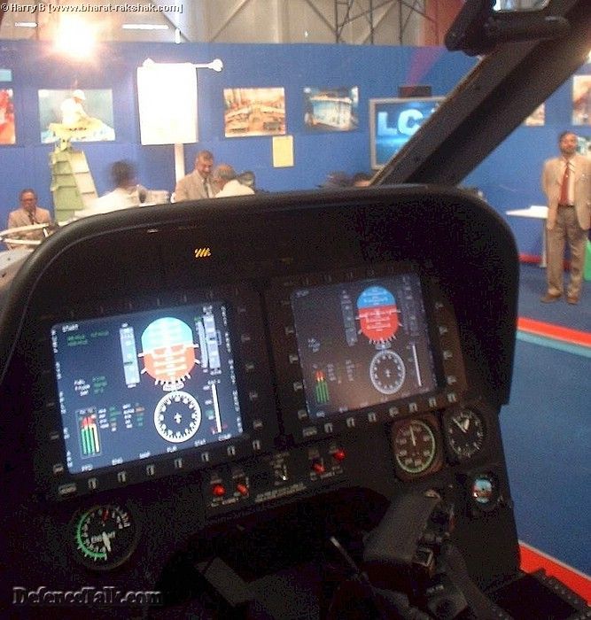

I just found out. MWF will have single wide MFD. Currently layout is being designed at NFTC.
single Large Area Display like the LCA SPORT? Commonality would be fantastic, it'll cut down development time significantly! And if the SPORT actually goes into production, it'll cut down on the costs for putting that into production MWF fighters a bit as well.

I had seen tenders for the 5"X5" displays earlier. Those plans are dropped for sure. HAL is actually in quite advanced stages of their design. At AI'19 they showed it integrated with the simulator. They want to integrate it on a trainer LSP. ADA wants to get FOC on it first. So, this new displays is a surety moving forward.
They have been advertising this on Hawki for the past 3 years.
I mean if you look at the LCH/ALH/So-228 civilian cockpits today, this is not a big jump.
LCH
Dhruv
LUH
Civilian Do-228
HTT-40 (the same will be ported over to IJT)
It's not a big thing for them now.

There are now a number of choices for the large area display. DRDO has floated a TDF project. Many companies are trying to build one. Then Elbit and L3Harris already have it.
The "Smart" display actually gets 'information' and does the rendering within the display itself. You can carry the data over an optical fiber (ARINC 818) or Ethernet. The data will have embedded video (from Radar, FLIR, Camera etc) and symbology data (ARINC 661). The display will render/layer it all together and show on the screen.
MK1A will have 5X5 displays as per chaiwale.

Dileep wrote:There are now a number of choices for the large area display. DRDO has floated a TDF project. Many companies are trying to build one. Then Elbit and L3Harris already have it.
By the Smart display you mean "SMFD" I suppose. Good that you explained what it exactly meant. I was wondering. HAL had a tender out for MK1A SMFD IIRC.
I reconfirmed today . MWF will have a single large MFD.

The LAD have two independent displays (and display controllers) behind a single glass sheet. So, the only common failure mode is the glass breaking, but if your MFD glass sheet breaks, you have worse problems already.
The HUD gives redundancy if both sides of the LAD fail. You can actually stream the critical flight control displays to the HUD and allow to fly home safe. The old scheme with 3 MFDs had quadruple redundancy. The LAD gets triple.
Then there is HMD as well.
Posts: 21751
nachiket wrote:What exactly is the advantage of having a single large MFD vs 3 smaller individually configurable ones?
A pilot can customize his view during different phases of the mission. During critical phases of the mission it is crucial that the pilot focuses more on the mission than on flying the aircraft.
See this video from 4:30. Group Captain HVT Thakur (retd) is moving from one screen view to the next at a touch.
Posts: 5906
Dileep wrote:The LAD have two independent displays (and display controllers) behind a single glass sheet. So, the only common failure mode is the glass breaking, but if your MFD glass sheet breaks, you have worse problems already.
Thanks for the info Dileep. So the HUD and HMDS could also provide backup in case there is a catastrophic failure of the LAD.
