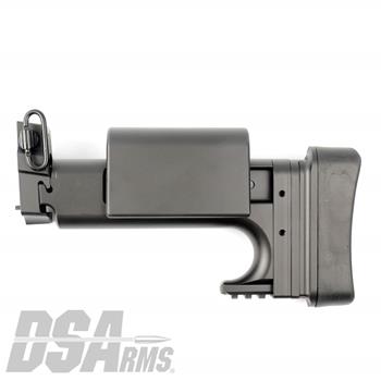

Manish just loook at the video again.
Alao please look at a vanilla FNFAL upper and lower receiver and the butt.
Then you will know what i am talking about in terms of creative thinking.
We spent 10 years on the INSAS.
All thesee questions around recoil. Accuracy, range etc are tradeoffs.
I like the DSA approach to the FN.
A good weapon reinvented.
It may be a.little noisier but 7.62s are going to be that.
It will have a bigger recoil but relative to what?
Ok here is something for you. Look at the cocking handle on Ofb Insas and look at front plastics and tell me the risks but also of the ergonomics.

Manish,Manish_P wrote:Tradeoffs - exactly that, sir.
Ah, i think i now have a better understanding of your POV.. and you haven't even touched on the internals and metallurgyLook at the cocking handle on Ofb Insas
The folding know on the charging handle (cocking handle) itself is borrowed from the FNFAL (inch pattern). however then could have moved it to the upper receiver area .this would have freed up the entire front area (in front of the receiver assembly) for rails but also made the plastics body fit better.
But the charging handle where it is now means that it is less ergonomic, in my view. if it started closer to the upper receiver then the left hand of a right handed shooter has to extend less (hence a fraction quicker) - but that is just my view.
Why cannot the front picatinny rail be a part of the gas tube?
Also look at the magazine well - could it be extended out a bit to act as a guide?
JMT...I am not a small arms expert by any means.

Excellent modification of awesome fn/fal sir :
7.62 ×51 mm DMR in service, a variant of SLR 1A1 Battle Rifle
https://twitter.com/shatrujeet009/statu ... 9592702977
I think with the big surplus of these in stock we can still have excellent rifle with modifications that we need in great numbers. Even though its an old design but highly lethal, proven and reliable (and in stock). I checked online there are some excellent modifications available that make it current and people who own one swear by it today on these upgraded rifles.

Manish for that stock to be used what internals in the FN FAL need to ne modified?
Krishna_krishna that was again half baked. As a DMR ok but to changs to asault rifle something else needed changing.
Re: Small Arms Thread
Actually quite a bit.. bolt carrier, lower receiver, top cover, recoil spring assembly, rear sight, pivoting stock assembly...
Is it worth it? For the enthusiasts maybe, for the soldier he is probably better off with a dedicated rifle for his designated role.
JMT
JMT
Actually what dsa did was to modify the bolt carrier. In the original fn design the bolt carrier had a rod at the end which along with the recoil spring went into the stock.
To remove stock means a mod to the recoil spring mechanism.
There is a vid on the dsa sight and its pretty easy. I think they replaced the bolt carrier.
The lower receiver no change.
Anyhow the idea is not to recondition but to use the fnfal mechanism for new.
The top cover needs change just for rails.the way it fits is the same as before - almost.
