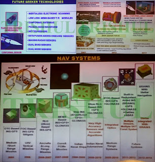

Cross Post :-
Seeker Technology 1
Seeker Technology 2
These are pics of some brochures posted on Trishul Blog. These brochures seem to give lot of information about work being done or being contemplated on IR and RF seeker and more particular on IR "detectors" which in my personal view is one of the major deficiencies in Indian military industrial complex. Can someone interpret the info on these brochures and explain??

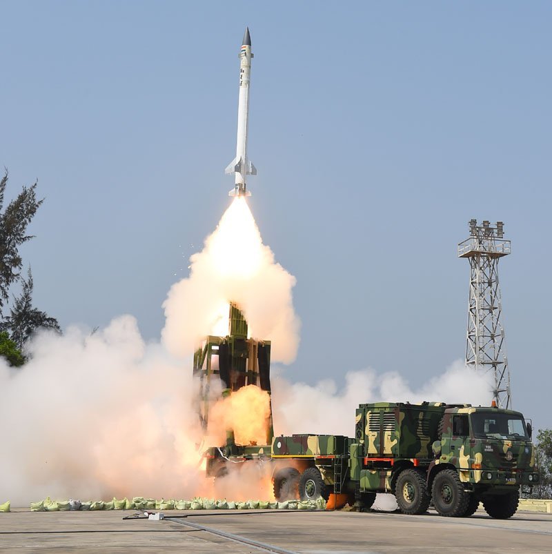

A couple of Hi-Res photos from PIB. Click the photo and it will blow up.
1.A view of the Target Missile used by DRDO in the successful test firing of the Advanced Area Defence Endo-Atmospheric Interceptor Missile, at Abdul Kalam Island, Odisha, on March 01, 2017.
CNR :94047 Photo ID :99432:
Clicky Target Missile
2.Take off view of the Advanced Area Defence Endo-Atmospheric Interceptor Missile of the DRDO successfully test fired, at Abdul Kalam Island, Odisha, on March 01, 2017.
CNR :94046 Photo ID :99431:
Clicky AAD Endo Atmospheric Interceptor
