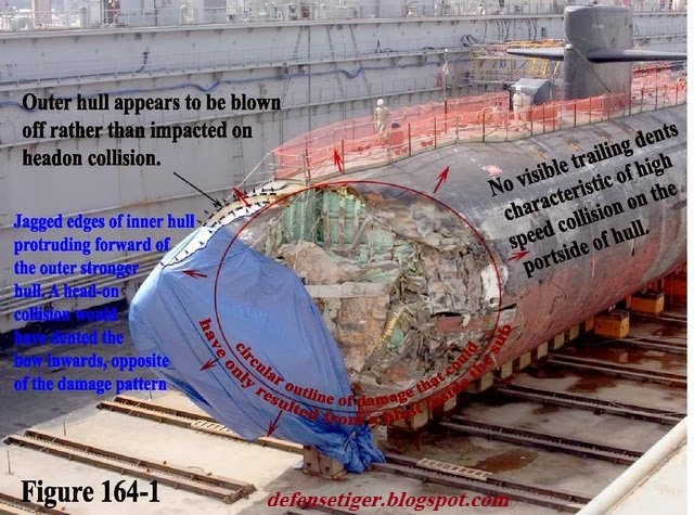

http://1.bp.blogspot.com/-T8oxsi6C2As/U ... g164-1.jpg
The san francisco ssn 771 was repaired by replacing her bow section with a newly retired sister submarine. She is doing fine and due to be retired in 2017 after a 27 year career

As seen in ssn 771 they cut off the front section of sub and replaced with new. We could build or order a new front section for srakshak and fit it out in vizag

San Francisco is a different case. If you carefully see what happened, they cut out the entire front modules ( ballast tank and sonar ) (the hull wasn't punctured, no equipment flooding happened, the sub wasn't flooded etc, no other equipment required replacement) from a sister sub and replaced those. Unfortunately the work on SR is orders of magnitude more than the SF. SO the SR is a pure hull write off / museum piece / structural learning test specimen / donated to the Madrassas for analysis (choose your pick).
