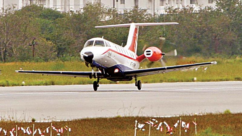

JayS wrote:Re Pusher config in Saras, the discussion that was going on in RnD thread. I think folks are hyperventilating over a non-issue. Rear mounted engines make a lot of sense for smaller aircraft like Saras. From there to pusher config is only a small step. Any config chosen would have pros and cons anyway and cons would need to be dealt with. Only designers would know all trade offs made.
As such its in NAL's DNA to go for TFTA solutions. Its a premier Aerospace "Lab" of India. They know they can deal with it. If one wanted proper commercial project out of Saras, NAL was a wrong choice for it always. To their credit, at least they dreamt of building an aircraft like Saras all by themselves without much background (and developed some awesome technology in composite wing making for example) when no one would touch it by even a mile long pole. And its not like GOI has flooded the project with funds. They have been running on fumes.
read the saras accident report.
The very same one where three IAF people died senselessly because of configuration management issues.
locals shot phone videos of the three injured crew alive and burning in the wreckage
someone should have been jailed at this premier Aerospace "Lab" of India, as you call it.
Sir,
Did you read that report? I read it front to back, multiple times. There was lacuna on behalf of NAL and ASTE about following flight testing procedures, but no design fault was found.
The test was to switch off both engines and relight. After turning off the engines, the pilots did not feather the propeller and followed incorrect light up sequence. Consequently, the propellers kept windmilling increasingly drag immensely. It is like dragging a disk through air. This led to very low glide ratio and eventual departure.
The reason for this pilot-error was attributed to the change of engine and its relight sequence. I can’t understand where is the design flaw. Also, why should NAL scientist be hanged because locals were taking pictures/videos?
As Jay said, pusher props are not any more technologically challenging than tractors. And as Karan said NAL went down this path because of the initial tie up with the Russian design agency.
Flight testing and crashing go hand in hand. Indian flight testing has been relatively event free.

Sirji,
I would not have commented without reading the report, multiple times, as you say.
Where did I say "design fault"??
IIRC, there was, however, some rumbling of some reports of the tail not having enough authority per some european consultant who was asked to review.
I specifically said configuration management issues which were directly responsible for the fatalities.
A full fledged configuration audit is both mandatory and inescapable before release of any aircraft for tests. If only it had been done, the fatal mistake of not providing updated and correct in-flight shutdown and relight procedures would not have happened. The previous documentation should have been destroyed and a record of its destruction should have been produced during the audit. This was not done. The holes in the swiss cheese are beginning to line up now.
Families were destroyed because some ignorant dolt did not do his job and some idiot supervisor did not bother to check and someone did not audit the processes properly.
In my book, all three should have been sacked as well as jailed. What about the bereaved families??
so the design was outsourced, the flight testing was outsourced, who really was the owner of the project ?? Anyone?? someone?? or no one??
There was TOTAL lack of leadership as well as ownership all around.
The holes in the swiss cheese have completely lined up now. The fatality is only minutes away and it is unstoppable.
The ASTE crew followed precisely the procedures given to them in writing by NAL.
and these procedures were WRONG and it was these wrong procedures that killed them.
So the engines were changed but the documentation was not??
such outstanding leadership/ownership at this premier Aerospace "Lab" of India??
and finally, pilot error?? really??
That is really one "politically correct" investigation report, no??
I could never be so casual about flight testing and crashing going hand in hand. The first time after one picks pieces of crew from any crash site, all casualness just vanishes forever and that's true for most people. Sorry for the crude language.
Apart from clean wings the pusher configuration will have a much smaller tendency to yaw and therefore more easily controllable in case of single engine failure. Cabin noise is an added bonus but not critical.

The report mentioned control problems (and described it in detail). Does anyone know what was the source of the aircraft control issue with one engine running? The report gives a long list of the issues faced-with a lot of specifics, and one assumes that most or all of these were acted upon and changes made to configuration. A Hindu article (Sep 2017) mentions 10 modifications were done to 'improve pilot control' and 'agility'. There is no specifics as to what was modified.
SriKumar wrote:The report mentioned control problems (and described it in detail). Does anyone know what was the source of the aircraft control issue with one engine running? The report gives a long list of the issues faced-with a lot of specifics, and one assumes that most or all of these were acted upon and changes made to configuration. A Hindu article (Sep 2017) mentions 10 modifications were done to 'improve pilot control' and 'agility'. There is no specifics as to what was modified.
If I remember right - it was supposed to be a test of shutting down one engine and there was a serious error in the procedure for doing that led to the accident. My memory of detail is vague - the report is out there somewhere but I think it was something like this:
Shutting down one engine obviously causes asymmetric thrust leading to yawing, so the procedure for shutting down included feathering the prop of the engine to be shut down. IIIRC what actually happened was that the blades were not feathered fully due to a procedural issue with that engine-prop combination so the shut down engine actually acted like a sail while the other engine continued to provide thrust leading to loss of control. This detail may be all wrong so please don't take it as the last word. I will try and locate the original report.

Its online and I went through it recently.....a LOT of detail. And there are several reasons/factors given- about 5 to 10 (certainly more than 2 or 3). The Conclusions section lists them all, plus some other problematic issues not contributing to the cause of the final event. One thing that was not clearly described was the cause/reason for sudden and significant loss of altitude (not yawing) after shut-down of one engine. They speculate about a downward force. And there was something about 'side-slipping' by 22 degrees. In any case, the sudden loss of altitude severely reduced the time for recovery. I am not sure what has been modified in the latest configuration to address this point. Certainly, there is clarity now about the feathering aspect.

Chetak sir,
I understand your emotions and share it. But discussing this is below us. Essentially, you and me are sitting on the fence and passing sanctimonious comments over the dead bodies of three young men about whose fault was it. The men who died and the men whose heads you now ask for were friends who worked together on a daily basis. You are suggesting that the latter did not care for the formers' lives enough?
I don't intend to pin the fault on anybody. I said pilot error because the report said so. Indeed, there were many slip ups by various parties within ASTE/NAL/CEMILAC/DGCA and even the pilots. Did NAL cause the accident? Here's why I say no.
1. You say that NAL did not provide the right documentation for relight. This is factually wrong. There were no old documents to be destroyed and no new documents to be provided. NAL did not suspect that it could be a propeller problem. They contacted P&W about relight prior to the test. P&W said that the engine can restart in any propeller setting. Feathering was at pilot's discretion. NAL didn't realize that there was a quirk left. So, although they were in constant contact with MT (propeller OEM), they did not inquire about this and MT did not tell them anything. The outcome of this series of human error was one lever in the wrong position, at the wrong time. The accident report pins this as the only error on the management part which led to the accident: inability to provide clear relight procedure.
2. Saras is the first civilian aircraft that India is flight testing and certifying. ASTE/Cemilac/NAL/DGCA/pilots: everybody is learning on the job. The PD (from NAL) was understandably risk averse and categorically briefed the pilots to return if the first relight attempt failed.
It has been observed from the records and statements th at pre-flight briefing meeting was done in the afternoon of 6.3.2009 prior to the test flight 49 in which NAL and ASTE took part of it . This meeting covered SOP for the flight, aircraft serviceability, configuration limits, test points, and test sequenc e etc as per the test program. Flight crew were also present. It is also understood that at the end of the briefing the pilots were specifically told by FTD that in case of any problem during the relight attempt, the engine should be switched off, propeller feathered and single engine landing executed. No effort should be made to try the relight at second time. This was also repeated to them orally near the aircraft before the crew got into the aircraft.
The Control tower inquired at the first signs of trouble (mismatch of telemetry altitude and pilots readout). The flight test engineer asked the pilots to abort testing and return. He was hilariously replied, "there is a road for the emergency".
Crew were also not responding to the doubts raised by FTD on three occasions even at one stage after the initiation of first relighting at about 37 secs prior to crash. FTD also failed to call for the aborting off flight after the abnormal telemetry link as well as abnormal flight situation including rapid loss of predetermined height and not getting response from the pilot at critical stages.
Similarly ASTE supervisor also failed in his responsibilities for flight safety in co -ordination with FTD as the situation warranted. It is also informed that alongwith FTD Wg Cdr Jaiswal,Test pilot -Saras,Wg Cdr G.D.singh, FTE_Saras were also monitoring the flight at Telemetry. They also failed to advise FTD for calling off the flight seeing the abnormal situation in the monitor.
Therefore, to ask for the heads of NAL's employees only is grossly unfair
3. Inadequate rudder authority is also misrepresented on many reports. Saras's rudder is in accordance to the FAR-23 standards. But for the purposes of the testing (like the one above), it was at the limit which is what the accident report highlighted. PT1N has a larger rudder. NAL also adopted many other recommendations of the accident report as well. But none of them are design flaws!
4. The accident report outlines many missed documentations on NAL's behalf. But none of them are reasons for the crash.

Now, I want to return to some technical discussions. For the people saying that Saras is more prone to FOD damage than a high wing pusher.
Imagine an aircraft with a high wing. Would the engines have been any higher?
At what angle of attack would the propeller touch the ground?
Would other parts of the fuselage touch the runway before the propellers?
I have problem with Saras as a commuter. Is a separate luggage loading door even possible? Ability to use the space behind the rear pressure bulkhead would have been awesome, but most likely improbable.

Indranil ji,
I wish that I could reply without compromising sources on an open forum and also keep in mind that baboo(n)s and reports are very compatible bedfellows.
My take is very different from yours. Pilot error, it most certainly was not.
If it were up to me, I would have taken the heads without a second thought.
Talk about holes in the swiss cheese lining up. This is a classic case.
BTW, a new and more powerful engine, larger props, significantly higher torque and yet the basic question of rudder authority was never seriously investigated and now, voila, the rudder has miraculously become larger??
and yes, even after all these years, dead crew upsets me, wherever, whenever and however.
Just making things "idiot proof" and then sitting back is never the answer, eternal vigil is, because most unexpectedly, and in a black swan kind of way, a new and improved idiot always pops up.
Incidentally, most of the things in the report should have been discovered and corrected by NAL in any mundane audit. Like I said, leadership and ownership.
Finally, in any long gestation project, especially an ab initio aviation project, it would do well to remember the eternal truth:

shiv wrote: Apart from clean wings the pusher configuration will have a much smaller tendency to yaw and therefore more easily controllable in case of single engine failure. Cabin noise is an added bonus but not critical.
Word for word, the above is also identically true for a tractor configuration with similar tail mounted engines.
The Boeing 727, for instance, no??
Jet is a different issue. For a short haul feederliner prop is a good choice.
Once you decide on clean wings the engines must go on fuselage sides (if your design is not single engine). The only practical available space is the rear fuselage. The choice for prop has to be between puller prop which will stick out in front, or pusher sticking out at back. Of these pusher is better because access to doors and cargo hatches on fuselage sides will be blocked by a puller prop but not by pusher.

I couldn’t help noticing that the pushers that Shiv posted all look like Sci-Fi devices — except the Saras. They also have canards — except the Saras
So I, at risk of sounding like an idiot, did more trusty googling.
https://en.m.wikipedia.org/wiki/Pusher_configuration
A pusher design with an empennage behind the propeller is structurally more complex than a similar tractor type. The increased weight and drag degrades performance compared with a similar tractor type. Modern aerodynamic knowledge and construction methods may reduce but never eliminate the difference.
Due to a generally high thrust line (needed for propeller ground clearance), negative (down) pitching moment and sometimes absence of prop-wash over the tail, higher speed and longer roll is required for takeoff compared to tractor aircraft.
Due to the generally high thrust line (aft propeller/ ground clearance), a low wing pusher layout may suffer pitch changes with power variation (pitch/power coupling).
The propeller passes through the fuselage wake, wing and other flight surface downwashes - moving asymmetrically through a disk of irregular airspeed. This reduces propeller efficiency and causes vibration inducing structural propeller fatigue and noise.
Prop efficiency is usually at least 2-5 % less and in some cases more than 15% less than an equivalent tractor installation. Fullscale wind tunnel investigation of the canard Rutan VariEze showed a propeller efficiency of 0.75 compared to 0.85 for a tractor configuration - a loss of 12%.
Now, the disadvantages listed above have nothing to do with the accident.
But they do indicate that NAL perhaps chose a harder design than necessary for their first project? The configuration’s affect on the propeller’s efficiency along with the weight penalty imposed by it cut down on the margin of error.
Less power, more weight, not to mention pitch issues mean the designer must work harder to overcome those inherent issues? Again, the above examples of the other pushers are engineered like fighter jets (complete with canards.) The Saras look decidedly conventional save for the location of the props.
Sir, which of these apply to the Saras config. Saras’s props don’t lie in either the fuselage wake or that of the wing.
Also, for non canard equivalent look up the Vector 123 and Duet Saras.

chola wrote: A pusher design with an empennage behind the propeller is structurally more complex than a similar tractor type. The increased weight and drag degrades performance compared with a similar tractor type. Modern aerodynamic knowledge and construction methods may reduce but never eliminate the difference.
Not Saras: here is an example of your quote
https://flyawaysimulation.com/media/ima ... 2-fsx1.jpg
chola wrote: Due to a generally high thrust line (needed for propeller ground clearance), negative (down) pitching moment and sometimes absence of prop-wash over the tail, higher speed and longer roll is required for takeoff compared to tractor aircraft.
chola wrote:The propeller passes through the fuselage wake, wing and other flight surface downwashes - moving asymmetrically through a disk of irregular airspeed. This reduces propeller efficiency and causes vibration inducing structural propeller fatigue and noise.
Not Saras. Here is an example of your quote:
https://i.ytimg.com/vi/GsJagEM6E6g/hqdefault.jpg
chola wrote: Prop efficiency is usually at least 2-5 % less and in some cases more than 15% less than an equivalent tractor installation. Fullscale wind tunnel investigation of the canard Rutan VariEze showed a propeller efficiency of 0.75 compared to 0.85 for a tractor configuration - a loss of 12%.
Again. Nothing to do with the design of Saras. If you think some images look like SciFi please Google for Burt Rutan Aircraft
In fact India's Rustom I is a variant of Rutan VariEze
https://www.youtube.com/watch?v=seGfyTp3n1s
