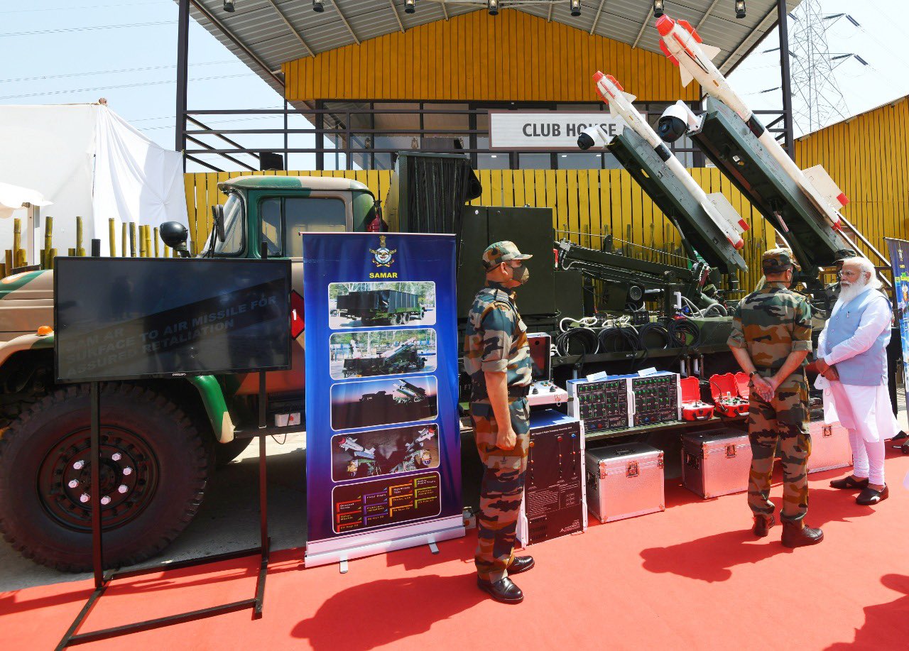

https://twitter.com/VinodDX9/status/136 ... 94976?s=20 ---> SAMAR - Surface to Air Missile for Assured Retaliation.
