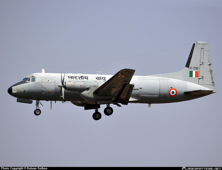

Philip wrote:Get both.C-295 new-gen birds and upgrade as many airworthy AVROs.The IAF's logistic capability increases proportionate to the threat from the Sino- Pak axis.
" All hands to the pump", is an old saying.In a crisis even civil birds are utilised for troop movements. Old crocks still have their potential, but this should not be a devious move to scuttle the Tata- Airbus JV in the pvt. sector.DPSUs are scared sh*tless of being exposed by more competitive and productive pvt. sector majors.
I agree. But, frankly the C295 has gone NOWHERE!!!
Under the current situation, modernizing the 748s make perfect sense. With modern engines, avionics and cockpit, the Avros can serve us well. They have rough field and STOL capability from Day 1 which could be great for the advanced landing strips. Although it looks nice to land IL-78s and C-17s at these ALGs, their operations cannot be sustained from these strips. The strip itself takes a beating after very few landings of these heavies. The logistics to handle such large aircraft is not present. Lighter aircrafts with rough field capabilities like the 748s are ideal. The only problem is Avro's cargo doors which don't allow access from ground. IAF has flagged this one of the prime reasons for non-utilization of these assets. The intial Andover prototypes were modified from existing 748s. Can HAL do the same for all the 748s in our inventory (with or without BAe consultancy). IMHO, these are the incremental projects that ideal for HAL's budding designers. It will have immense practical use.
Also these are perfect for the Indian Navy/Coast guard medium maritime patrol aircraft. Between HAL (maritime Do-228s) and CABS (Netra's sensor placement experience), they have the ability to come up with this aircraft in 5 years.
Re: Indian Military Aviation - 21 Sept 2015
do you mean our hs748 lacks the cargo door?
how much of paylaod/people can it take into a ALG? more than AN32 which has advantage of oversized engine to our high alt need?

The Andovers have a cargo ramp. The 748s (in IAF) have oversized cargo doors at the rear. To load through this door efficiently, one has to use pallet handlers which may not be present at ALGs.
The new engines that HAL is seeking would give the 748s similar payload capability as the 32s. The ALGs are actually not at very high altitudes.

Yes.AVROs without rear ramps will be more difficult to handle large cargo than our AN-32s and other aircraft with rear ramps capable of carrying light vehicles.AVROs wod be best as troop transports, para- dropping,, etc.

Philip wrote:Yes.AVROs without rear ramps will be more difficult to handle large cargo than our AN-32s and other aircraft with rear ramps capable of carrying light vehicles.AVROs wod be best as troop transports, para- dropping,, etc.
Low set tail plane makes it very risky for paradropping.
Otoh, I believe it's a presurrized cabin.
Also I think tail ramp is structurally possible. Albeit fuselage is too high (that is the reason it's tail conic is not chopped slant, as at max AOA tail is too high to risk touching runway. Very unlike AN12, 32, IL76, C17, Caribou )

HAridasji, you are right. You are actually describing the differences between the 748 and the Andover. Hence, my suggestion.

Sir, from what I know, the HS 748, the cg is too far forward to encourage rare ramp ops. From memory, cabin tube seemed narrower than "anna battis" and is considerably slower. My flight from Guwahati to Kolkata on an AVRO (long back) was 03 hrs plus. Anna battis (AN 32) has a great short field performance. I don't know about that viz. AVRO.
Hi Deejay,
Always a pleasure to discuss things with the knowledgeable.
1. I have not heard about the CG problem. There may be truth to it. But that is easily fixable if the empennage is going to be remodeled. Anyways, adding the ramp and its mechanism is going to add weight to the back.
2. The HS748 was designed for rough field and STOL performance from day one. That was the selling point of the Avro. The very first deliveries to South American and African countries. In fact, the the STOL features of the 748 and the 32 are very similar. Long wing, single long slotted flap, engine exhaust over the wing, etc.
3. The speed will not be a problem after the new engine-propeller fix. If they go for a 5 blade propeller, which I highly suspect will be the case, then won't need to move the engine mount. The later was the case with the Andover, which gave rise to a lot of changes.
4. I think the second source of major changes between the Andover and the HS748 was the kneeling LGs. I don't think that is needed either. When the fuselage ramp is open, it need not reach the ground. The difference of a few feet can be made up with a small ground based ramp.
5. A total of 9 HS748s were modified to the Andover variant, so it is certainly possible.

deejay wrote:Sir, from what I know, the HS 748, the cg is too far forward to encourage rare ramp ops. From memory, cabin tube seemed narrower than "anna battis" and is considerably slower. My flight from Guwahati to Kolkata on an AVRO (long back) was 03 hrs plus. Anna battis (AN 32) has a great short field performance. I don't know about that viz. AVRO.
Hi Deejay,
Any backward movement of CG will also have to be accompanied by commensurate shift in Center of Lift CL. Wings are not moving anywhere. So all that change will have to come from tail. Its doable theoretically, but in practice it may get into the spiral of "too big tail needed to move the CL but all that weight moves CG further downstream".
PS: Question - Is HS 748 designed for airdrop..? Someone mentioned its pressurized. If its not designed to open doors at altitude mid air, then making it do so would need further structural modifications.

Jay,
We know that this conversion can be done and works quite well. So, I don't think that they need to change the CG too much. The Andover was used for paradrops. No less than Price Charles jumped off it.
The following link has a good video of STOL operations

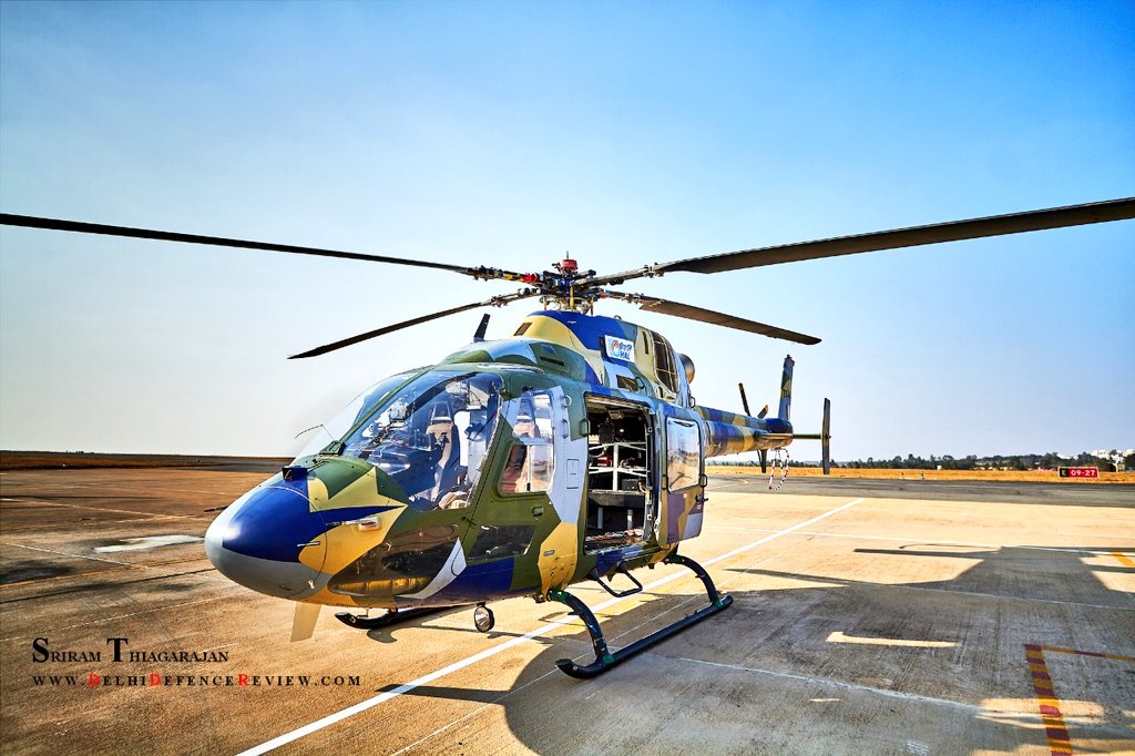

Delhi Defence Review @delhidefence
We are Twenty Five Days away from #AeroIndia2019
Here's the Ultra Light Helicopter of @HALHQBLR sitting in the Bengaluru sun, looking to enter operational service in months to come.
sarabpal.s
Posts: 348
Joined: 13 Sep 2008 22:04
Post by sarabpal.s »
Only one question can we weaponise and optimise ULH for plain of western border, may carry equal load as Rudra or lCH
Posts: 14873
Luh is meant to replace Cheetahs and Cheetals and needs to be inducted fast. LCH is a dedicated weaponised platform. Weaponised variants can wait, better to induct the transport ones with flares and infra red decoy systems to have defense against manpads in numbers first.

sarabpal.s
Posts: 348
Aditya_V wrote:Weaponised variants can wait,
But we can have own cobras, LCH is optimised for highest ceilings dedicated to east and siachin so the load compromise, but ULH imho carry same weight as LCH if optimised for sea surface fighting
