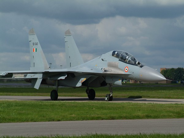

Re: Indian Air Force News & Discussion - 15 Dec 2016
ldev wrote:
Karan M wrote:
What the Raven is seeking to develop, was already deployed on the Su-30 and especially the Su-35 quite sometime back.
What the Raven brings to the table is a whole host of Western and Israeli missiles and PGM to the table from AAMRAAMs to the Meteor to SCALP/Storm Shadow, Asraam, Python 5 and India can also negotiate to integrate Astra, NGARM (when ready), Brahmos and Nirbhay or it's successor. Yes the Irbis E claims a scan angle of 120 degrees vs 100 degrees for the Raven. What Irbis E does is lock India into the Russian weapons system in perpetuity, no other choice e.g. you want a long range AAM, have to ask the Russians for the RVV-BD. Integrate the Raven and you can get the Meteor, AMRAAM 120d if the US will sell that variant or the Astra 2 when ready.
Again, incorrect. The scan angle matters a ton for BVR combat. Did you even see the image I posted? The radar merely provides targeting information. The weapons can be guided in via dedicated datalinks unique to the specific AAM. Do you think the Bars locked in India to Russian weapons for all perpetuity? How do you think its guiding in Astra and how exactly is the IAF planning to integrate ASRAAM which too has a radar cued mode if Russian radars can't provide targeting information to non Russian weapons?
Weapons are NOT = radar availability unless the missile is datalinked via the radar itself. MBDA makes the weapons. US manufacturers make them. Just because you buy a European radar, let alone the fact no NATO supplier will easily countenance handing over a radar set to a Russian manufacturer to integrate, without significant political support and then you will suddenly convince the Americans to hand over AMRAAM - not merely any AMRAAM mind, but AIM-120D. India dropped the idea of taking the Brit SHAR upgrade because the AAMs were AMRAAMs and they were not available to India. We then went with the Israelis who gave us the radar and missile both, but with limitations.
You claim on the one hand the IAF went to trouble to integrate kit onto the Su-30, and then you want non standard items, which don't even exist, namely a Su-30 sized AESA, to be developed, integrated - political, business clearances all be managed somehow, never mind the blacklist, and then weapons will appear along with them. This from a commercial manufacturer, not the DRDO/BEL who just jump at what the IAF wants. Who funds this? Does SAAB own Leonardo?
The same weapons which BTW are sought to be marketed as exclusive to the fighters, so as to give them a competitive edge in the Indian competition, and make them superior to the existing IAF fleet would then be added automatically to this deal. Instead why can't India add them individually as it already can? Do you think we need to buy the CAPTOR-E to think of adding ASRAAM to the Su-30s even today? How do you think that's happening?
And do you seriously think adding a radar this to a fighter is going to be easy and doable in the timeframe envisaged? The EMI/EMC issues, getting the power envelope fixed, and to solve them you want to hand over all the data to an European OEM which also sells all these items worldwide including to Pak? Would the IAF agree?
Here, India is thinking of taking a proven high power FCR which was developed specifically for the Flanker and combining it with its own avionics, or even an upgraded variant of the high power radar the MKI already has, which in most performance parameters matches AESA sets available, but instead we should run after a complex piece of kit which is unique to a platform which is competing for the same piece of the pie, but the associated weapons won't even be guaranteed. How does that figure, exactly?
India has the Astra already, has an Astra Mk2 headed to trials, a SFDR in development, how does purchasing a mere radar give us access to equivalent weapons from the US like the AMRAAM D version, when the radar is European and the weapons are not even integrated on the Gripen?
May be a PESA but those scan angles speak for themselves as does the demonstrated performance, so much so the Russian AF went slow on its Su-57s.
Lol!! The Russians went slow on the SU-57 because they have no money for further development and the current engines they have, the Al-41, the same engine used on the SU-35 (a derivative of the AL-31FP) does not enable the SU-57 to achieve it's design performance numbers. And that is why India for once when it concerns the Russians has been smart and said that the SU-57 will be an off the shelf purchase when it is a mature design and inducted in numbers in the Russian Air Force.
Yes LOL at your inability to deal with the facts as they are. Do you seriously think the engines are all that define the Su-57? That its airframe, its avionics are irrelevant?
The engine on the Su-57 is not the one used on the Su-35. They field the Item 30.
https://www.defenseworld.net/news/25968 ... ful_Engine
The Su-35 engine is the Item 117 which was used to proof test the prototypes and take the program forward. Forget the Item 30, a further variant is planned for the Su-57.
Even as it stands, according to the Russian test pilots, the Su-57 is ahead of the baseline Flanker in kinematics (and why wouldn't it be!), has a much reduced signature and a functional AESA radar and integrated avionics set up which matches whatever the Flanker has, and surpasses it even. But the question the Russians have is this, does it, for the cost, offer them such a generational leap ahead of the latest Flanker so as to move en masse to it, when they can at lower cost add long range capabilities to their Flanker and hence make the airframe more survivable?
The so called kinematics of a new engine are just one small piece of what a Su-57 can offer, but with new LR AAMs, ASMs entering service and a new EW suite plus the Irbis-E, the Su-35 has got a good rework. The Irbis-E is one of the most powerful aircraft radars in existence and likely outperforms the vast majority of worldwide fighter radars bar the similarly sized ones on US F-15s.
Fact is IAF ditched the Su-57 because it had no funds to go for both the Rafale and the Su-57. And it took whatever was already mature and available off the production line asap. But the Su-57 will come, and its very likely we may still end up purchasing the platform.
True as far as the E variant is concerned. And that is why I think the better option is to use the Raven radar and other avionics from Leonardo. Can you imagine the SU-30 with it's payload capacity carrying Amraams, Meteors, Scalp, Astras. It will be a one of kind. That will make the Indian SU-30MKI equivalent to the Israeli F-15 Baz in terms of diverse weapon/sensor integration.
Why does India need the Leonardo radar to make it equivalent to the Baaz when, as things stand we are integrating:
NGARM, SAAW, LRGB, ODL and will also likely integrate the Rudra ASMs
When we have already integrated:
Astra, Spice, Griffin, Brahmos, TBB, Litening 4I, SAR pods
When it already comes with:
KAB-500/1500, Kh-59ME, Kh-29 L/TE, OFAB units apart from R77/R27/R73E
Kindly go back and look at the HAL proposal and understand what they are proposing! Our Su-30s will soon enough exceed the Baaz in weapons diversity with or without any Leonardo, without any comprehensive MLU either as the airframes are anyhow being constantly upgraded.
if Uttam itself is not ready for prime time on the Tejas how many years will it be before the son of Uttam is ready for the SU-30?
Uttam is due for testing and completion in 2 years time. We can very well use a Bars variant or Irbis for the first batch upgrade and then transition to an Uttam variant.
An off the shelf and/or close to maturity radar such as the Raven AESA with the weapons integration capability that it brings will increase the potency of the SU-30 fleet by a factor of who knows how much. It will reduce the pressure on the squadron numbers issue as well.
There is no given the Raven is available, a Su-30 variant will be developed easily (without significant political pressure and incredibly expensive funding) and then come the integration hassles.
About the only thing a well developed AESA can claim is a wider bandwidth performance, better ECCM and ability to generate complex LPI waveforms (but digital RWRs are also becoming common). But is all this even available for an export variant Raven? Will it even make a tactical difference?
How are we not better off putting all that money in Uttam and speeding up its tests when its expressly designed to have those features.

Karan M wrote:Again, incorrect. The scan angle matters a ton for BVR combat. Did you even see the image I posted? The radar merely provides targeting information. The weapons can be guided in via dedicated datalinks unique to the specific AAM. Do you think the Bars locked in India to Russian weapons for all perpetuity? How do you think its guiding in Astra and how exactly is the IAF planning to integrate ASRAAM which too has a radar cued mode if Russian radars can't provide targeting information to non Russian weapons?
AFAIK, ASRAAM being a short range missile the seeker locks on to the target directly on launch and therefore does not need integration with the radar and therefore the SU-30, Tejas etc. can carry the ASRAAM. Meteor being long range on the other hand has a two way link for initial guidance from the aircraft radar on launch before the seeker eventually takes over guidance. That security of that two way link is what MBDA is concerned about and the associated source codes.
You are better informed than me to comment about the Astra integration with Bars. My educated guess is that India already has the Bars source codes.
That is why my preferred solution in the short term is to get a European radar which is already qualified on most NATO munitions. Phase two can always transition to Uttam (when ready) and to Astra 2 (when ready) so as not to present a either/or choice between air combat competitiveness in the present vs long term domestic industrial sustainability. And this IMO would be as applicable, actually more applicable for the Tejas than the SU-30. An LCA with the Thales and Meteor combination would be formidable point defence fighter against both of India's adversaries. As would a Uttam and Astra 2 combination for the Tejas down the road. The IAF would have lapped up the Tejas with a 200 plane order.
This genesis of this discussion was the IAF's acknowledgment post Balakot that the AAMRAAM 120 C5 outranged the RVV-AE. Firstly, given the numerous exercises that the IAF has had over the years with Air Forces having various versions of the AMRAAM I am perplexed as to why and how the IAF was surprised by this fact in February of last year with the dust up between PAF F-16s and the SU-30s. But setting aside that, the more important question is what has been done since then to not only plug the gap but to have a BVR advantage in India's favor. This is important because of what is happening on the China border and the very likely scenario of a two front war with the IAF again going up against the PAF F-16s as well as the PLAAF.
Now the answer may be that India is getting/has got the RVV-SD with a range increase to 110 km vs 80 for the AE. But publicly available information indicates that the domestic (Russian Air Force) version i.e. the RVV-77-1 has a different seeker vs the export variant SD, presumably better? Again AFAIK, AMRAAM, Meteor, Mica, ASRAAM do not have two different seekers for the domestic vs export markets. So I am wary of Russian bait and switch tactics. The true test of the RVV-SD will be when there is another clash either with the PAF or the PLAAF to find out if it actually outranges the AMRAAM 120 C5 and the PL-15.
The IAF chief has stated for the record that the Astra is superior to existing Russian AAMs, ( I presume he meant the RVV-AE). So has the Astra been operationally deployed on the SU-30s?

basant wrote:
Karan M wrote: ...
Sorry sir, couldn't follow. The 'first batch' referred here is Super Sukhoi or some LCA variant?
First batch of the Su-30 MKI upgrade. Use the Bars as the basis. Don't even go for the Irbis unless you must - the PRC has access to its basic architecture (though that's a problem we face with all imports, the middle east is full of US/Euro imports, others have Russian fighters)
Use the time to develop an Uttam variant for the Su-30.
ldev wrote:AFAIK, ASRAAM being a short range missile the seeker locks on to the target directly on launch and therefore does not need integration with the radar and therefore the SU-30, Tejas etc. can carry the ASRAAM.
Nope! All radars have different modes -one of the ones dedicated for WVR is called CCM - close combat mode. In this the radar auto locks/ or is locked by the pilot onto a maneuvering target and passes the data to the WVR missile, to cue its seeker and hence get a quick lock. This is a preferred method for close range combat so the pilot himself does not have to do all the heavy lifting. Apart from that, you have the HMC/S - the missile seeker can be slewed by the helmet mounted sight as well.
Meteor has a single way datalink on the Rafale. Two way offers better data on the missile itself back to the launch aircraft and hence is even better. MBDA is not bothered about the secrecy of the datalink - if it were, India already has the data via the Rafale. The primary issue, plain and simple, is commercial. MBDA France does not want to give up the USP of the Rafale, its Meteor. What key advantage then does a Rafale have over a Su-30 with a Bars that can guide in a Meteor. We are willing to trade in the larger signature with EW (onboard/offboard), long range radar performance and still get a long reach. At a fraction of the cost of buying and inducting an entirely new Rafale. This is the reason why SAAB won't be happy about Leonardo offering India any Raven if they have co-funded its development. When it comes to the radar itself, the challenge is far more complex than integrating a mere weapon. They have to couple it to the weapons control system. Run EMI/EMC tests. At this point you may need to involve the OEMs of all the other subsystems, who happen to be Russian. This, is something NATO may be unhappy with. So the challenge increases. This is also why IAF has been scouting for a LRAAM for the Su-30 for ages, and didn't get the Meteor. Similarly, the Malaysians who were exploring adding Mica to the Su-30 MKM didn't get it either.
You are better informed than me to comment about the Astra integration with Bars. My educated guess is that India already has the Bars source codes. That is why my preferred solution in the short term is to get a European radar which is already qualified on most NATO munitions. Phase two can always transition to Uttam (when ready) and to Astra 2 (when ready) so as not to present a either/or choice between air combat competitiveness in the present vs long term domestic industrial sustainability. And this IMO would be as applicable, actually more applicable for the Tejas than the SU-30. An LCA with the Thales and Meteor combination would be formidable point defence fighter against both of India's adversaries. As would a Uttam and Astra 2 combination for the Tejas down the road. The IAF would have lapped up the Tejas with a 200 plane order.
We have to understand we don't need the radar source codes to add weapons unless the radar is fundamentally incompatible with the weapon. For instance, trying to add a missile which needs very high grade tracking, to one which provides only "coarse" information. In this case you might need to go back to the OEM and say, hey we need you to modify your radar to give us a mode with tracking accuracies of this caliber otherwise our weapons won't work. Another option is to add your own radar, WCS and chuck the original (PRC did this to their homegrown Flankers), to add their own weapons. In our case, we have added Brahmos, Astra, Spice etc to our Flankers. What does this tell us? It tells us we can add our own weapons. Second, it also means the European radar you are referring to per se does not "own" the weapons. They too go through a test and validation process but more importantly, you run against the issues I mentioned previously - commercial and secrecy. Are we comfortable with NATO guys "owning" the radar on the Su-30? There are no easy answers.
They weren't surprised. The media was surprised. See Parrikars comment about why the Rafale was necessary. He clearly mentioned AMRAAM outranged the R77. Today, our Astra outranges their AMRAAM. But tomorrow they will get the PL-15 which outranges the Astra Mk1. Which is why we have a Mk2/SFDR in development, otherwise we will be left scrabbling again.
Astra outmatches the current AMRAAM/SD-10 in service w/PAF. But its only a matter of time before the PL-15 arrives in the western theater.
He said it restores parity. And another very credible source noted its actually a bit superior. As to deployment, if I was the IAF I wouldn't let anyone know unless I had to.
Am I being delusional or IAF has started using IN colors?
Posts: 21676
I believe Tipnis grey is still the standard in use. Photographs can show a different shade due to lens, filters, lighting, angle of sun, etc.
