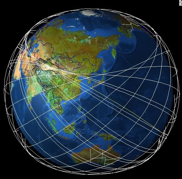

Sorry for a really dumb question, but I really dont know:
Why is a satellite orbit as shown by SSSalvi on the earlier page always "sinusoidal"? Or, how do I interpret the diagram shown ? Are the various "sine waveforms" "phase-shifted" from each other the various tracks of the satellite? Also, isn't it true that the sat can only image a swathe of the area at a time, which is usually like a long rectangular piece? What governs the size of the swathe?
Apologies for dumb questions again...

Tanaji wrote:Sorry for a really dumb question, but I really dont know:
Tanaji-saar
Let us imagine the orbit of any satellite to be circular (this is bogus, but please bear with me). The center of that circle and the center of the earth should coincide (something to do with the fizzics of center of mass but let us leave that aside). Now this lets us have several different orbits. A satellite orbitting from pole to pole for example (IRS satellites do that), or a satellite orbitting perfectly above the equator for example. Let us consider the equator orbit case. If you plot its path on a globe, you would get a Line in SSSalvi's map, exactly the place where the equator would be.
Now let us imagine that the orbit is "inclined". That is the satellite starts off somewhere over Dilli. Now I told you that the center of the circle, which is the orbit of the satellite and the center of the earth should coincide. So now what we have is that the "other side" of the orbit, should be as far below the equator as dilli is above the equator. Somewhat like an orbit that is neither equatorial or polar. Let us assume australia is the "other side". Okay. Now if you plot the orbit on a flat sheet of paper what would you get ? The orbit starts at dilli, passes through calcutta, then through singapore then through australia, till it reaches the southern most tip of australia (which we will assume is as far below the equator as dilli is above the equator) and then rises. So what we get a sinusoidal shape.
So we get a "sine wave".
Now the horizontal swath is determine by the optics. Basically the angle of the lens and the height at which the satellite is orbitting. Think of you with a camera and you want ot photograph a large group of people. What do you do ? You either move back, or you use a lens with a wider angle. Now other things like sensor size, resolution that is needed etc also matter in the size of the swath.

Tanaji, the perfectly polar "still" orbits say, pole to pole drawn with the earth "still or non-rotating" would lie along the longitudes on the globe.
Now rotate the earth underneath the orbit. :) See what happens. The projection of the "still" orbit on the moving earth will make those sinusoidal looking maps for the orbit projection on the earth/globe.
A simpler way of thinking about it is as follows. Imagine a dot on the wheel of a car. Initially let the dot be at the top. Now let the car move forward. What will the path taken by the dot ? The dot is moving forward (because the car is moving forward) at the same time it is moving down (because the wheel is turning). Then it reaches the lowest position and then rises all the way up (all the while moving forward). The shape it traces out will be a sinusoid.
The same thing on a spherical earth is indicated here.
Note following points:
The satellite orbit is seen above the earth's surface ( indicating height of the satellite. )
Under one orbit notice the yellow line which is a 'footprint' traced by the satellite radius passing thru the centre of earth on the surface of earth.
It is those footprints which are shown in the earlier diagram.
Now,
This is a spherical earth and we can't see the back side of earth ... and to see that we have to make a perfectly flexible earth surface ... then cut it from pole to pole on one side and stretch the cut portion to fit the rectangular flat page.
This is where the distortion starts taking place... Equator will lie flat easily on the plane surface but the pole will streeeeeetch to the two ends of the flat surface resulting in different scales at equator and near the poles.
So a circular orbit will be stretched at poles and appear as what you call 'sinusoidal' . Actually I feel it should be a function of secant of lat ( Please correct me experts in maps and projections ) .
That I feel should explain the things to some extent ( as I understand it ).

Posts: 5378
Re: Indian Space Program Discussion
Thank you Anujan and SSSalvi for the nice explanation it really cleared up some doubts.
I think I now understand, this is similar to the case of projecting angular motion on linear surface: imagine a circle that has a radial arm rotating inside it. If one were to project it out one a linear scale like a graph , you would get a sine wave. I suppose this is the same phenomenon.
