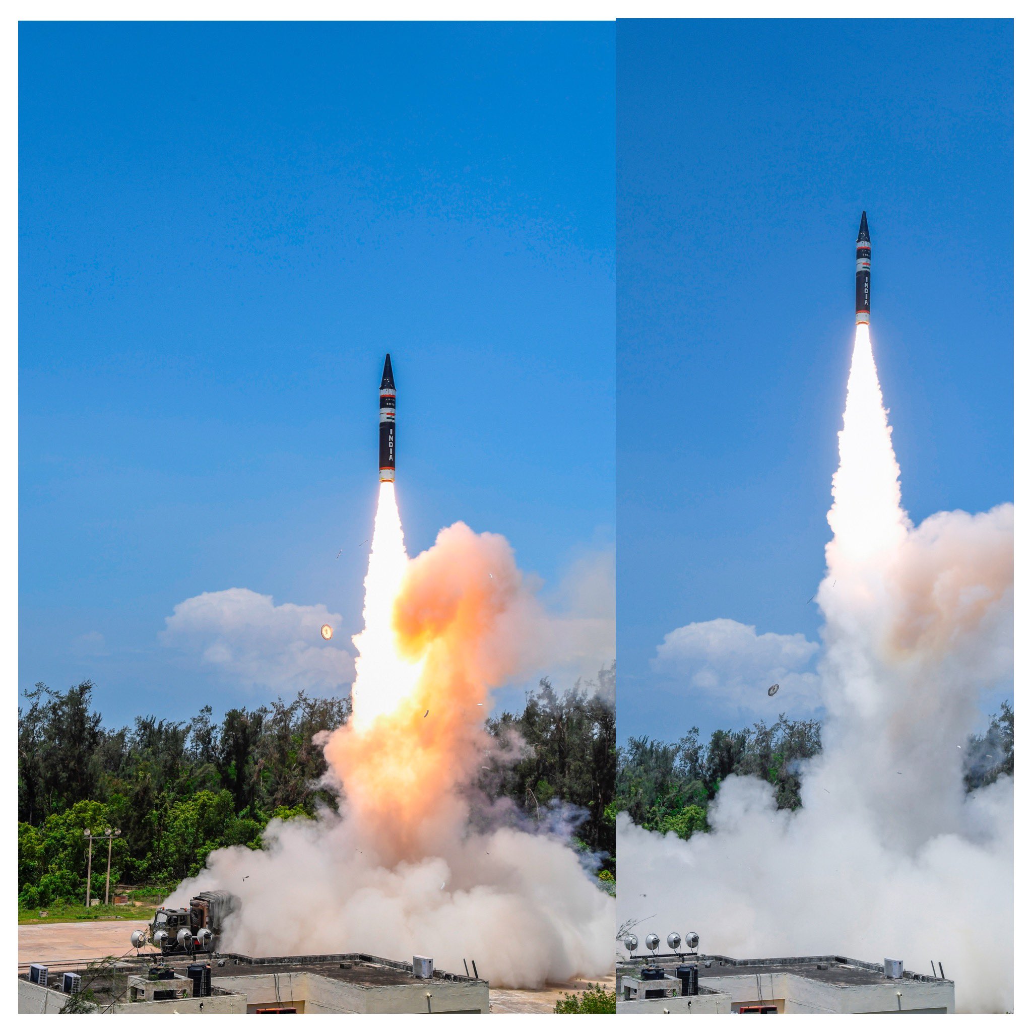

Agni-P: India successfully test-fires new generation of nuke missile - ToI
India on Monday successfully test-fired a new missile in the Agni series known as Agni-P off the coast of Odisha at 10:55am, DRDO officials said.
As per DRDO, Agni-Prime is a new generation advanced variant of the Agni class of missiles.
"Being a canister-launched missile, Agni-P will give the armed forces the requisite operational flexibility to swiftly transport and fire it from anywhere they want. The test at 10.55 met all mission objectives with a high level of accuracy," the DRDO said in a statement.
During the test-fire, various telemetry and radar stations were positioned along the eastern coast tracked and monitored the missile, the DRDO said.
"The missile has followed textbook trajectory, meeting all mission objectives with a high level of accuracy,” the DRDO said in a statement.
The missile, which has a range between 1000km to 2000km, is short and light in comparison with other missiles in this class. New technologies have been incorporated in the new missile, DRDO officials said.
On June 24 and June 25, DRDO had also successfully test-fired an extended range version of indigenously developed Pinaka rocket from MBRL at ITR Chandipur off the coast of Odisha.

Agni Prime is solid fueled, dual stage, all composite missile. The solid propellant is new, might be NEPE based. Both the stages have composite rocket motors. Canister based missile. Maybe more than 1 will be carried on a single 6x6 truck platform. Payload weight and exact total weight is not yet specified, but a range between 1,000 to 2,000 Kms, will cover all of Pak, Tibet and Xinjiang.
I have said this before, and will repeat it. Agni-prime will replace Agni-1 and Agni-II. Agni-IV is already the PRIME successor of Agni-II. Agni-III will also be replaced by Agni-V. Agni-IV and Agni-V will also transition to all composite rocket motors in the future. I don't know, if all the stages of Agni-IV are already composite or not. Agni-II and Agni-III will be phased out, when requisite numbers of other missiles available.
Shaurya might be a silo based missile and I would hazard a guess that a few might have already been deployed in secret silos.

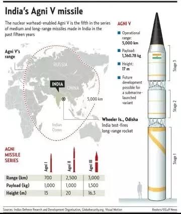

IIRC, Prithvis were supposed to have an accuracy of 1% of CEP. But that was long ago, though I doubt if legacy Prithvis were upgraded. The later variants had improved accuracy, in the range of 25 to 50m.
Agni V had a CEP of <100 mtrs. Expect Agni Prime's CEP to be ~30m.

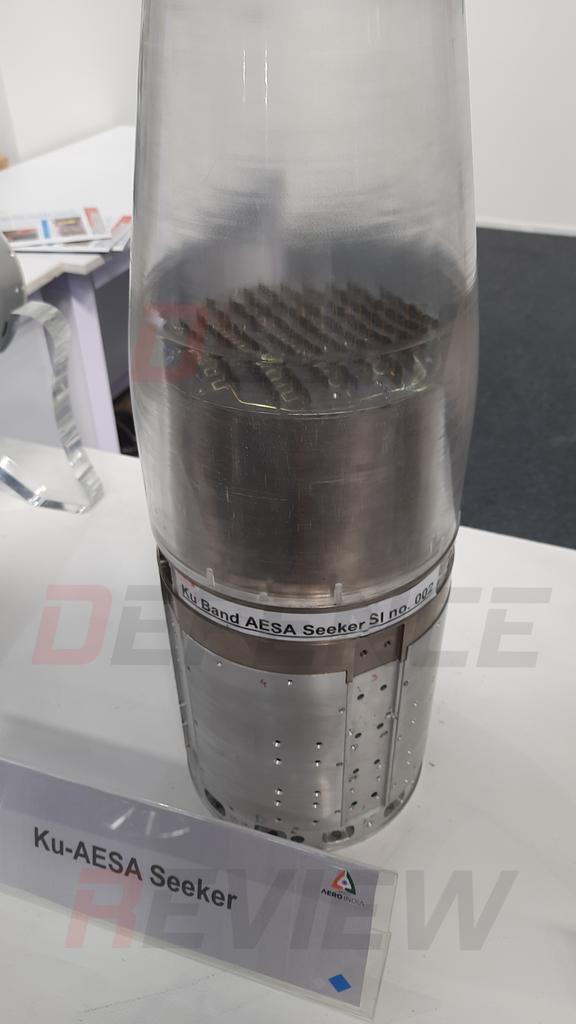

Meanwhile, RCI's AESA-based KU-seeker for future Astra variants are entering production. TEnder for production of 16 units out.

On the Agni 1 Prime, does anyone see fins or spikes for a maneuverable reentry vehicle?
Great news on the Ku band AESA seeker for the Astra! Mk1 or Mk2?
