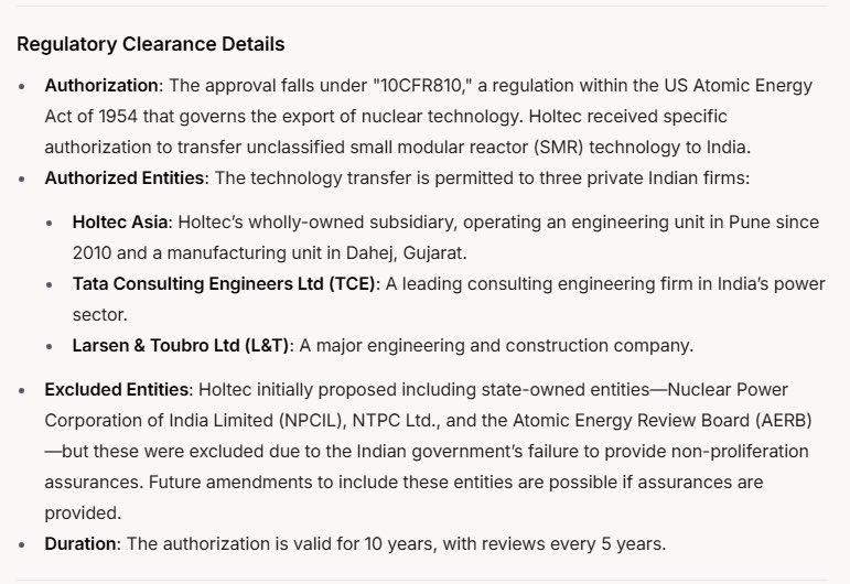

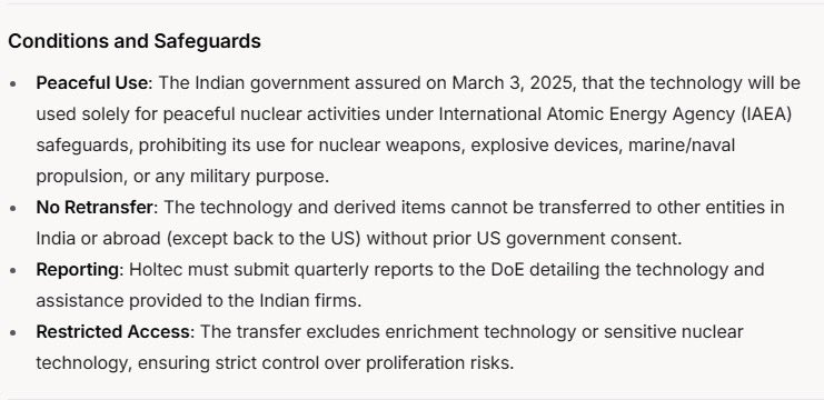

OK, the news is out!
https://timesofindia.indiatimes.com/ind ... 826549.cms
Holtec (US SMR company promoted by KP Singh) has received DOE approval to manufacture SMRs in Bharat in collaboration with L&T and Tata.
https://holtecinternational.com/product ... vices/smr/
It sure looks like Indian negotiators have driven a strong bargain instead of just approving imports.
Also Bharat has allocated $2.5bn this year for 3 types of indigenous SMR, including the BSMR-200 designed for captive power applications.

For the record and reference - posting here:
This authorisation permits Holtec, with conditions, to transfer unclassified small modular reactor (SMR) technology” to three firms in India: its regional subsidiary Holtec Asia; Tata Consulting Engineers Ltd; and Larsen & Toubro Ltd.
Posts: 6803
Re: India Nuclear News and Discussion 4 July 2011
What does this prove Amber Ji? That Holtech has a working SMR?

Posting a couple of features that will help immensely and explains why this type of reactor is being considered. They don't mention proliferation concerns, but if those are handled, most towns should be able to host one or more of these reactors.
USG Authorizes Holtec International Under 10CFR810
our SMR-300™ checks every box relevant to India’s needs and circumstances, such as a standardized design that is seismically competent to be deployed anywhere in India, one that requires only 25 acres (and no exclusion zone!) of land to house two reactors (600 MWe power output), one that can be operated using air (in lieu of water) as the “waste heat sink” in a water-challenged region
