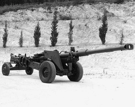

The soltam m-46 155mm upgrade also has a single baffle muzzle brake, both the soltam upgrade and OFB Sharang are almost identical and if I am right the OFB Sharang is updated with additional features
This is a Israeli 155mm M-46

Yes, the earlier Soltam upgrade and Sarang indeed look the same.
I heard this version of events from Kunal Biswas DFI in 2010.
Soltam barrel tech was reportedly very bad, but OFB got valuable breech know how, during the ToT, which they adapted for Dhanush.
( Dhanush= Bofors 45 cal.Barrel + Soltam breech knowhow + local jugaad from Army EME for Breech ring).
The Army calls the above 3 parts assembly as "ordanance", and it's the key to build a local gun/ most critical part.
The carriage, elevating mechanism and trunions, cradle, etc are easier to build locally.
The Soltam upgunned 155 mm had frequent barrel bursts, so no repeat order given to Soltam after the initial 180 kits.
The OFB fixed the Soltam barrel problem using Bofors barrel tech, at the Army' s request.
The Sarang looks the same, but has superior barrel.
The army had competitive trials with Soltam, Punj Lloyd's Yugo import and OFB Sarang, and decided that OFB offered the best solution.
