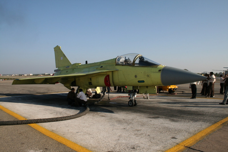

Build quality doesn’t look so good here. Check out the yellow stuff sticking out from under the under-wing panel.
surface finish is only 10% of build quality. learn!
Khan, you have it wrong. That's likely the primer showing through at parts where the paint has worn off due to moving surfaces, i.e. the leading edge flaps.
http://1.bp.blogspot.com/-FjxNI6ucEYg/U ... 0430-L.jpg
If you see operational aircraft used heavily, everything starts looking old in crevices and corners, with moving parts as paint is stripped off. These will remain untouched unless there is an operational reason to remove the part & repaint (will otherwise occur in mandatory overhaul) or if the environment is heavily corrosive (naval aviation).
The build quality relates to the overall fit and finish of the aircraft in terms of fit & finish, quality of integration, of which we can only get a rough idea from pics. But so far the panels and other structures fit together far better than those on some of our MiGs. This does affect drag. Also, no complaints yet from the 45 squadron guys. This is a big deal and NFTC requires a big vote of thanks for that, by ensuring standards were maintained viz design.
khan
Posts: 830
Joined: 12 Feb 2003 12:31
Location: Tx
Post by khan »
Karan M wrote:Khan, you have it wrong. That's likely the primer showing through at parts where the paint has worn off due to moving surfaces, i.e. the leading edge flaps.

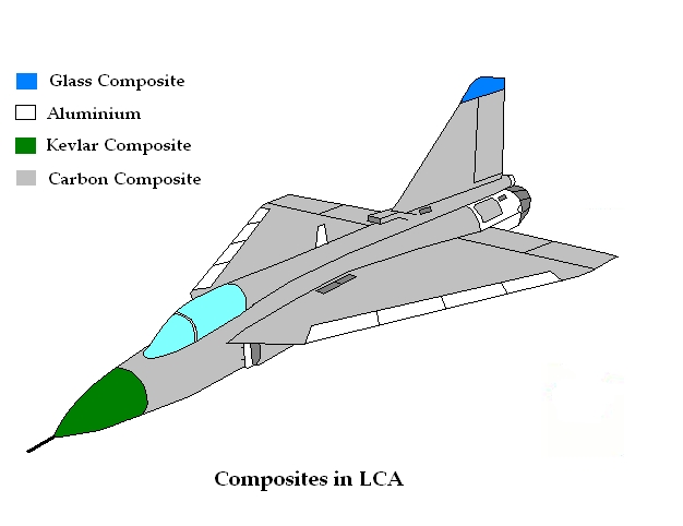

Ok. Thanks for clarifying. Just wanted to add that I do have some background with composites in a marine environment (fiberglass, Kevlar, carbon fibre with different types of resins - epoxy/polyester/vinelester). In a marine environment, having this type of over-coat loss is a big problem since these coats aren’t just cosmetic, but they protect from water intrusion and keep the various layers of composites from delaminating.
The standards & techniques might be different for aircraft - but from what little I know, that panel looks distressed.
Yes, in a naval environment any corrosion can be a huge issue.
That is not a distressed composite panel however, (any distressed panel of any sort, the regular maintenance inspections would pick it up and fix it).
Its just the moving aluminum leading edge flap, which due to friction has worn out its paint, and hence the yellow primer is peeking through.
khan
Posts: 830
Location: Tx
Post by khan »
Karan M wrote:Yes, in a naval environment any corrosion can be a huge issue.
Thank you once again. It is very impressive how much of the LCA surface area is composite.
It would surprise me if it has a bigger RCS than the MiG-21.
It probably doesn't. Repeated references exist from ADA and even some IAF guys testing, that the composites and general size of the bird, will both contribute to a low RCS. Combine that with a jammer and I won't be surprised if this aircraft is very hard for most PAF & PRC aircraft to handle.
