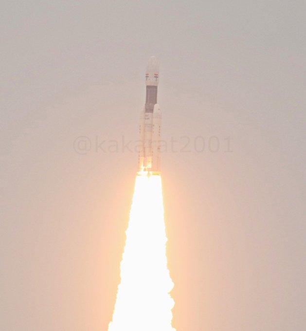

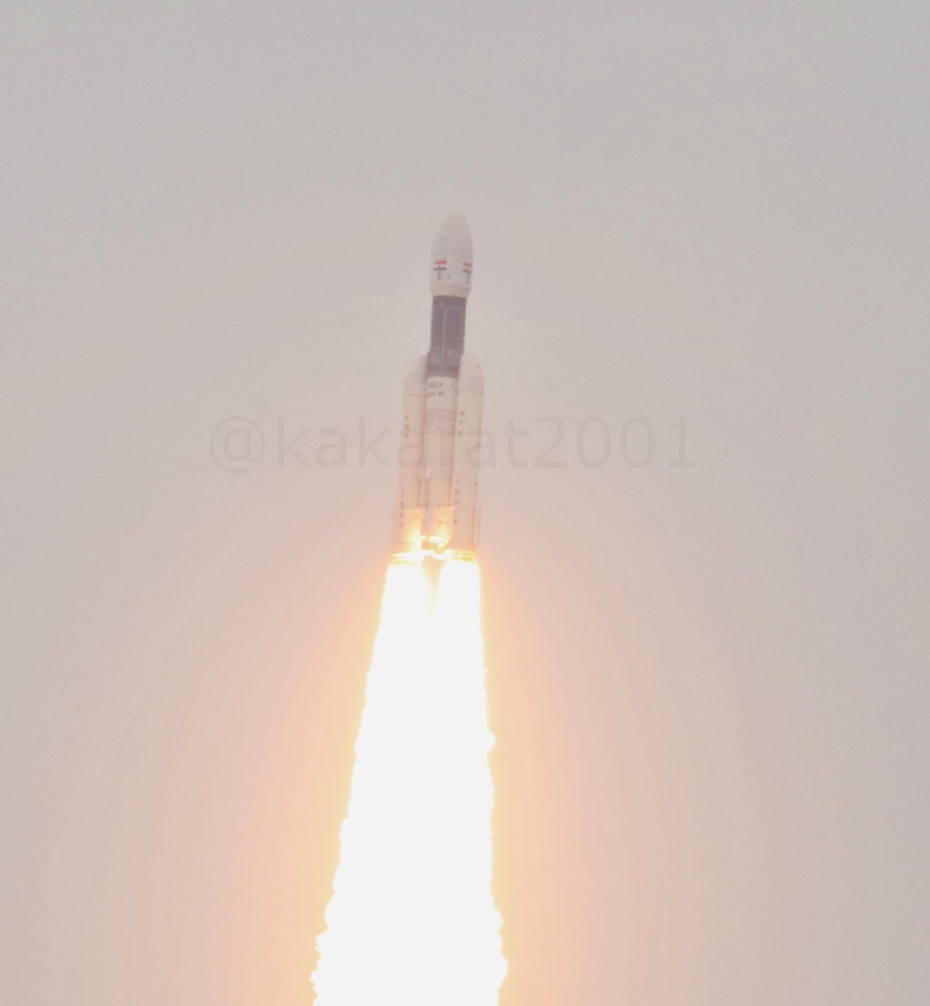

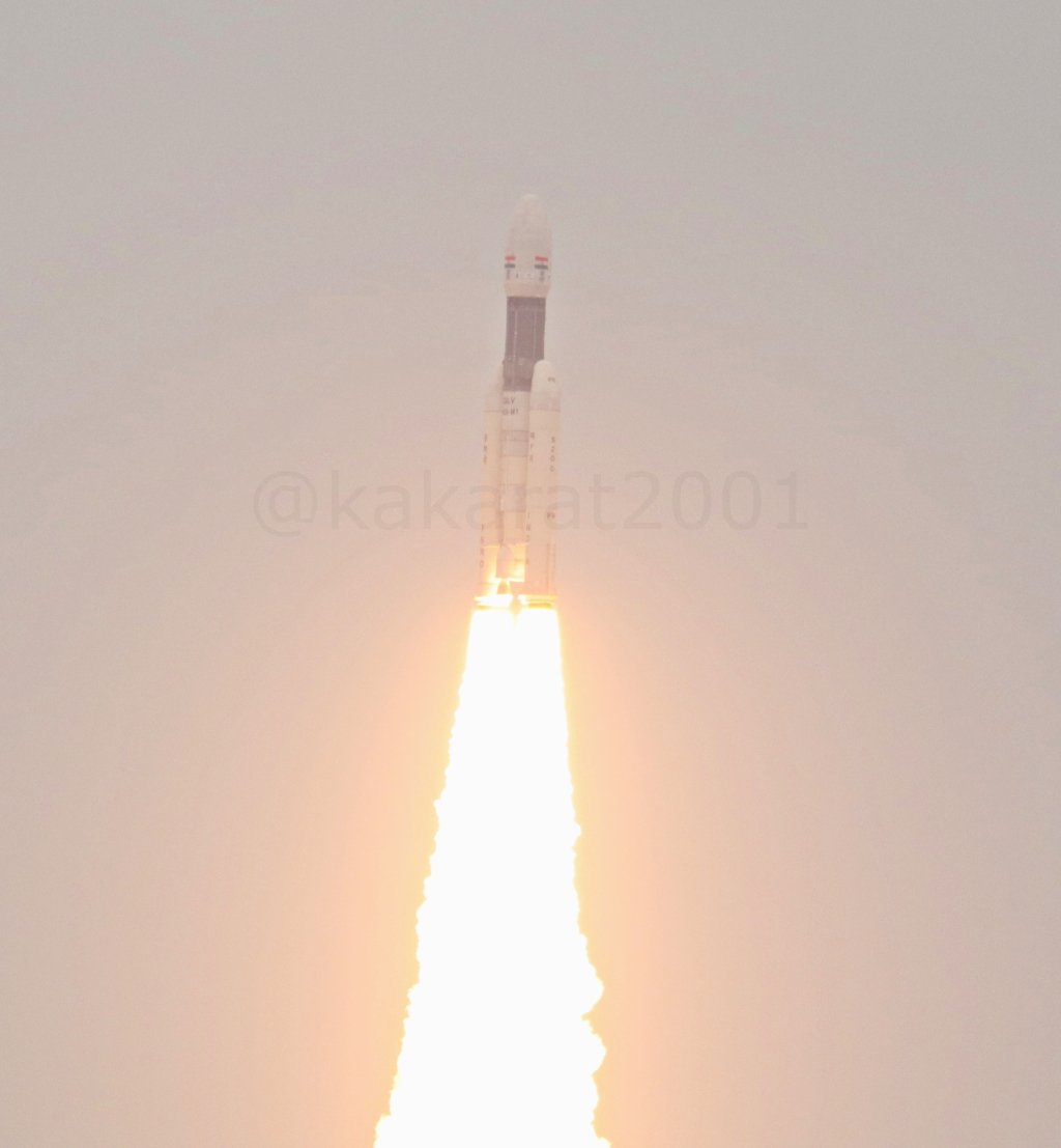

GSLV MKIII M1 in flight as seen from Launch Viewing Gallery at Satish Dhawan Space Centre SHAR, Sriharikota
