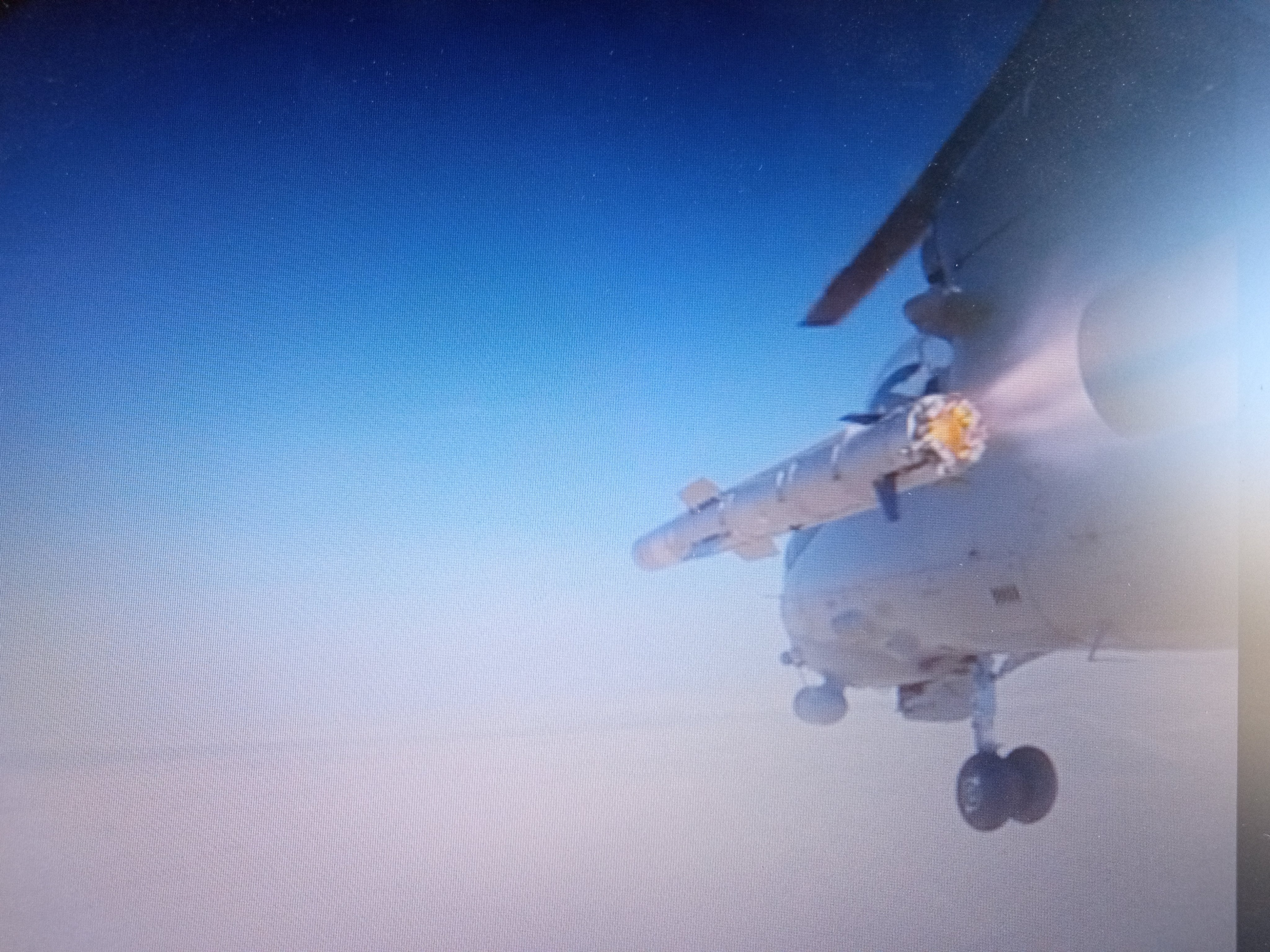

At first glance it appears like it missed the bullseye
Its a MMR seeker the poster is not the target but the small triangle metal reflector in front of it and the missile flies very close to it
Looking at the Sant, suprised it is was tested from what looks like a Mi35, a platform which like the Apache which will be used in very limited nos, compared to ALH and LCH.

The MI35 is a big bad boy. Originally it supposedly carried reloads for its missiles so that it can rearm quickly near the battlefield. I guess the same cargo capability comes in handy during such tests to carry calibration equipment, backup rounds for the test missile, fitters, a couple of drdo scientsts, picnic basket, tent, chairs and tables...in case one test fails and they need to have another followon test without rtb. Doubt whether the Apaches or ALH can do that!Aditya_V wrote:Looking at the Sant, suprised it is was tested from what looks like a Mi35, a platform which like the Apache which will be used in very limited nos, compared to ALH and LCH.
All the platforms likely to use Helina and SANT have been used in trials - Rudra, LCH, Mi35.

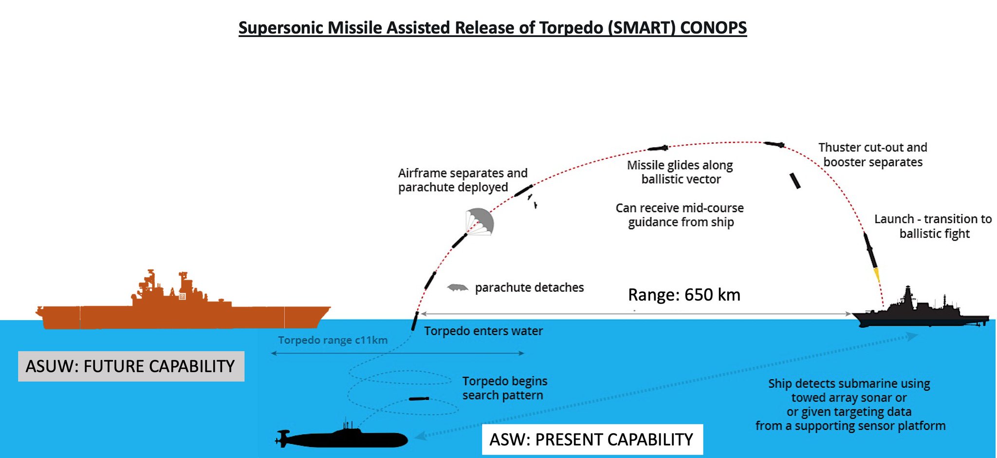

Can this be fired from Ships too, can it fit in Brahmos launchers? If Aircraft, Helos or remote Sonobuoys can detect the sub and ship launches this from a stand off range. will be more useful than coastal batteries targeting subs.Chinmay wrote:Supersonic Missile Assisted Torpedo tested
And I presume the way it works is, as the Missile is closing to the water, a parachute or parachutes will slow the Lightweight Torpedo(shyena) till its hits the water, and then the Torpedo will be able engage the enemy Submarine to about 4-5KM and maximum depth of about 540 meters.

Its a first of its kind missile in the world and am positive that the IN will embrace it. Interestingly, the distance from Nicobar to Malacca straits is less than 700 Km, while the range of SMART is 750 Km.
Regarding ships, I hope we come up with a UVLS that accommodates Brahmos, Nirbhay, SMART & possibly Shaurya/K-15. We should be able to drop these in as per mission requirement into our surface combatants.

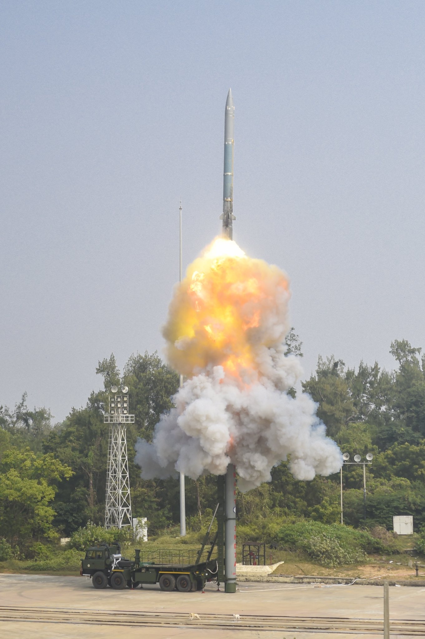

Several details in this India Today report:
1) Tested to full range
2) 2 stage solid rocket
3) Canisterized road-mobile
4) Accurate INS
If a sub is positively ID'ed during hostilities, a salvo of even 3 SMARTs can be launched to have a very high kill-probability. The sub wouldn't know what hit it till its sonar picks up 3 pings splashing in the water above
The 1st test validated the concept including housing the payload, release mechanism, parachute deployment etc.
Hope a future variant (if its not there already) allows for mid-course guidance via satellites because the sub might have moved a few hundred meters between launch and impact. A similar mechanism must already be present because the launch signal must be communicated from the sensor platform via satellite to the launch platform

I'm still unsure about how this weapon will be deployed.
1) How will it discriminate between Indian, hostile, and non-Indian friendly or neutral subs operating in an area?
2) A P8 or MH60 acting as sensors can deploy its own weapons to kill target. So why would you send coordinates for a kill from such a standoff platform?
3) Such a long range kill chain will need extensive validation to prevent any accidental non-hostile targeting (fishing boats, container ships, aircraft(?))

Most probable use case is to complement ship borne ASW helos. MH60R will at most carry 2 torpedoes and ALH class 1.Chinmay wrote:I'm still unsure about how this weapon will be deployed.

Another use case is to be the shooter for maritime patrol UAVs which act as sensor and relay node.
While there are wishes for this to be ship borne in a UVLS. I also hope the UVLS gets ported to the naval MCMB. So the target determines the round - Brahmos for ship or SMART for sub. Makes shore based defense stronger and frees up frigates & corvettes for more hunter-killer operations.
On the topic of sensors for chain before calling in SMART, I hope we have plans for a variety of long endurance UUVs. They can stationary buoy type to mini subs that can lurk in contested waters identifying sub threats. A satellite based network for real time inputs and data fusion should already be underway. Our navy has been quite serious about need of such networks.
A network of small UUVs backed by SMART teeth can drastically ease India's submarine force workload, especially in defensive scenarios, leaving the ample bandwidth for offensive missions.

Not just subs but surface assets. For ex. A ddg equipped with long ranged sams could endanger p8 or mh60 assets if they get too close.Chinmay wrote:I'm still unsure about how this weapon will be deployed.
1. It will be responsibility of sensor to do IFF. SMART will have to be fed sensor data in realtime ( I'll be surprised if thats not the plan)
2. Flying or floating only a sensor will substantially enhance the loiter time. UAV/UUVs with modest sensors can also increase detection capability. Floating sensor boats can have very long endurance.
3. Again sensor will have to do IFF and feed SMART in realtime.

https://twitter.com/ReviewVayu/status/1 ... 09409?s=20 ---> That's SMART!!
The Supersonic missile assisted torpedo system SMART developed by DRDO was successfully tested today and launched from Wheeler Island, Odisha.

So then, the point remains:
Why create a weapon system like SMART for subs alone when targeting ASW assets like p8 could easily engage them with onboard weapons?
Maybe a barrage of these from land based platforms to tackle CBGs?
