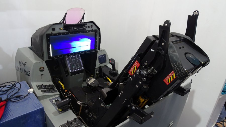

Excellent cockpit..given how good the MMI is supposedly on the Tejas, MWF will be a leap forward. Should be almost similar with the TEDBF/ORCA and help with the AMCA cockpit development as well.

It is very impressive for sure ! I dont understand this space well - but to me incorporating a single LAD is orders of magnitude more difficult. I am not talking about hardware - i am talking about sensor fusion of all kinds of data in a single display. Thinking about it - how would they prioritize data coming from sensors , how would they overlay , what would take precedence , sensor fusion modes for different mission types and other such questions are coming to mind. If we can pull this off in the stated time frame then its very impressive !Kartik wrote:Excellent cockpit..given how good the MMI is supposedly on the Tejas, MWF will be a leap forward. Should be almost similar with the TEDBF/ORCA and help with the AMCA cockpit development as well.
Admiral - is this a working prototype ? As in like LCA sport ? Is there a video ?Rakesh wrote:https://twitter.com/writetake/status/12 ... 14401?s=20 ----> MWF 1:1 mock-up cockpit
I propose blacklist on IDRW links like the haraam forums.Rakesh wrote:We need to stop quoting and linking IDRW on BRF. One way to combat this issue.Indranil wrote:These guys are brazen. They just changed Tarmak's video interview to words and then said, "do not copy"!!!
Single screen but not single display. Its split in 2-4 user configurable sections. Practically like having more than one individual screens, but having LAD offers quite a bit.of flexibility to user plus overall more compact package HW wise. You can not put everything in a single display. Check out the SPORT video for a good demo.naird wrote:It is very impressive for sure ! I dont understand this space well - but to me incorporating a single LAD is orders of magnitude more difficult. I am not talking about hardware - i am talking about sensor fusion of all kinds of data in a single display. Thinking about it - how would they prioritize data coming from sensors , how would they overlay , what would take precedence , sensor fusion modes for different mission types and other such questions are coming to mind. If we can pull this off in the stated time frame then its very impressive !Kartik wrote:Excellent cockpit..given how good the MMI is supposedly on the Tejas, MWF will be a leap forward. Should be almost similar with the TEDBF/ORCA and help with the AMCA cockpit development as well.
Got it ! That makes sense. Thought it was single display. So we are talking about F35, Sport kind of display.JayS wrote:Single screen but not single display. Its split in 2-4 user configurable sections. Practically like having more than one individual screens, but having LAD offers quite a bit.of flexibility to user plus overall more compact package HW wise. You can not put everything in a single display. Check out the SPORT video for a good demo.naird wrote:

I am going to go with what Anantha says in his tweet. Mock Up, not a working prototype.naird wrote:Admiral - is this a working prototype ? As in like LCA sport ? Is there a video ?Rakesh wrote:https://twitter.com/writetake/status/12 ... 14401?s=20 ----> MWF 1:1 mock-up cockpit
Gurus can enlighten more.

The Mk2 cockpit is a mockup. The basic 'optics' is final. Not sure about the HUD though. I don't think they made the deal with Thales.
There are multiple ways to handle LAD. Most of the panels have two independent LCD units etched into a single glass sheet. So, it will be two displays sharing the same glass, and with no pixel gap between them. L3Harris have a patented method of having pixel level redundancy in the panel. As usual, it is not L3 but L1 that wins (pun intended. For tubelights (waitaminit, that is the politician formerly known as pappu. soree onlee) L1 means the entity that offer the lowest price)
Behind the scenes, there are several computers generating the information. Some make video (radar, IRST, moving map etc). Some make symbols. All these go to one (or two if you have two logical LCD units) video processors that will layer all these and create one 'video' that is displayed on the screen. There are a number of high power CPUs, GPUs, several gigabytes of memory and teraflops of processing power that creates the magic.
There can be dozens of such sources supported by the display subsystem for a good sensor fusion. We are en route there onlee.
Its a very very basic 'simulator'. You can takeoff, fly and land but thats it. just for the show i think. the full sim is at blr.Rakesh wrote:I am going to go with what Anantha says in his tweet. Mock Up, not a working prototype.naird wrote: Admiral - is this a working prototype ? As in like LCA sport ? Is there a video ?
I would be sad if it is a Thales HUD. I thought CSIO was developing this.Dileep wrote:The Mk2 cockpit is a mockup. The basic 'optics' is final. Not sure about the HUD though. I don't think they made the deal with Thales.
The current thin hud is imported. But CSIO is working on it. LAD i was told is indian.

The HUD is BAE kit. Probably common with the Hawk program.
Dileep
- Posts: 5892
- Joined: 04 Apr 2005 08:17
- Location: Dera Mahab Ali धरा महाबलिस्याः درا مهاب الي
My bad. What is shown on the mock-up is BAe LiteHUD. CSIO is working on one, but nothing is final as of now.
