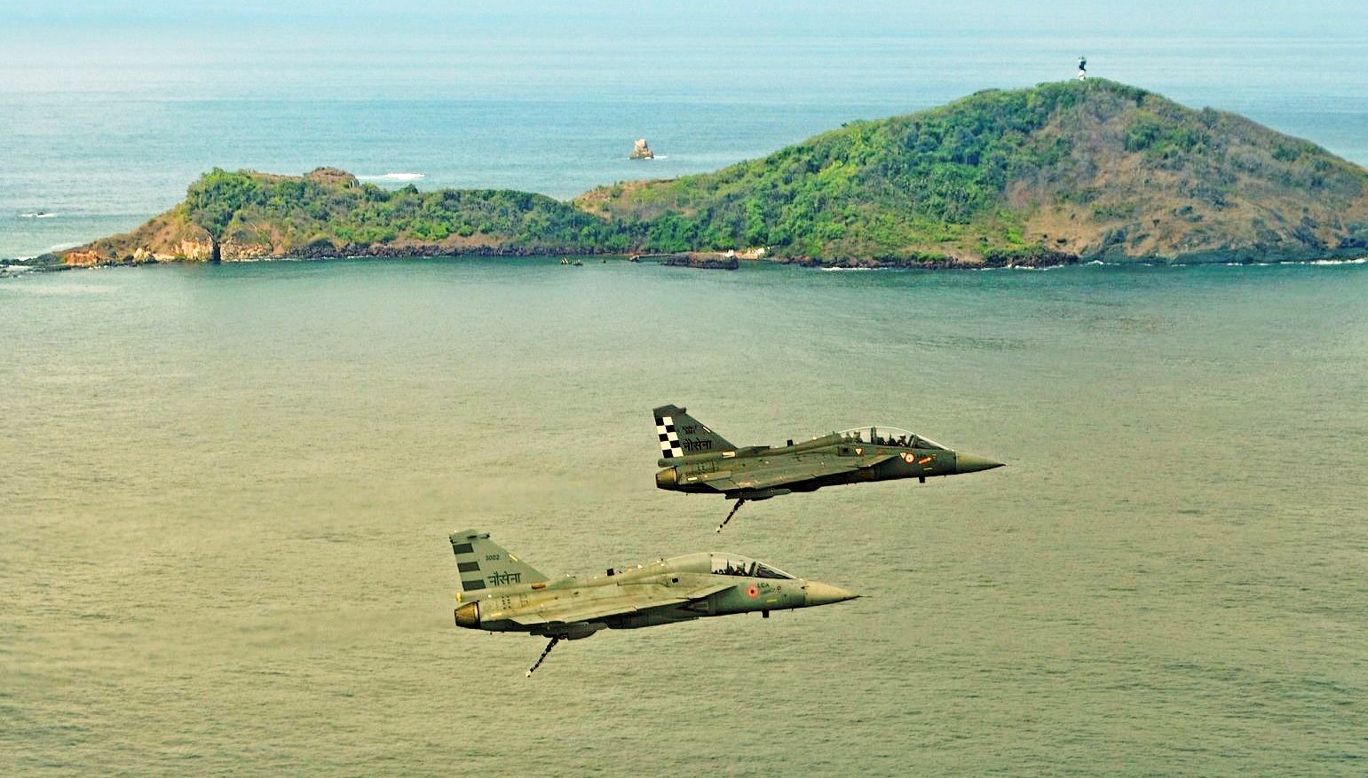

https://twitter.com/lca_tejas_/status/1 ... 97632?s=20 ---> LCA NP-1 & NP-2 flying together.
