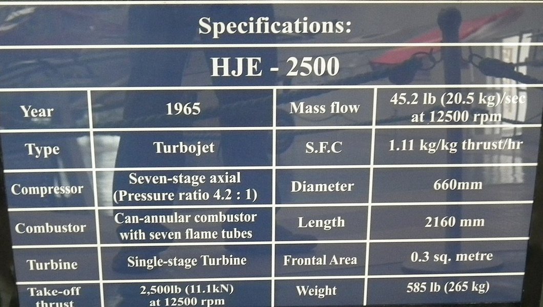

https://twitter.com/FighterPiloting/sta ... tiTV42KcFA ---> Hindustan Jet Engine HJE-2500 was made in 1965 for upgraded Kiran aircraft. The project was shelved on behest of RR, which modified Gnat's Orpheus-70101 engine for Kiran Mk 2. We should have simply continued on indigenous path rather than getting sold out repeatedly.

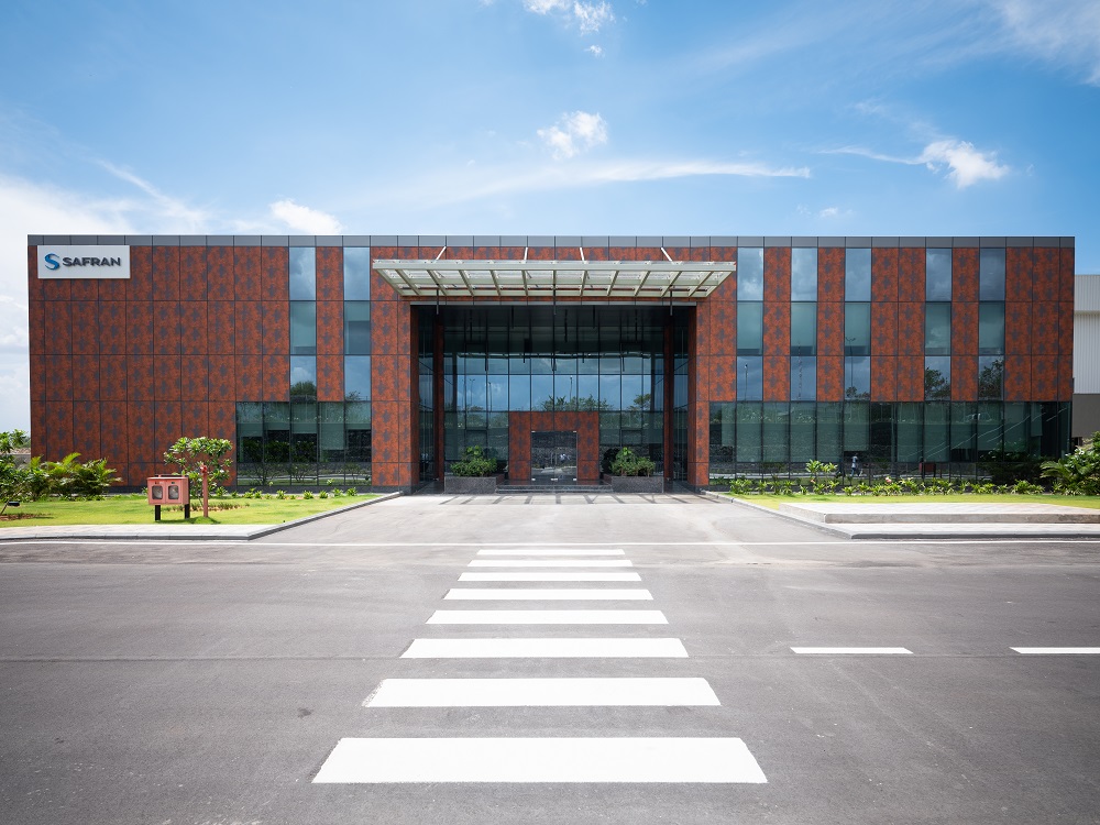

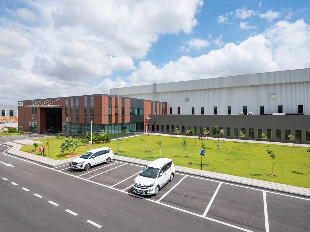

https://twitter.com/ReviewVayu/status/1 ... 8lOhAWRqVg ---> Safran inaugurates its third plant in India in 2 days -- this time at Bangalore for Safran HAL Aircraft Engines, a 50/50 JV between @SafranEngines & @HALHQBLR. New site replaces the initial plant that dates from 2005, more than doubling the area and featuring state-of-the-art installations. It’s located in a Special Economic Zone near the Bangalore airport. Spanning 11,000 square meters (118,800 sq ft), the plant makes complex piping, mostly for the @CFM_engines LEAP engine, and has about 150 employees.
https://twitter.com/SAFRAN/status/15453 ... SLQPM9a_aA ---> Immersion in @SafranEngines new facility in Hyderabad, dedicated to making rotating parts for the #CFMLEAP engine from @CFM_engines!
To provide the additional capacity needed for a production ramp-up for the LEAP #engine.
* 162,000 square feet.
* 250 people.
#MakeInIndia
* 250 people.
#MakeInIndia
