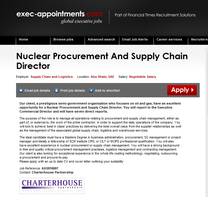

Meanwhile, this one came to my attention... We know who'll be applying right?
