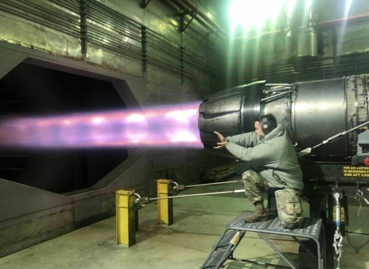

https://twitter.com/JaidevJamwal/status ... 62882?s=20 ---> Real picture of USA transferring jet engine technology to India.
