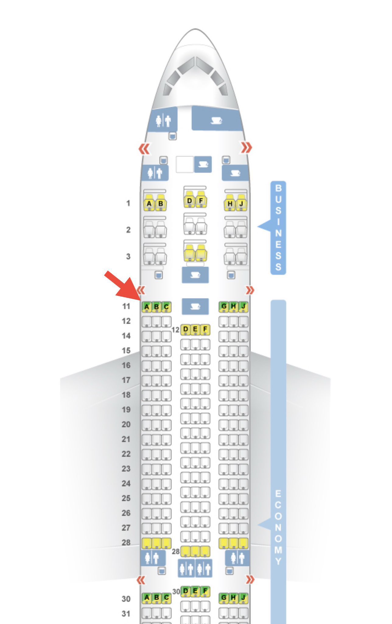

Posted: 13 Jun 2025 10:31
by Amber G.
He was apparently in seat 11A...
