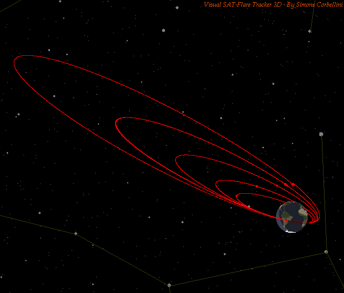

Image[/quote]
It was supposed to be 199k+ kms after the fifth firing. It is now around 192k+ kms. Will it have much of an effect on transferring to the Mars orbit?
Re: Mangalyaan : ISRO's Mars Orbiter Mission
^^^ There are some discrepancies with that chart.
indranilroy wrote:^^^ There are some discrepancies with that chart.
..........................? Waiting.

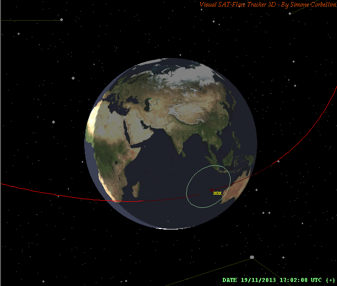

Satellite ID
39370
Velocity (km/s)
1.618
Velocity (mi/s)
1.005
Latitude (°)
19.596
Longitude(°)
70.395
Height (km)
117322.771
Height (mi)
72900.967
it looks like 2/3rd distance from perigee.
