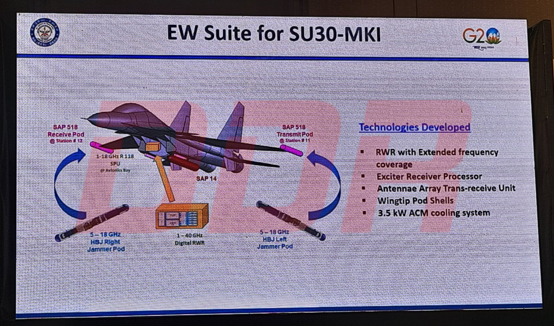

https://twitter.com/delhidefence/status ... S5ukcSoURw ---> Electronic warfare suite under development for IAF's Su-30MKI fleet to replace current Russian SAP-51 pods. Building on the success of the EW programs for Jaguar & MiG-29UPG aircraft.

I am still amazed by the fact that there is no space inside the gigantic Flanker for an internal EW system when the much smaller M2k, Jag and even the Mig-29 UPG now have that capability. And this is not a case of HAL/DRDO being unable to do it since the Russians themselves opted for the wingtip mounted solution.
Also, in the pic above, both the indigenous wingtip pods are marked "jammer" pods presumably linked to the on-board RWR instead of one pod being "receive only" and the other being "transmit only" in the case of the SAP-518. That leads me to question if only one pod would be sufficient leaving the other wingtip free for an R-73.

nachiket wrote:I am still amazed by the fact that there is no space inside the gigantic Flanker for an internal EW system when the much smaller M2k, Jag and even the Mig-29 UPG now have that capability. And this is not a case of HAL/DRDO being unable to do it since the Russians themselves opted for the wingtip mounted solution.

Nachiktji, I think you are mixing up two different aspects.
The so-called internal HBJs in various platforms, that you mentioned above, are not AESA based systems - so they will not have the fidelity of implementing DRFM etc advanced jamming techniques. However there are other std jamming modes that they will be able to implement - and counter-counter measures for these have been developed and implemented in various platforms, as well.
The dead giveaway of an non-AESA system is separate Transmit and receive modules - so to transmit->receive->synthesize->spurious beam forming->transmit again cycles are too time consuming to implement worthwhile DRFM techniques.
And with AESA TR based systems, most of this is instantaneous - and thus with fast processing backend, DRFM techniques can be implemented in them.
(hint: Tracking rage of a AESA based radar system is almost same as that of it's detection range, but that's not so in other PD radar systems)
But with AESA based wideband design the azimuth coverage (if we assume elevation coverage is acceptable) will have to be compromised.
(hint: Again pls look-up azimuth coverage of AESA radars - they seldom cross above +/-40-45deg (while for other PD sets it will be somewhere in +/- 60deg or more))
So there's a need two antennas for a "good" azimuth coverage - and of course, nobody would provide this "good" value etc, as that is, and should be, classified.
Having said all of that, I do agree with you, as to,
a) for twin tail-finned platforms (like Su-30 or Mig-29), why it's so difficult to implement two boxy-humps at the base of the two tail-fins and implement these HBJs.
However do note, with GaAs based AESA based systems, cooling will be an issue, and implementing additional cooling subsystems takes up quite an appreciable volume (so dimensions) and of course, weight. This can be circumvented with GaN based systems though, but I guess, we haven't reached operational-level-maturity for those kind of systems.
b) for single-tailed platforms (Jags, Tejas etc), again a single hump at the base of the tailfin is the way to go - yes it will not be a very wide frontal-and-aft coverage, which I guess should be fine, for a light-series of platform like it.
And this boxy-hump-at-tailfin-base implementational aspect (may not be AESA based though) has been there for eons in F-16 (later versions) - and, I'm nto sure though, the very last versions (Block 70/72 etc ???), may have AESA based DRFM types systems implemented in that very same "tail-fin base hump". See here:Image
Not an expert or anything and maybe gurus like Dilip-chetta et all can throw some more light to this.

maitya wrote: Nachiktji, I think you are mixing up two different aspects.
Saar, unless I'm very much mistaken DRFM jammers have been around for far longer than AESA based jammers. The new internal EW suites created for the Jag an the Mig-29 upgrade, along with the French one included in the Mirage-2000I upgrade are all DRFM based systems. Noise jammers like what equipped the pre-upgrade Mirage-2000H or even the old jamming pods like the Remora went out of fashion ages ago.
AESA jammers provide additional capability like directional multi-beams etc. which you have outlined above.
This has nothing to do with the internal vs podded EW question I was asking.

Re: Su-30MKI: News and Discussion - 24 July 2021
An update of the EW systems being developed for Mk1A & Su-30 MKI
Posts: 9208
^^Thank you so much for that. You answered many of the questions about the MKI's EW system future I had asked above.
