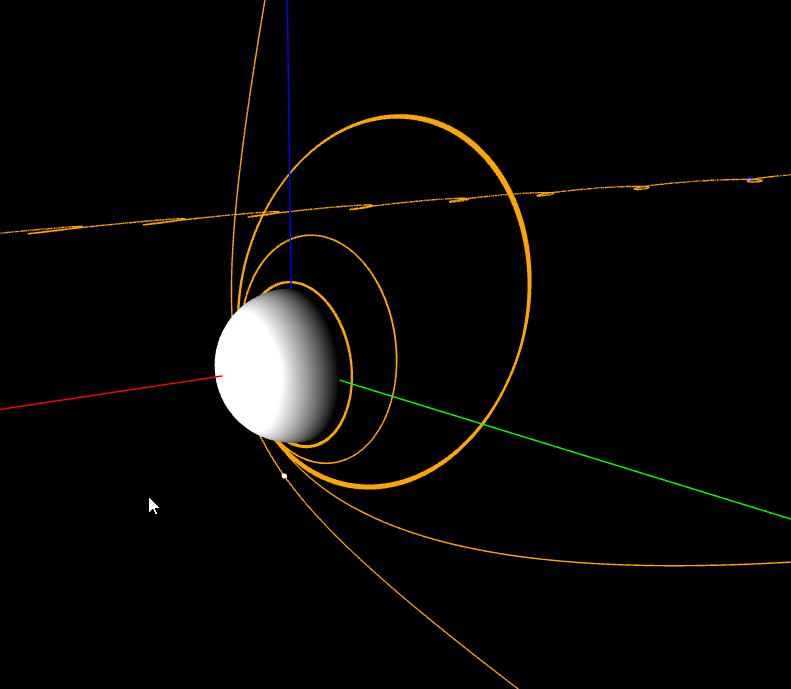

Posting LOI in 3-D.. (HT: Sankara Viswanathan)

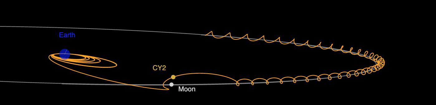

Few comments. For lay people as well as serious ones (with good background in physics/math).
- Juvva is basically correct but let me add and amplify:
1. Like everything in physics, NO orbit is *exactly* elliptical but it is a *very* good approximation and sufficient to *understand* basics. Just like we say earth is a sphere but closer we get (or more details) there are mountains and other irregularities. This does not matter if we are looking from space but can matter a lot if we are climbing the mountain.
2. For most planets, (or moon or sats around earth) we can simplify by not considering complications and treat it as a two body problem. Thus we can say moon goes around an elliptical orbit (nearly circular orbit) around earth. But there are perturbations due to effect of Sun, (and even Jupiter and Venus which are quite noticeable.
3. If we look from earth, the orbit of CY2 looks like figure 1 (figure constructed from actual data). Each part of the "orbit" is ellipse (or nearly an ellipse). After each rocket firing, there is different ellipse.
4. When CY2 reaches moon - before LOI, - ignoring moon - the path is such that perigee is where TLI was rocket was fired and apogee is pretty close to moon.
5. After moon's "disturbance"+ LOI rocket - the orbit changes to near circular orbit virtually identical to moon.
(Or course all those ellipses have little "ripples/perturbations/variation" from true ellipse)
Figure 1:
Hope this helps.

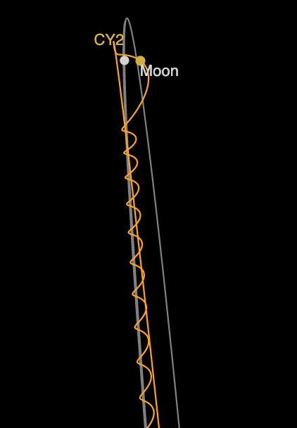

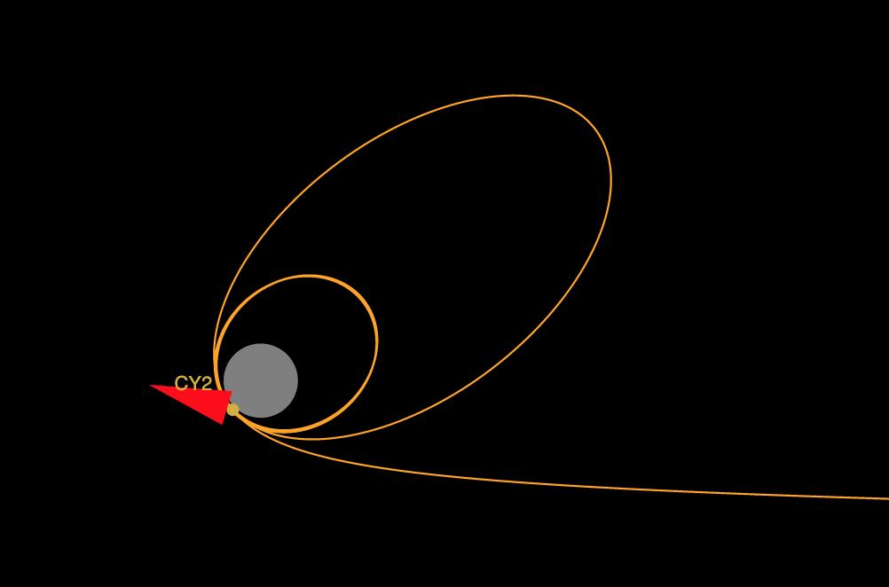

If you are looking from the Moon.
(See figure 2 - Sorry, the data for last 3 rocket firings are not available for this picture.. so posting a picture but *not* zooming in for the "orbits" around moon.. so they look like a point only) (You have to imagine that at the end point CY2 is going into elliptical orbit around the moon).
- CY2 looks like a sat orbiting earth (closely at first and then "escaping" and reaching towards moon.
- It is approaching the moon in nearly hyperbolic orbit.
- Near perigee (closest approach to moon) LOI starts.
- The nearly hyperbolic orbit becomes elliptical orbit with very large e.
- After a few more rocket firings - the orbit becomes more circular ending in a circular orbit. (about 100 Km)
- Vikram separates and assumes a elliptical orbit (perigee 30 km or so)
- Vikram soft lands etc..
Figure 2.
***Added later: I zoomed on the CY2 orbit from Moon's perspective. (I am using a plane where north pole of the moon is pointing upwards. In previous picture, north pole of the moon is coming towards you - perpendicular to the plane of the computer screen)
From this point of view - CY2 is approaching from right -( almost a straight line, but it is a part of ellipse in X-Y plane -- I am showing Y-Z plane). After the first burn, the orbit now is ellipse, it changes inclination.. almost polar wrt to moon now.. and the orbit is less elliptical after the second burn.
If you are looking from Sun:
Nothing much happens - small ripples - everything within few hundred thousand Km over the elliptical orbit of earth (about 150 million Km).

Added this to my previous message:
Added later: I zoomed on the CY2 orbit from Moon's perspective. (I am using a plane where north pole of the moon is pointing upwards.)

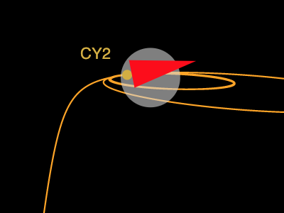

Posts: 12975
Re: Chandrayan-2 Mission
SriKumar wrote:In looking at the orbits, it seems like getting into a lunar orbit is more challenging task than getting grabbed by Martian gravity into a Martian orbit (the distance and time delay notwithstanding). Per my memory, the orbit of Mangalyaan did not involve the sharp turns seen above with chandrayaan just prior to getting captured in a circumlunar orbit. CY after goes in moon's circum-earth path for a little bit, and does a double-curve into a circum-lunar orbit. Mangalyaan's was much more like a single smooth elliptical curve with no sharp turns. Same for Maven that went into a polar martian orbit. Myaan was traveling at 31 km/sec i.e. faster than Mars at 24 km/sec and came from behind tangential to Mars' orbit around sun, braked and entered martian orbit. Orbit seemed less complex than the gyrations cyaan had to go through.
CY2's TLI was much more challenging but this is for a different reason.. (See note ***).
If one was entering *any* ordinary orbit (eg CY1 ) it will not be that challenging. Mangalyaan would be more challenging as delta-V needed (and V itself) would be larger. Moon has less mass and in general getting into its orbit *much* simpler than Mars. (Remember going to Mars and achieving the orbit in the first attempt was a *BIG* deal while for moon Luna-1 went in around 1966)
Note *** What makes CY2 TLI (and other adjustments for the orbit) challenging is that one is setting up Vikram to land at one particular place on the moon (that too near south pole) at one particular time (local morning). TLI achieved a lot of change in inclination (to get to Lunar polar orbit).. MUCH more complex task in the sense that calculations were about 100x time more challenging. ..
Too see this, let me post the TLI delta-V in XY plane (orbit of moon) and YZ and ZX Plane. (As BRF does not allow a hologram or three dim picture-- this is the best I can do :)) .. This gives some idea of the challenges CY2 has to transfer the orbit to a polar orbit.
XY plane (orbit of moon's plane):
YZ plane projection:
ZX plane projection:

AmberG, Thanks for the explanation .
Its the corkscrew path to get there.
That accounts for the minor 1km variation in orbits achieved.
S^3 In such planetary travel/orbits 1km off is important no?

Ramana - to add, "corkscrew" part is obviously looking from earth's frame of reference. Here moon is is orbit and CY2 is going around the moon. So the orbit looks like "corkscrew".
Thing I was trying to show is the orbit around the moon is polar. The poles of the moon are tilted about 5 degrees to perpendicular to XY-plane. This is why one sees that the elliptical orbit is is not in the same plane as moon's orbit.
Looking from the moon, the orbits are regular elliptical orbits. These are polar orbits. Again looking through XY, YZ, ZX plane projection to view 3-D part:
Looking from moon - (Red triangle - part is when TLI firing was done)
In XY plane:
In YZ plane:
In Zx plane:
